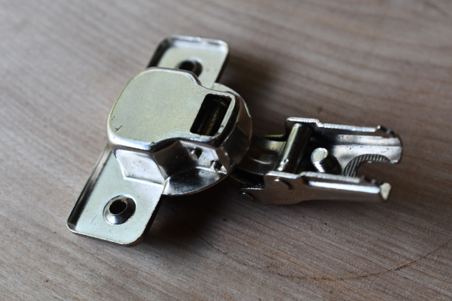

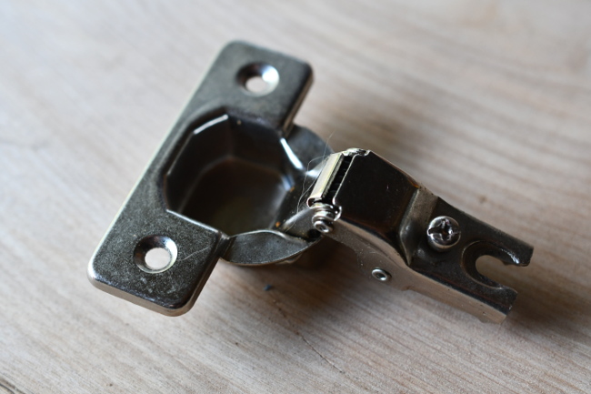

Weight of the doors. For anyone contemplating making your own, do NOT use HD's "Euro-style" hidden hinges. They've failed over time and caused no end of misery here. Doors sagging, misalignment and chipped laminate as a result. I'll have to remake most of the cabinet doors to use more "commercial grade" hinges now. Disheartening, to say the least. And counter tops... DuPont will not sell Corian to just anyone, you have to be a "Certified Installer". I got the Chinese knockoff "Korlan" instead. Works the same, cost is about half. No complaints, didn't fancy trying to work with quartz!

That is interesting about the HD doors, The Ikea hinges are (for the kitchens at least euro kitchens) are made by Blum which is good stuff. Not sure if they are identical other than the name on them, but certainly different than the hinges I have seen on other Ikea stuff.
The doors I made from MDF, it was the hinges from HD. No identification anyplace on 'em, likely Chinese. They've fatigued at the pivot points and at (apparently potmetal) anchor points:
