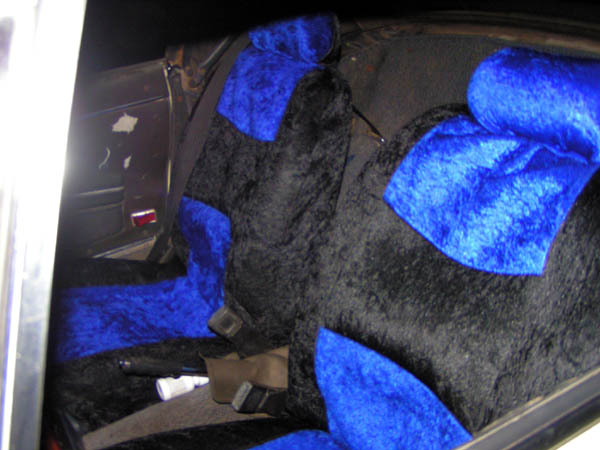

Actually the car just got P!ssed that I put these seatcovers on it today...
Dang'ed easily upset Italians - don't he know they look better than the torn missing leather? Well, not that much better, but jeez. /ubbthreads/images/graemlins/rolleyes.gif

A bit "flash" with the electric blue insets, don't ya think?

Trust me they were cheap (under $25) and the color looked alot darker on the box. I was actually a little disappointed in the brightness of color when I opened them. But they look better than yellow foam and I won't destroy the foams (which are actually reuseable so far).

Oh, and I've been bonding hard with it the past couple a weeks. So far he likes the battery booster I use to raise and lower the driver's window, Doesn't like the new seatcovers, want's me to clean his heater fan, and likes to srpay the interior when it rains (he wants me to install that new top sitting under the couch).

Aarrrggghh My Eyes!!!!
those might just be ugly seat covers... but those sure are some ugly seat covers. /ubbthreads/images/graemlins/smile.gif
But you know what?
for 25 bucks I'd use 'em too.
