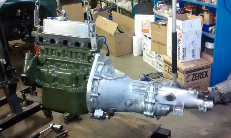

Phase 1:

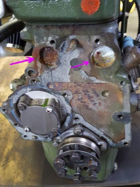

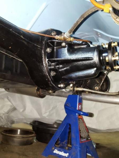

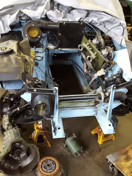

Engine and tranny out. After removing the 1275's back plate (to be replaced with the Datsun adapter plate), we discovered that one of the coolant system blanking ("core" or Welsh) plugs were seeping (though contained by the gasket)... so both of those will be replaced before proceeding. Also, in getting ready to replace the diff, one drum showed some oil leakage (so that will be resolved too). No real surprises yet.
