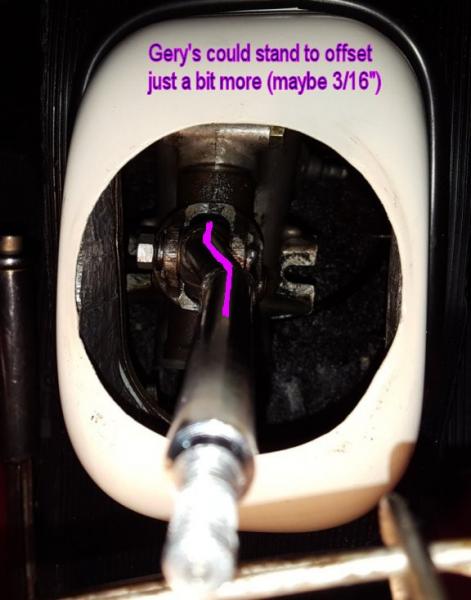

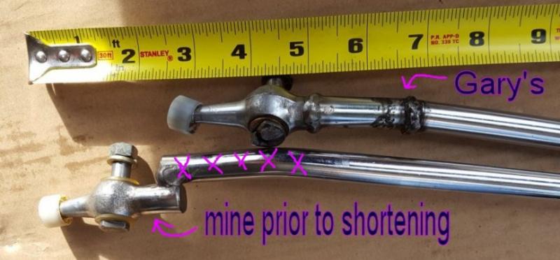

OK, because this can be confusing, here are two more shots.
1) my original shifter (for a Morris Minor) prior to cutting the weld, shortening and re-welding. Gary's is above it with a different off-set welding.
2) Gary's shifter in-situ... showing his offset which could stand to be just a bit more.
My "new" one is fully offset by the width of the shaft or base.

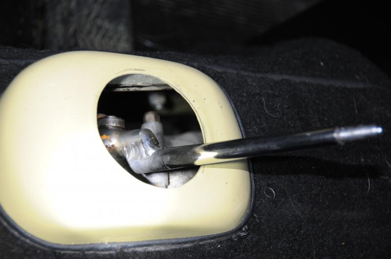

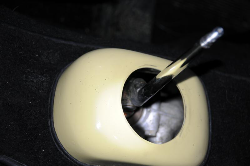

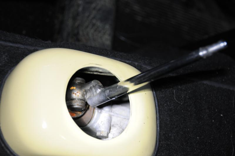

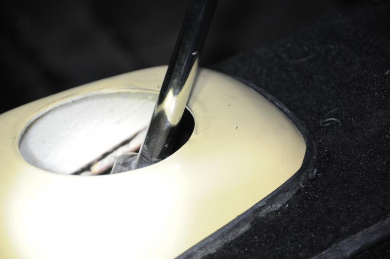

Mark: here's a series of photos that will hopefully help: the shift lever (in order of the photos) is in 1st; then 3rd, then 5th, then 5th again (different angle to show clearance).
The shots I took of reverse are too blurry to add. The shifter (if memory serves) was modified by Rivergate.
Clearances to the cupola are one full finger/thumb width for 1st, 2nd, and reverse, and about a 1/4" for fifth. The stock rubber gaiter fits very well and does not interfere with the shifting.
Jeff cut the hole in the cupola to match the stock BE can, in both location and diameter. The first photo is in first; the second in second; the third photo shows the shifter in fifth as does the fourth photo (showing that 0.25 inch clearance).
