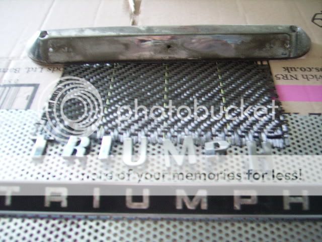

Badge/ Chome housing mix.

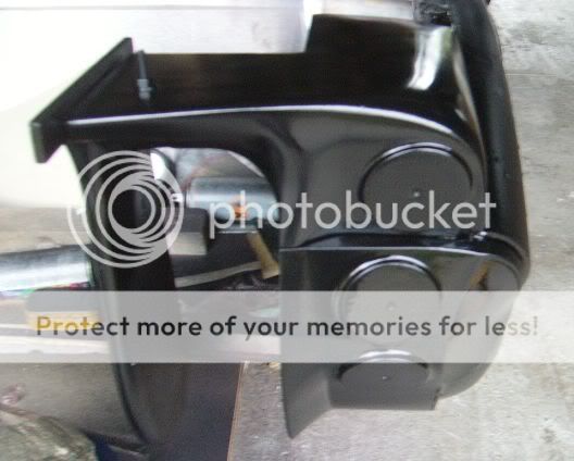

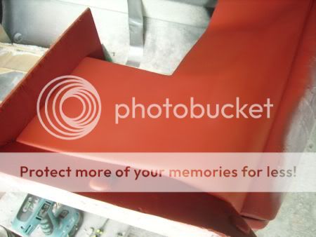

Replacement top dash.

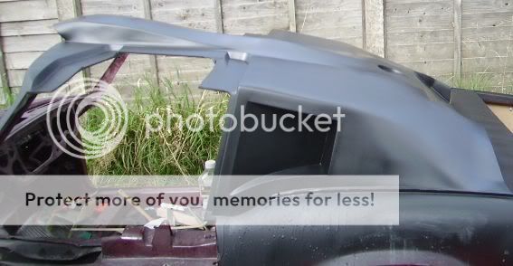

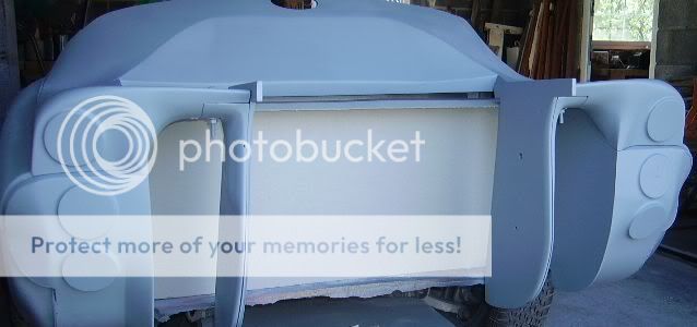

With the roof plug rear adjustments, I think the lines are better.
Rear side plugs are blended in to rear of new line of roof.
Due to some awkward spanner head wanting the shape to go under.......Multi mold time.
The key piece, I reckon is the top area, so, have to section off, as I did with roof mold, and going to start there.

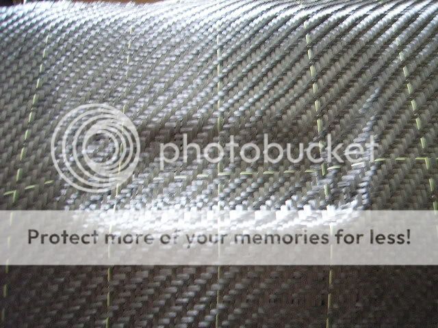

After these molds are taken, its time to strip all paint, chassis/shell, seam weld chassis, lay up Carbon Fiber, get everything in primer etc, etc.
Have to re set up mold for bonnet.
(Clear plastic tube, and red wine, make great level.....:smile:
Hoping to see the Scarlet lady, in Ali Babas new Temple robes, maybe relatively soon.....
oh, and CF switch panel, one layer.
Lifes good.

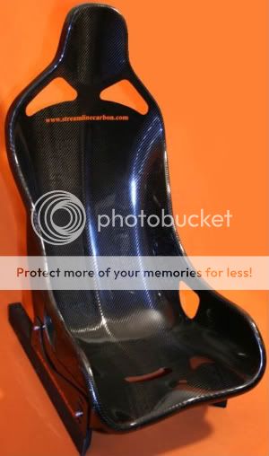

Looking at various seats, the strengthening shaping at rear looks similar in a whole range.
I'd like to go somewhere and chuck one round for a while.
The two that have caught my eye are these:
