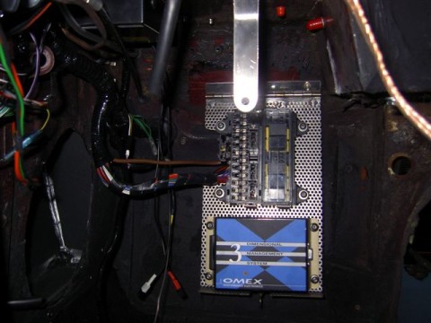

Spitfire 2.5 spitfire.
does anybody have any views or experiences with omex programmable ignition?any feedback gratefully recieved. /ubbthreads/images/graemlins/cheers.gif

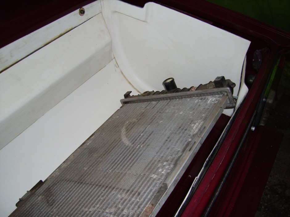

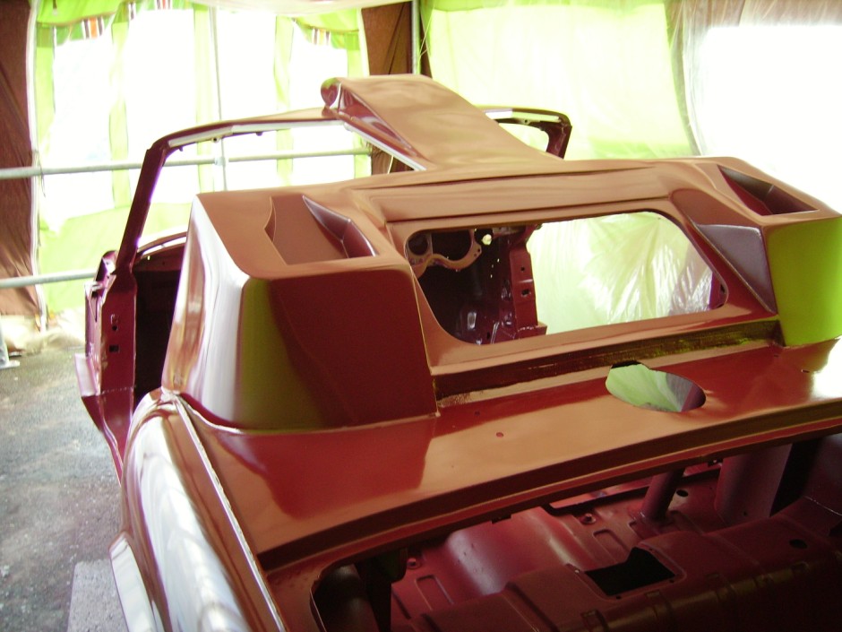

great to have some colour on the spitfire. damask red,with on a scale of 0-10, 7 of black.time to re-fit some "bits"!have added some aluminium floorplates,as i don't use carpets etc.the engine will be incorparating tld's cam,billet crank,carrilo con-rods,lightened flywheel(metal),forged pistons,arp fastners,roller rockers,1.65-1,phos' coated cam followers,more than likely smith bros pushrods,titanium upper valve spring seats,zero deck,10.5-1comp head,ported and flowed by tld.have'nt decided about oil pump,or dry sump system yet.and the exhaust will be either 6-3-1-2 custom stainless,or manifold from tld,custom made back pipe,back boxes.electric water pump,and aux rear radiator.oh yes hopefully vandervell bearings,engine shop say they can get them. any thoughts gratefully recieved.

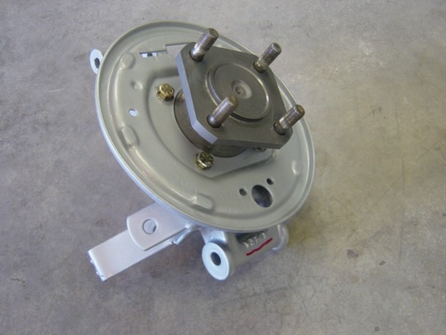

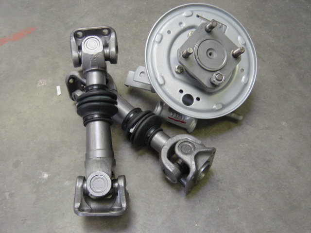

steve smith has finished special rear driveshafts,truely awesome.excellant engineering,quality parts,and well thought out conversion. /ubbthreads/images/graemlins/lol.gif
/ubbthreads/images/graemlins/cheers.gif steve!
