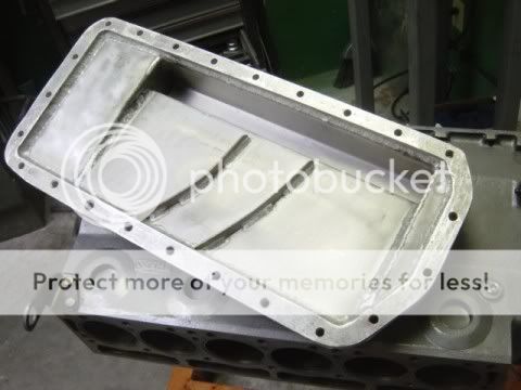

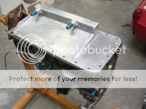

dry sump system, three stage,+ pan , (excellently designed & developed by GT6steve)
oil gallery direct feeds.(innovative system by kas kastner & jimmy coan)

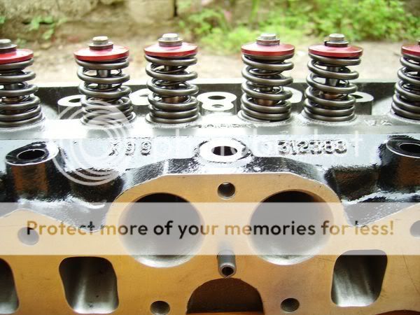

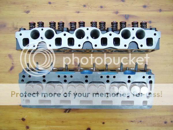

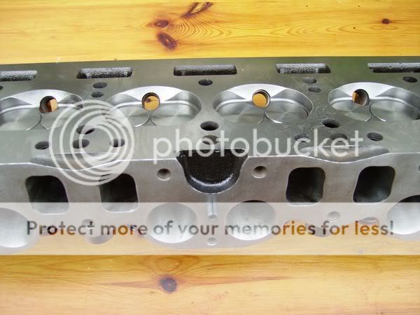

tld's ported & flowed head.smoothed for oil flow.
comes with:
phosphated followers.
bronze valve guides.
competion valves + springs.
titanium valve spring caps.
hardened pushrods. smith brothers
1.5' or 1.6' roller rockers. harland sharp.(solid bushings)

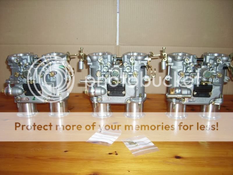

triple 45 dellortos "p's"

Man I want that head!!
If i were you I'd sleep with that under your pillow!!
