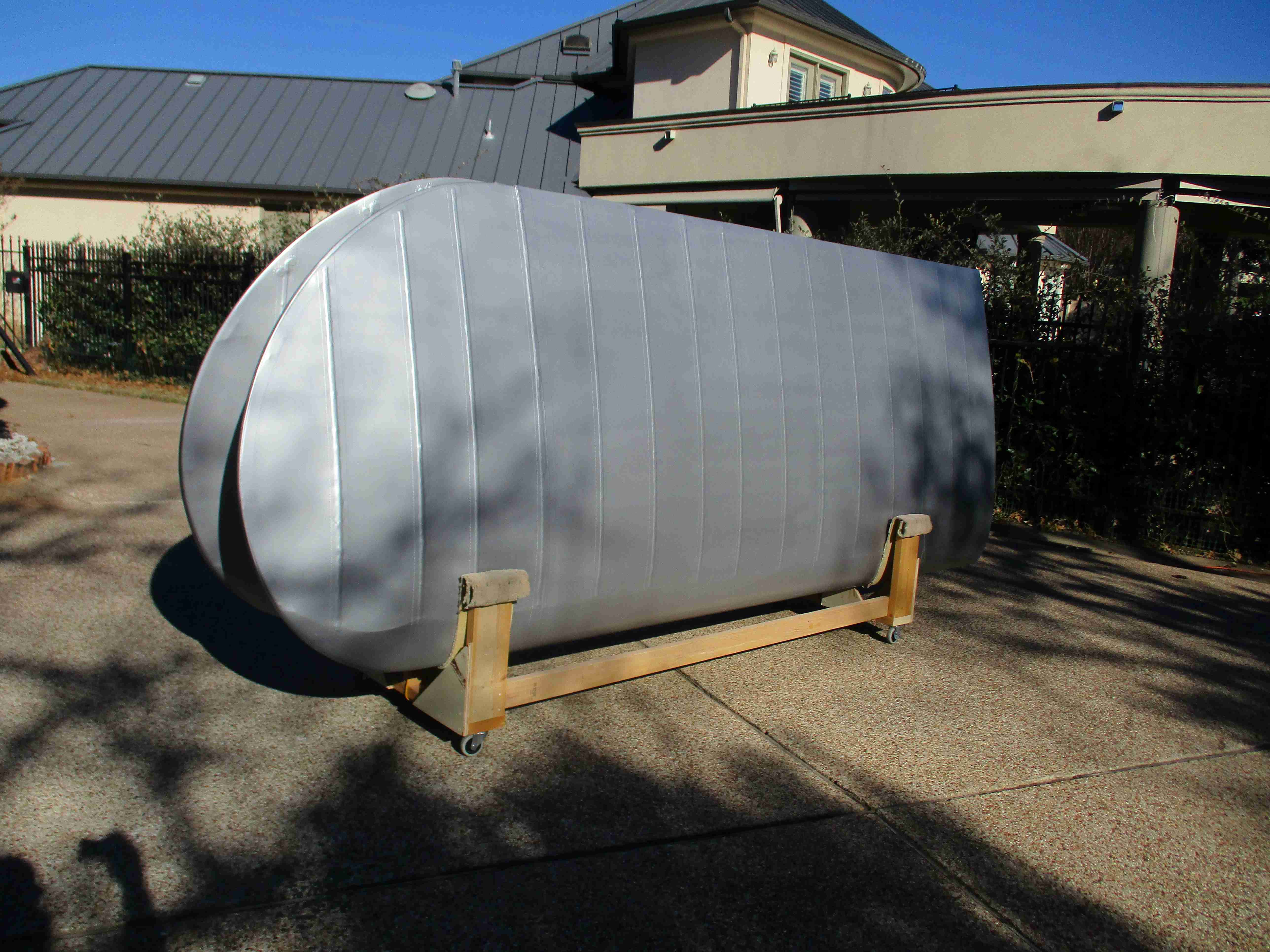

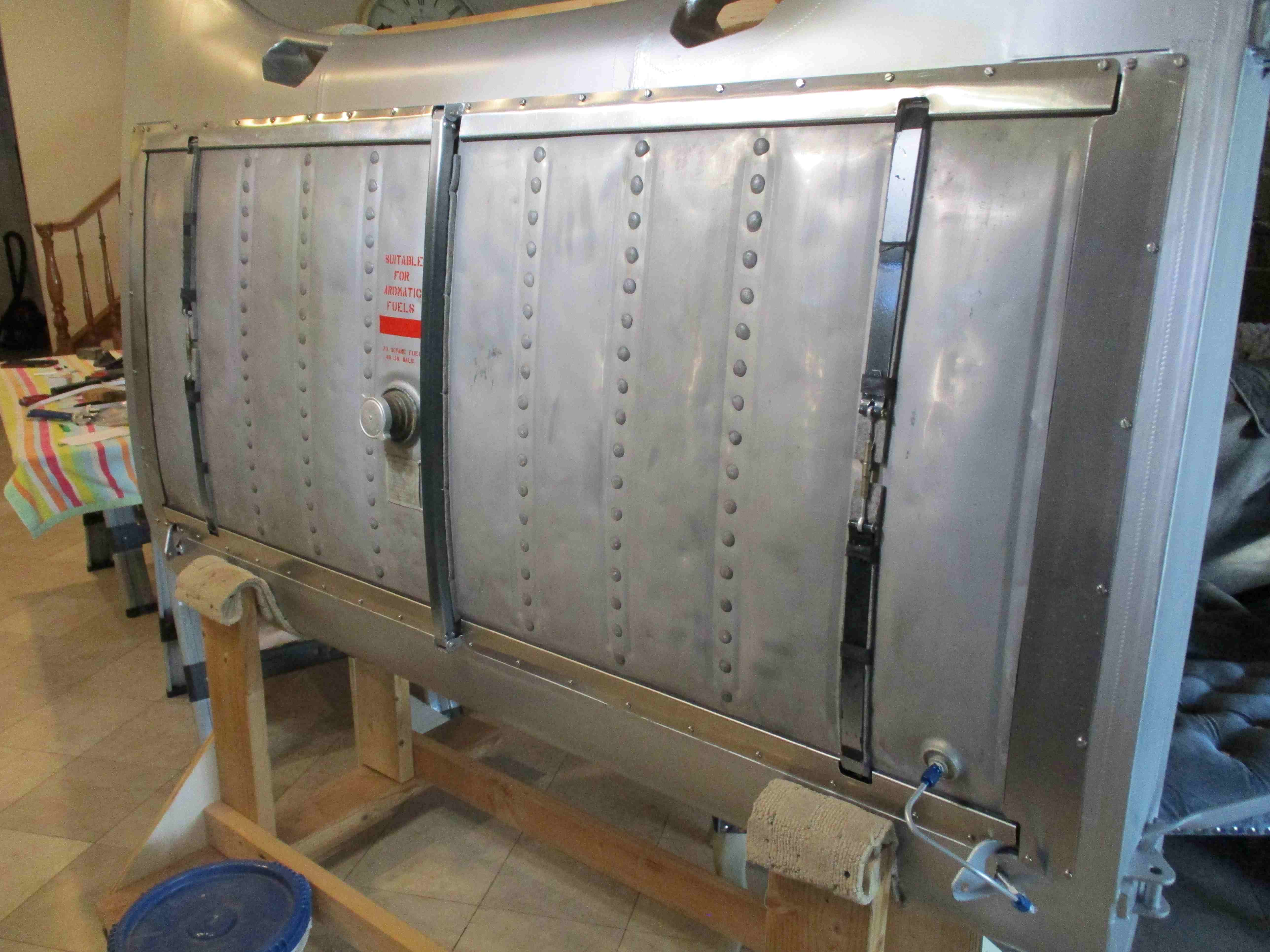

Success! OK, I had a time with the fuel tank. It has seven baffles that are first riveted and then rose-bud welded. All of the baffles in my tank were popped. That is fixable (with a lot of work), but someone had also painted the tank, making the job that much more difficult. So...there are no new tanks available, and all the used tanks look like they were trampled. Actually...they were all trampled! The tank is hard to reach at the top of the wing, so there is a tendency for fuelers to sit on, stand on, and otherwise abuse the tank. I found this tank, and I know from experience that it is the best tank in the country. It cost an arm and a leg in barter parts - and cash - to get it. But, all done and here it is installed in the upper wing center section.

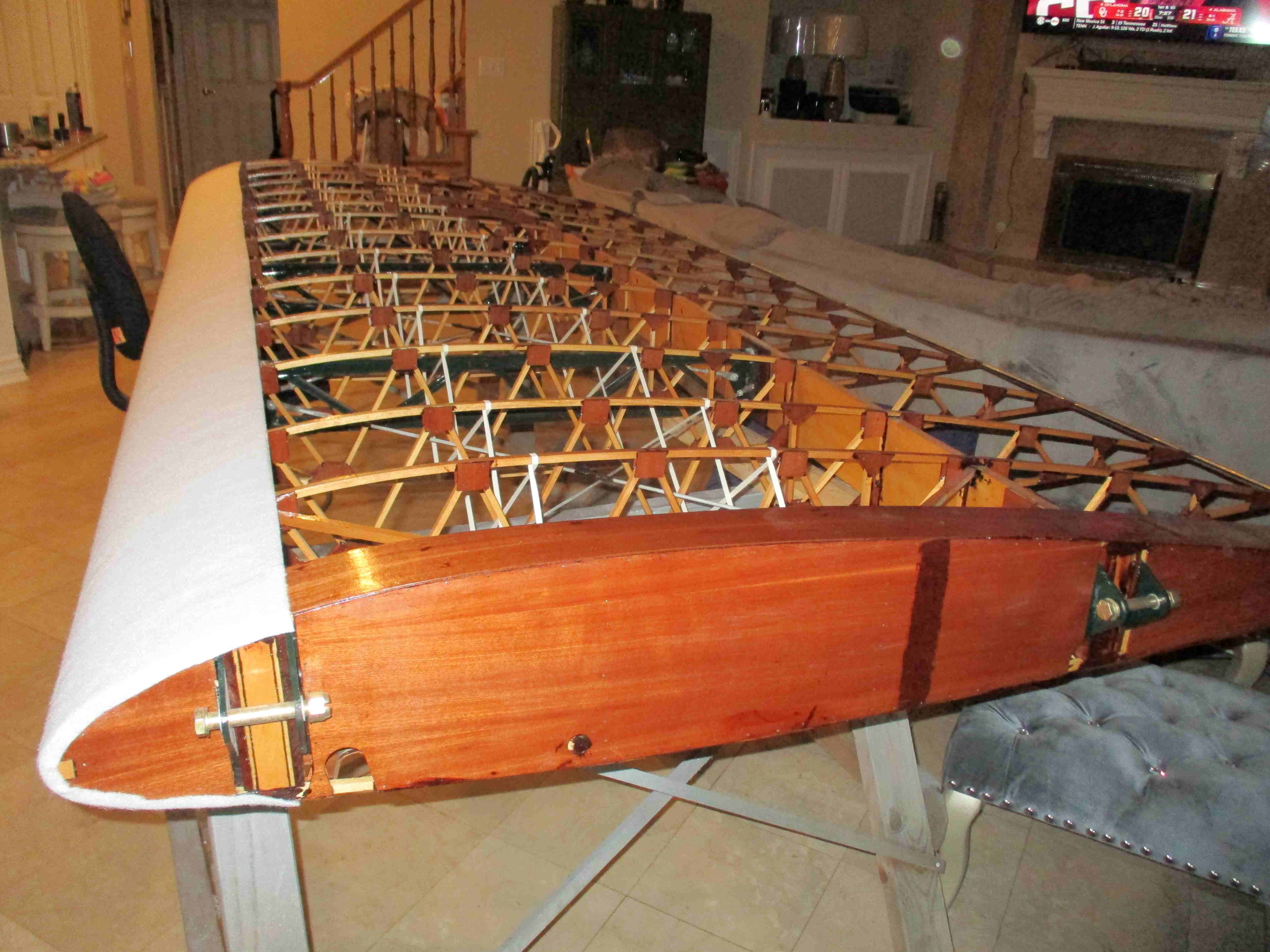

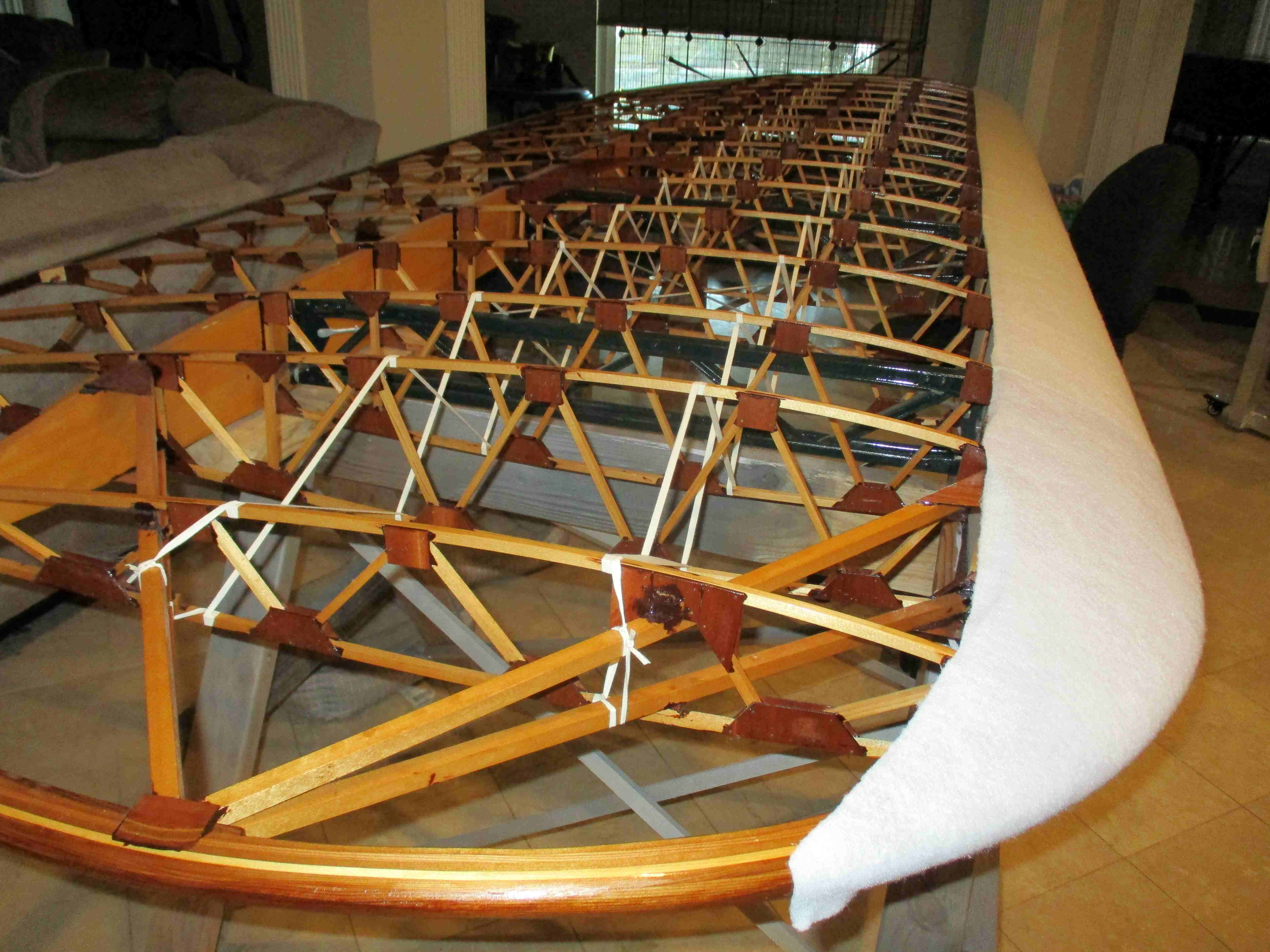

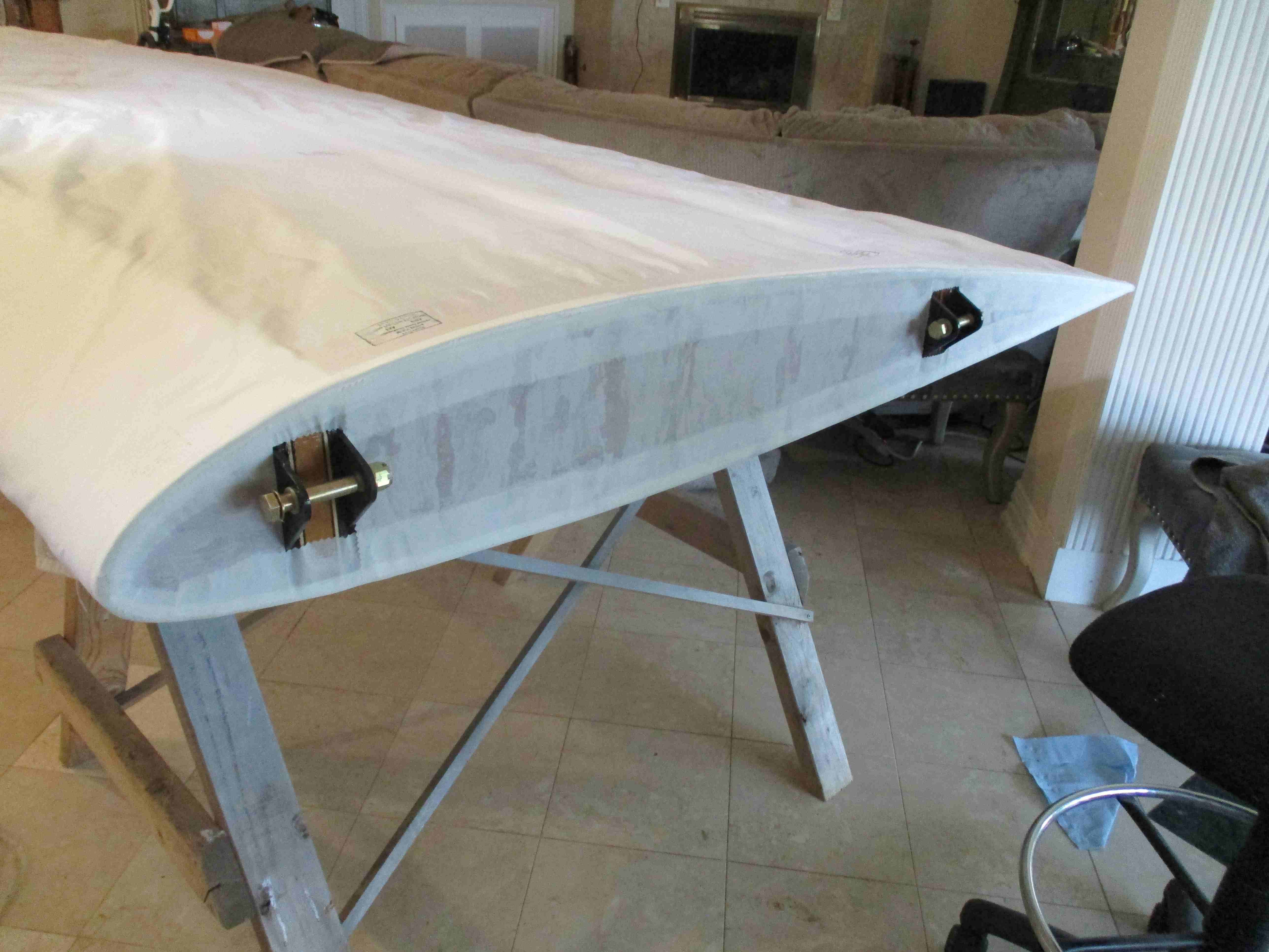

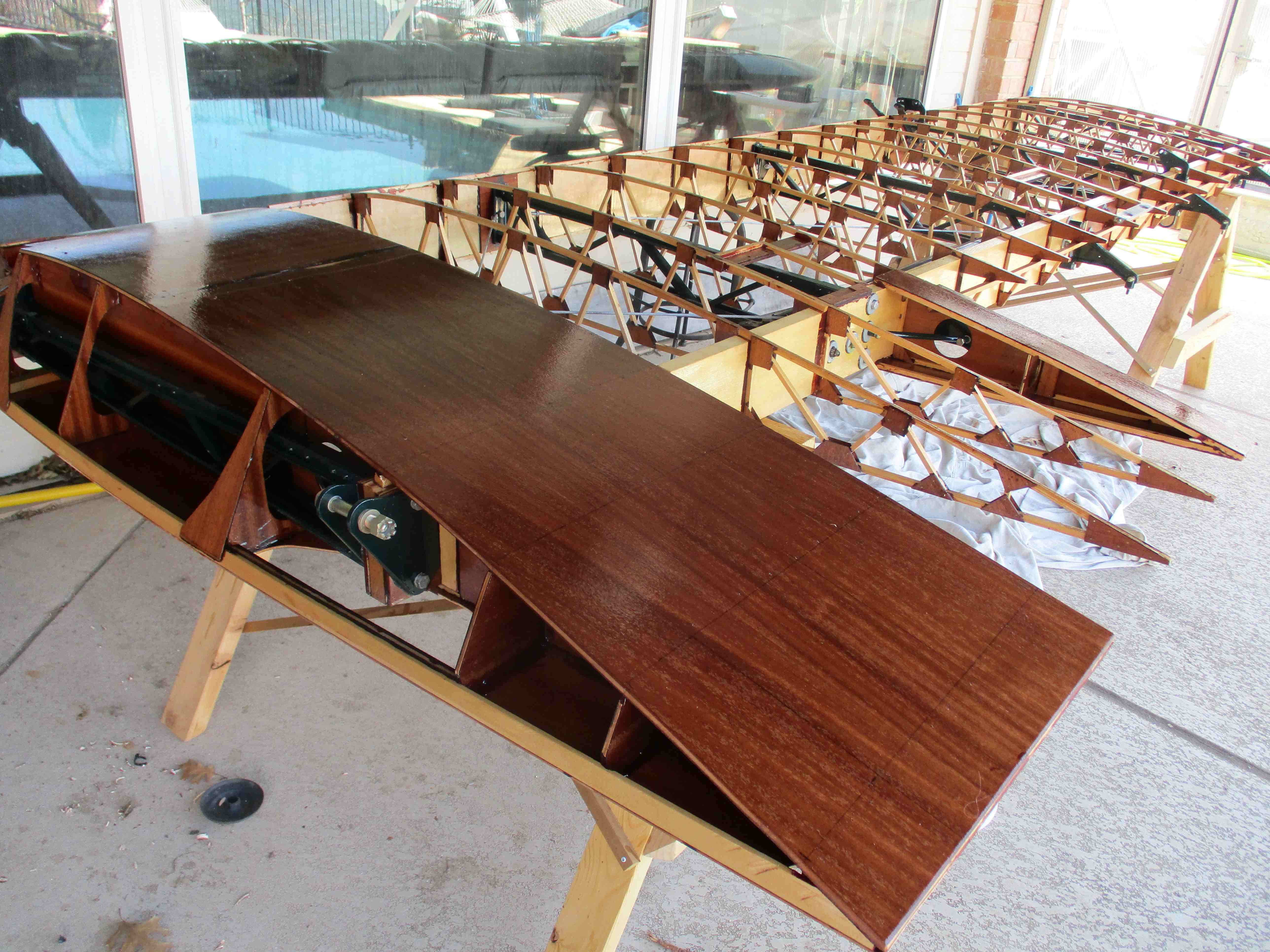

Now I finally get to the wings. The lacing along the ribs prevents the ribs from being moved as the covering is shrunk. Since the front of the wings are covered by thin sheet aluminum, I chose to apply a layer of padding to minimize the dents from normal use.
The old Juki sewing machine I have used on my Triumphs for 15 years came in handy to sew envelopes to cover the wing. The covers are then installed like putting socks on your feet.

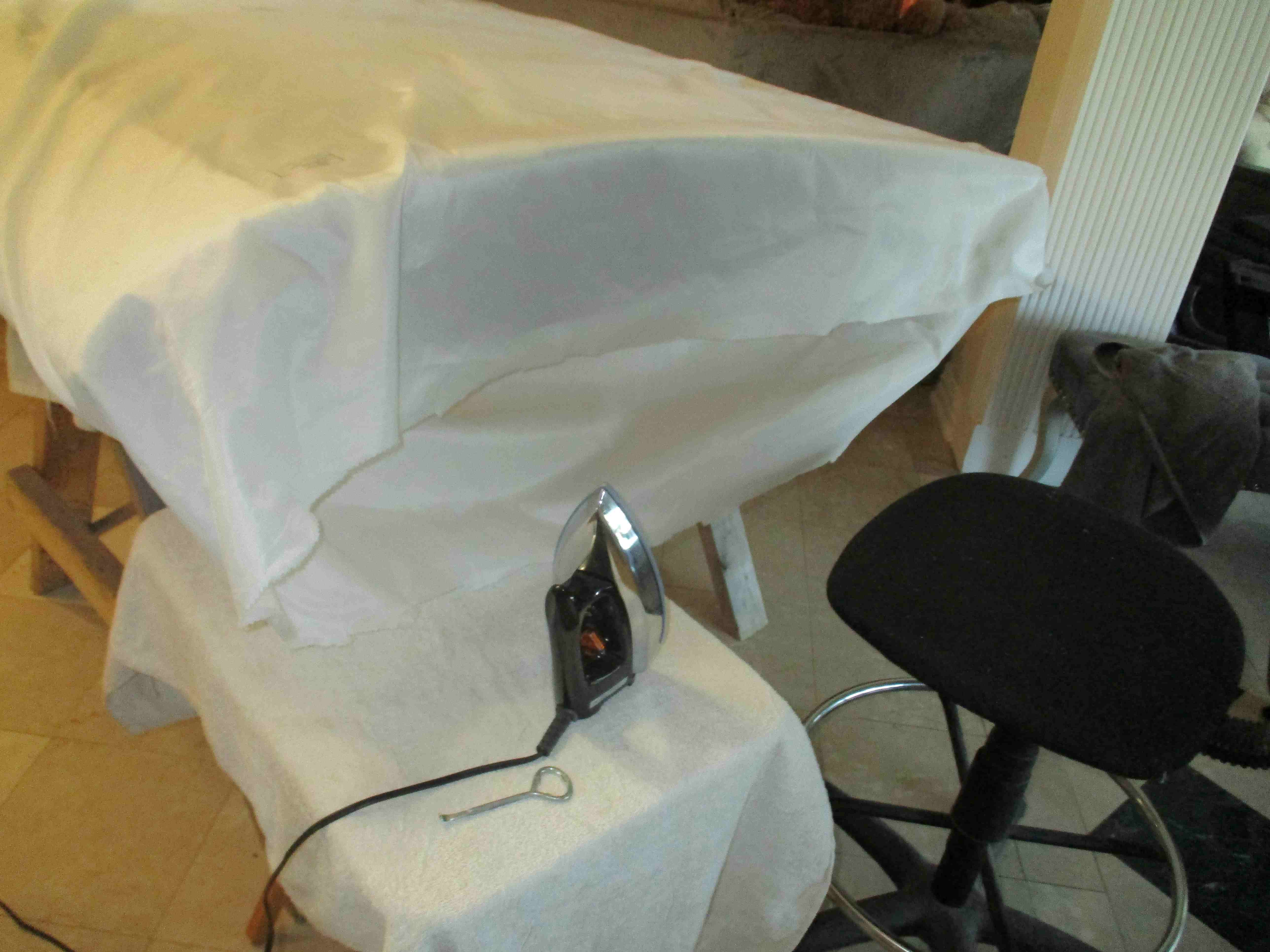

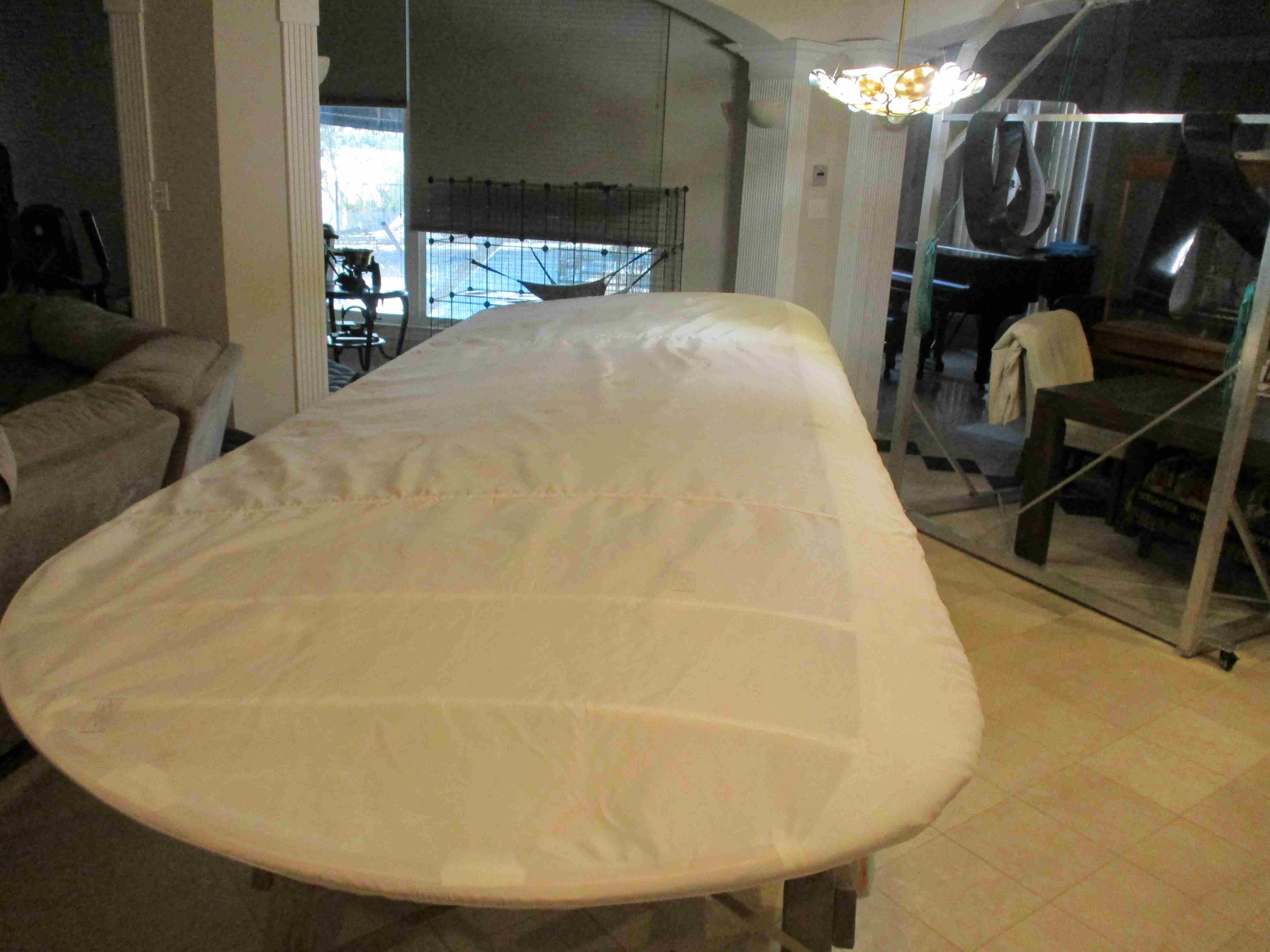

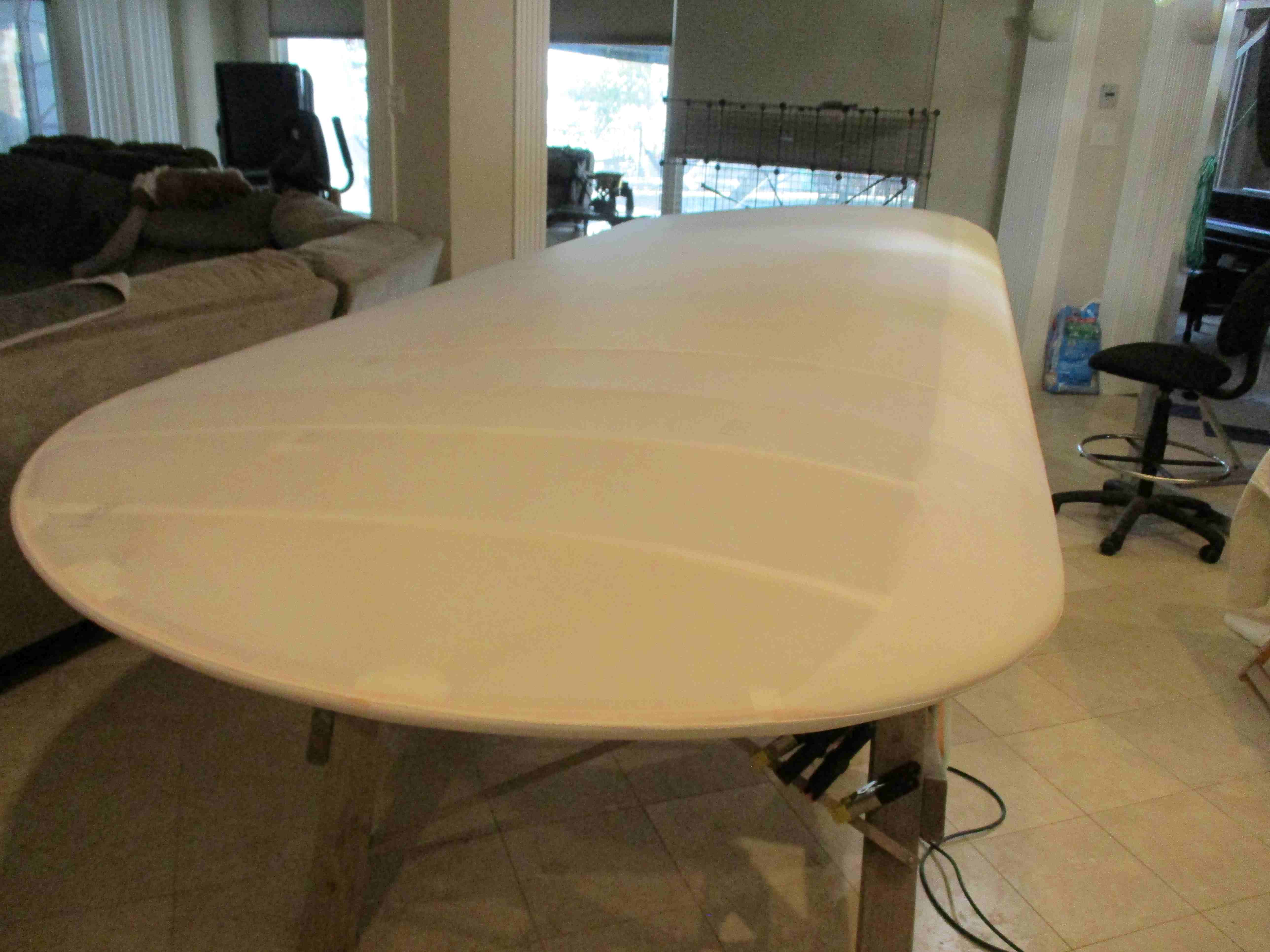

The shrinking with a household iron is done at exact temperatures and using a lot of care to keep the fabric seams centered on the ribs. The end is carefully trimmed and glued down neatly

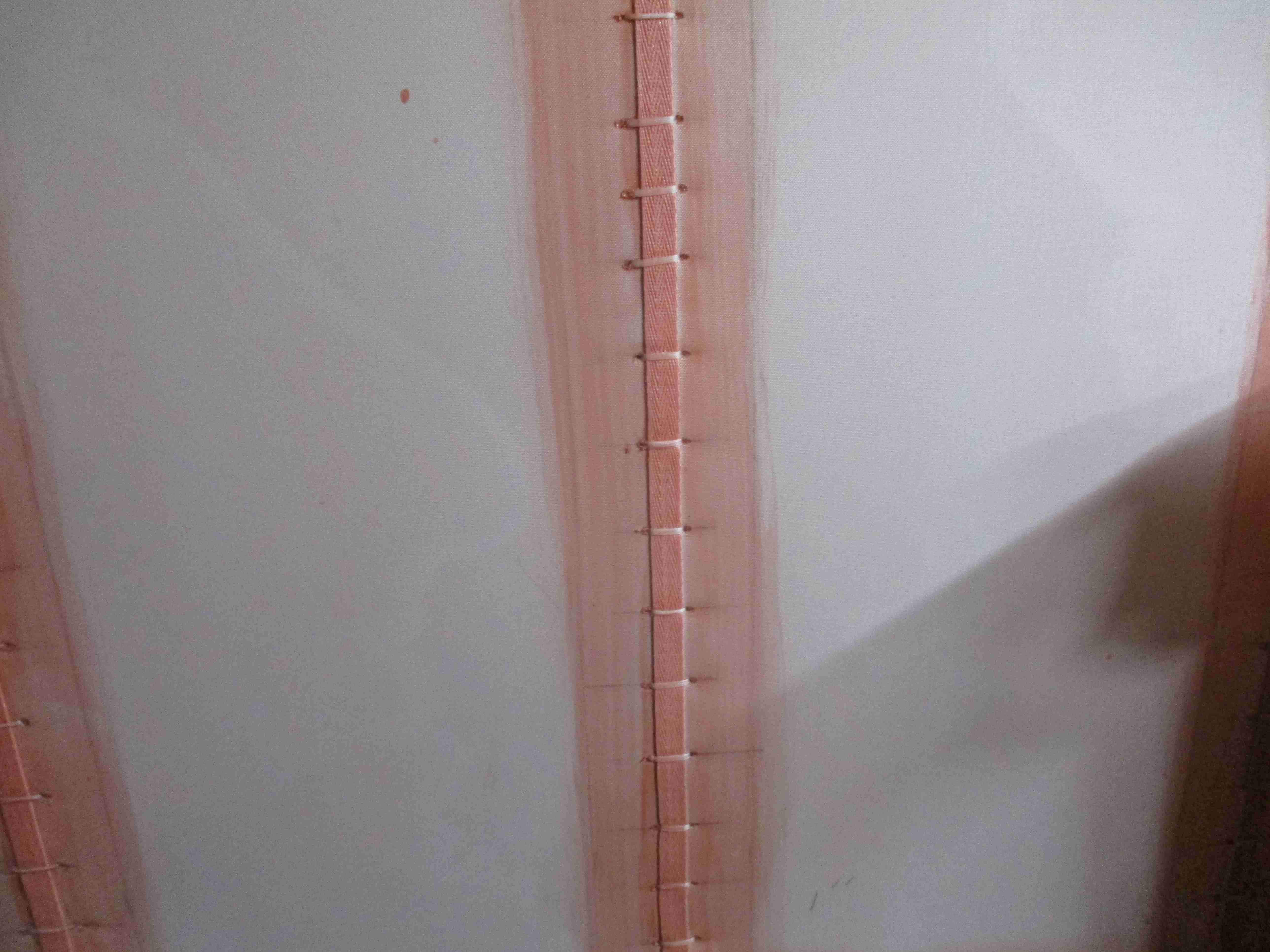

Now, a coat of polybrush sealer is applied by brush. This effectively locks the tautness into the fabric. Unlike dope, is does not shrink the fabric...that was all done by the iron heating in the prior step. In the next photo you can see a reinforcing strip is laid down over each rib, and then the stitching is applied to hold the covering tight against the ribs. Spacing is specifically called out, based on the plane max speed (182mph for a Stearman), and also the area affected by the propeller circle. Each stitch has to go around the entire rib, get knotted with a special sein knot, and then the continuous lacing thread is run through to the next knot. In this area on the lower wing within the prop circle lacing is at least every inch! while this is being done, you must take care to avoid fowling the control rods that run to the ailerons. The darker coloring is 4 coats of polybrush laid down to saturate the cloth so the tape that goes over the lacing will stick permanently.

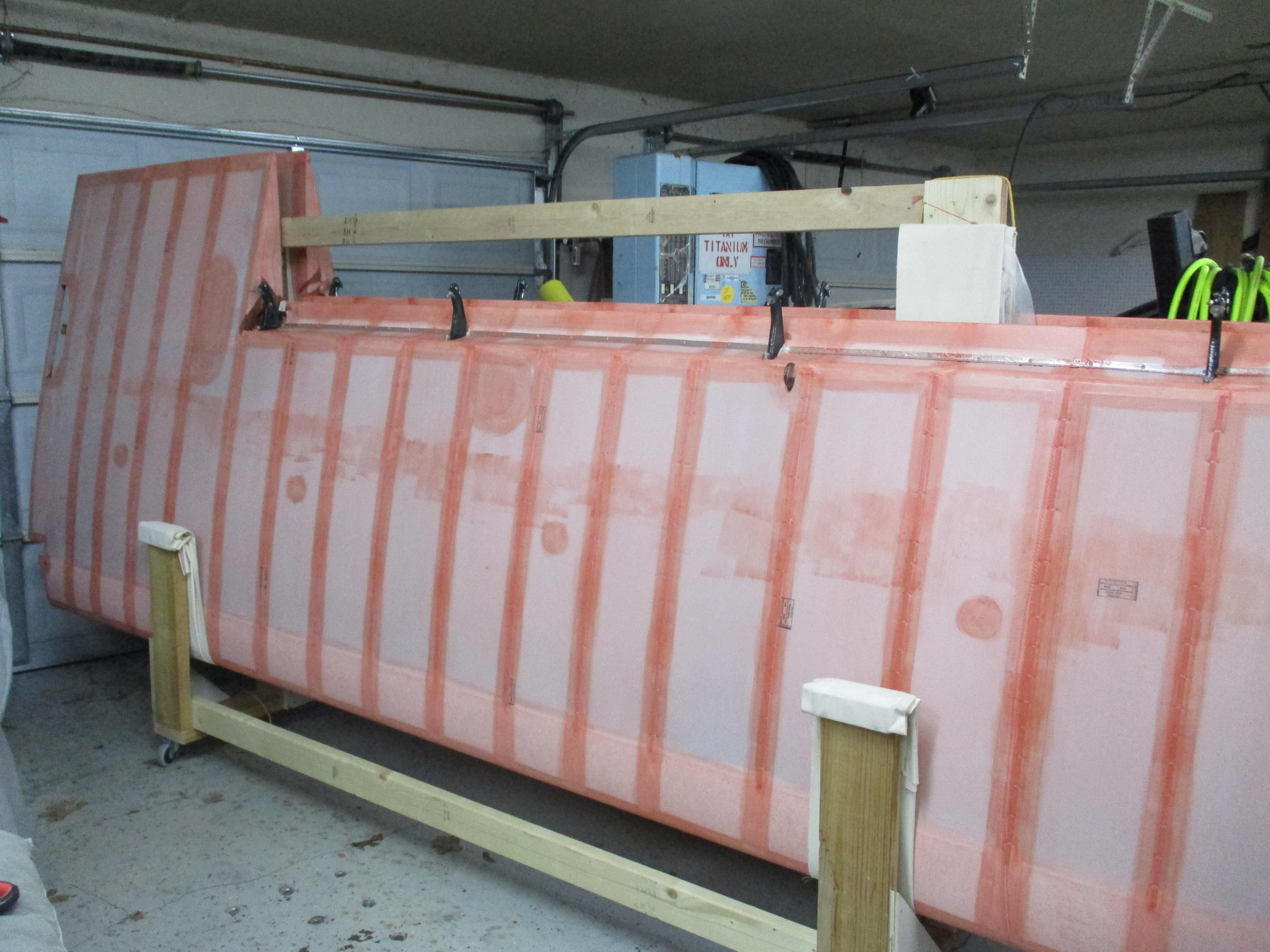

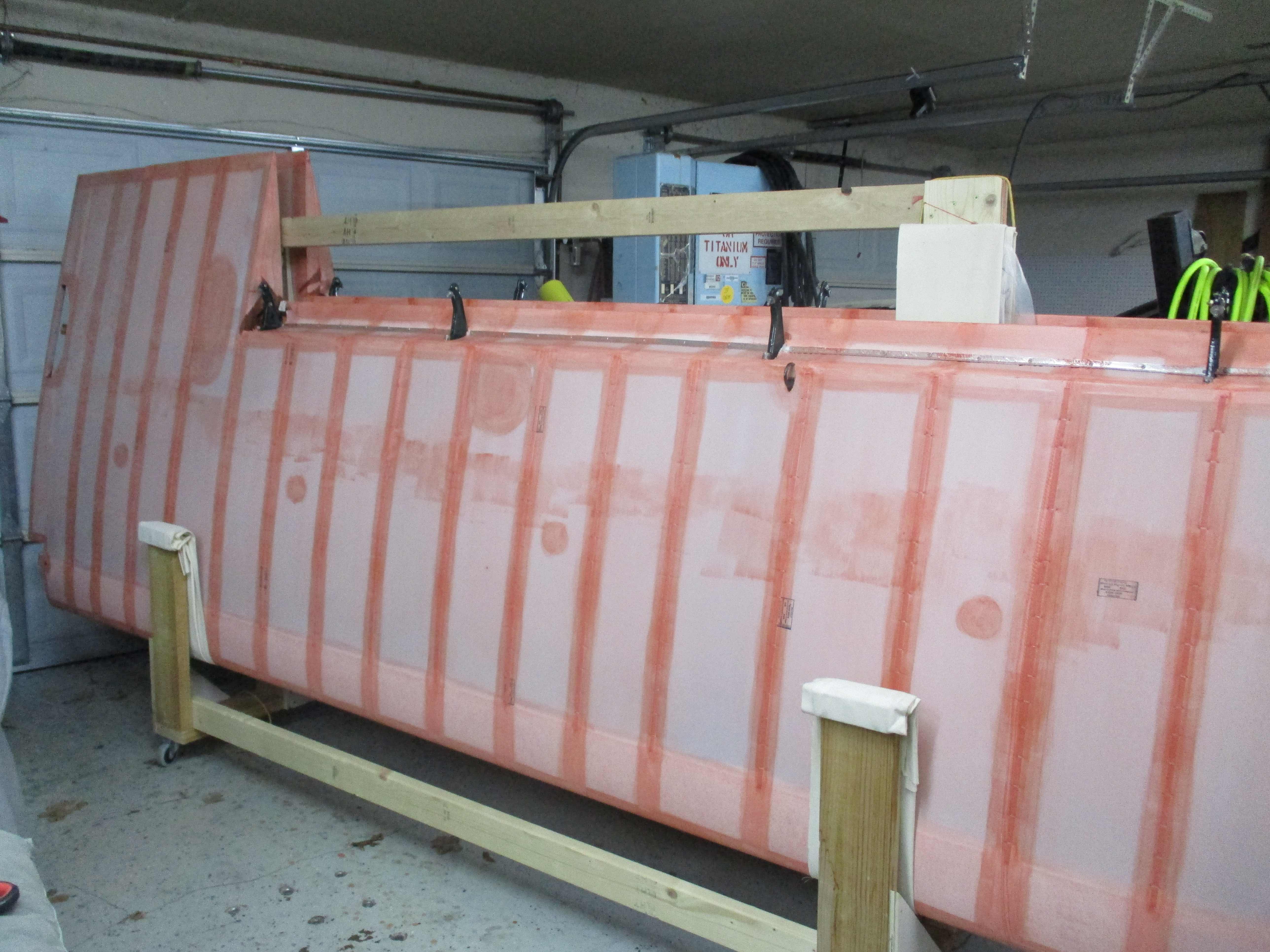

Now the wing is pre-coated where the tape will go. The odd dark areas are for "patches", which are additional cloth that reinforces areas that need it. Form here, the additional coats are sprayed. They include:
2 coats of pink sealer (polybrush)
4 coats of aluminum sealer (polyspray)
A sanding down of imperfections
2 more coats of silver...this polyspray blocks the sun's UV light from rotting the fabric, and goes back to the same aluminum impregnated dope used on zeplins.
Finally, 2 coats of final paint (polytone).
Finally, each layer must dry a day before doing any detailing in the paint.

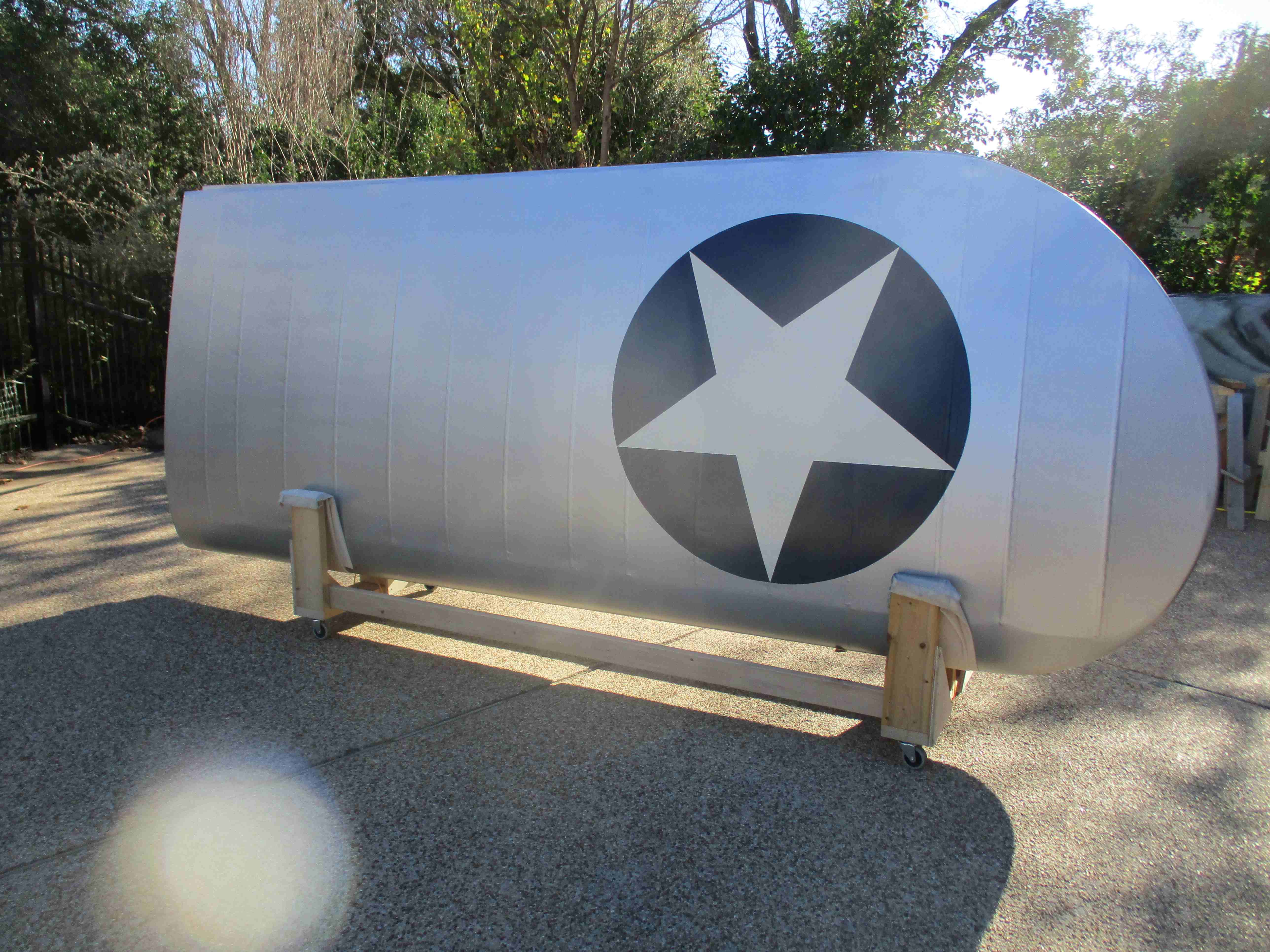

These are the finished top wings. I have been slowed, in that addition to having to spray at least 7 times, spraying must be done above 60 degrees...so the winter weather is slowing me a bit. Fortunately there is still enough things to do indoors on the cold days.

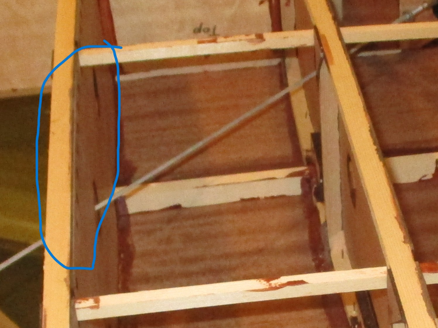

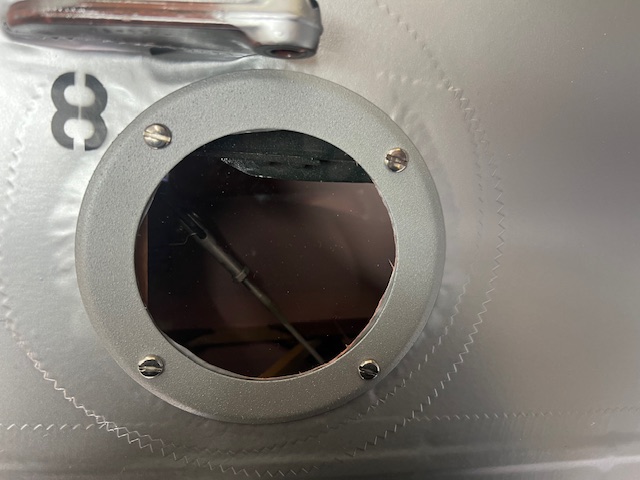

Of interest, there are 2 ribs underneath the walk area of the lower wing near the cockpits. If you think about it, there is no way to stitch around the entire rib, since the wing-walk plywood is in the way. These 2 ribs on each side had to be built with holes every inch, so the stitching can be done around the rib caps strips. There is still no access, though! The solution was to modify a curved needle to reach into the small stitching holes and back out. Those were the slowest stitches by far!
In the third pic you can just make out the stitching holes I circled...

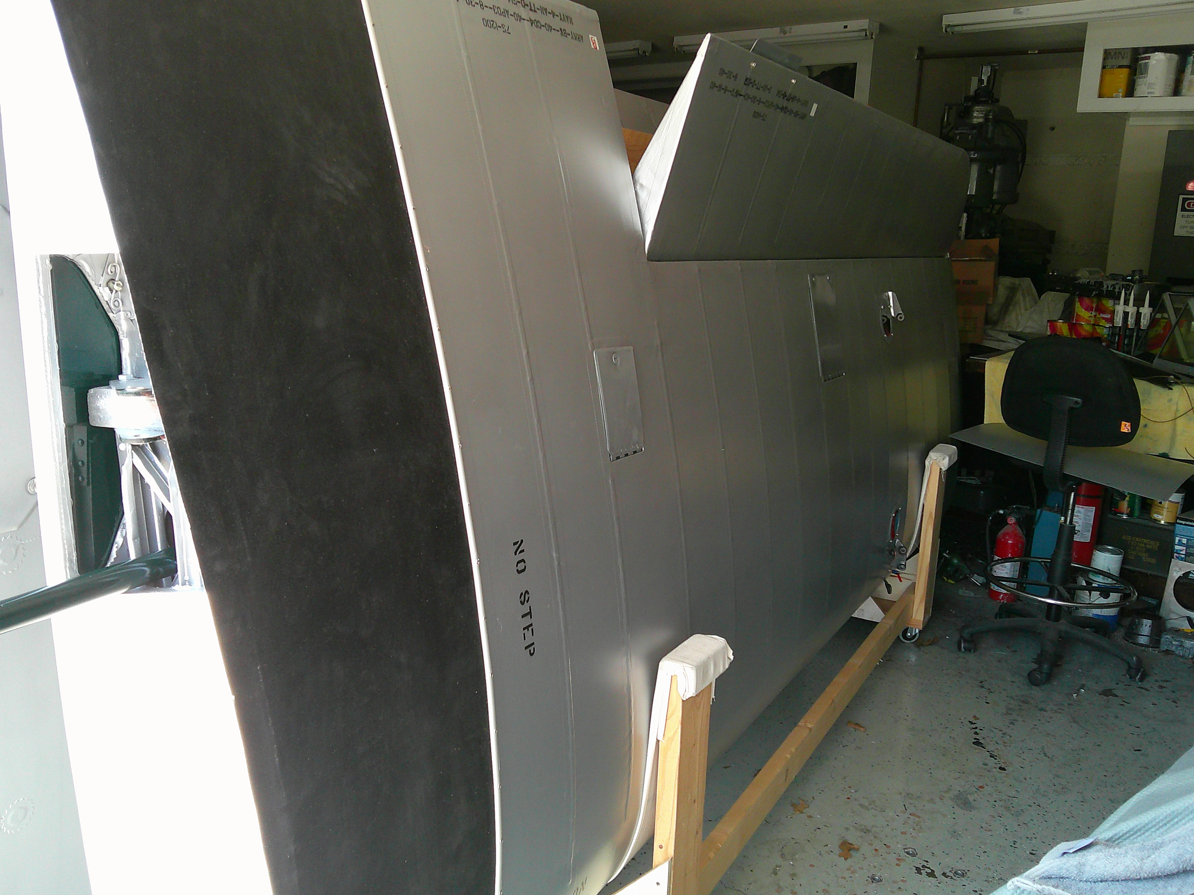

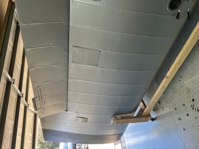

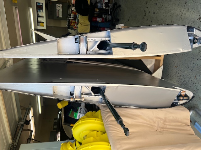

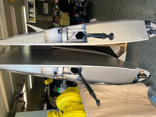

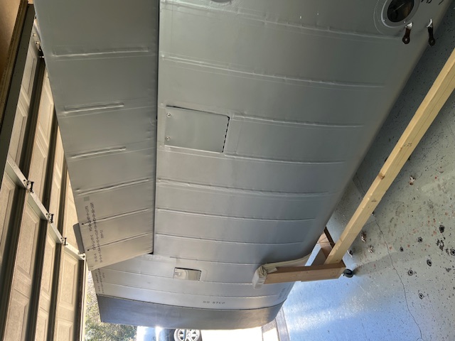

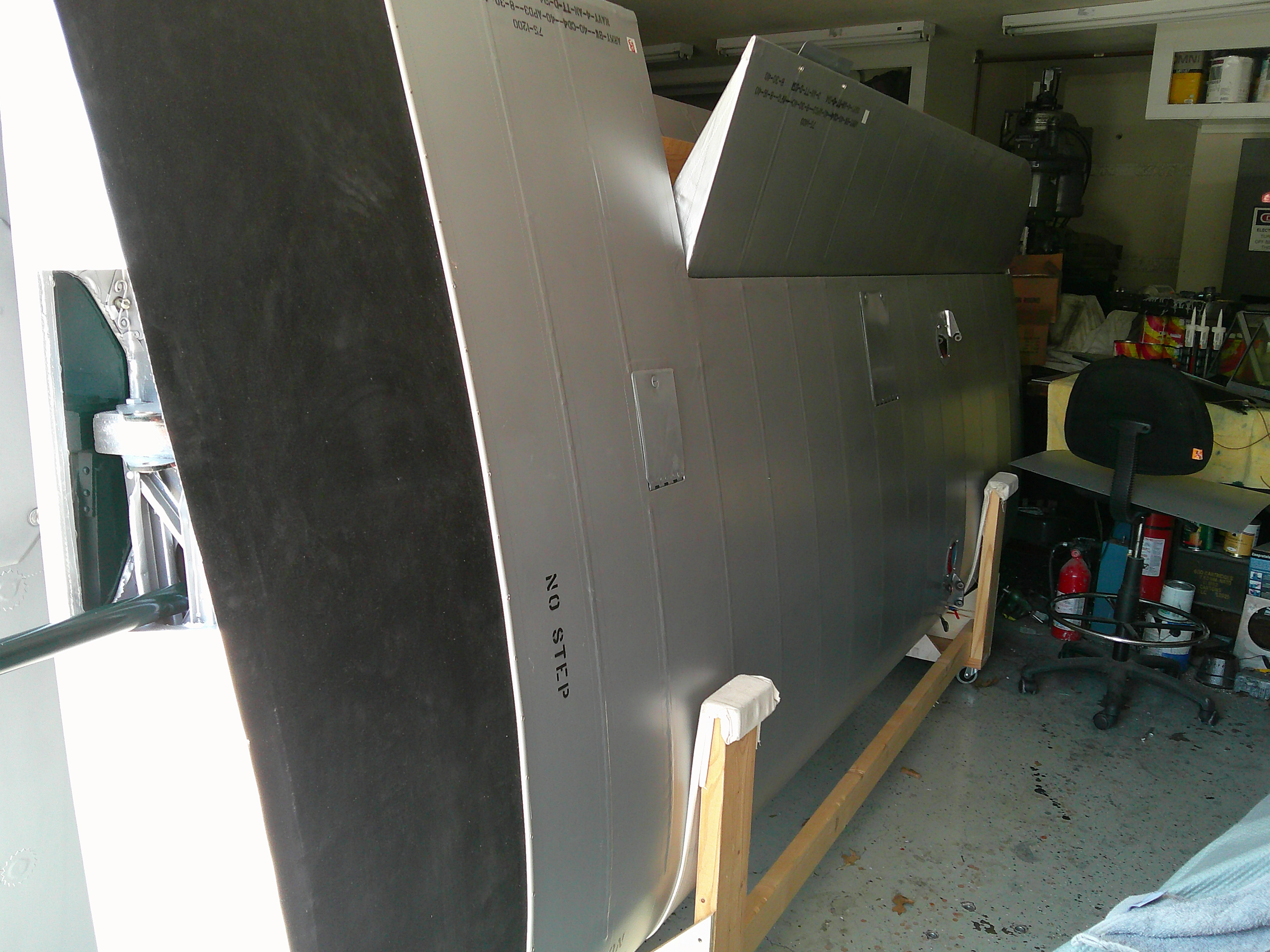

I finished the lower wings. They are similar, but required a non-skid walkway, installing the ailerons and mechanicals to move them, and several inspection doors and windows. They're all done and sent to the hangar!

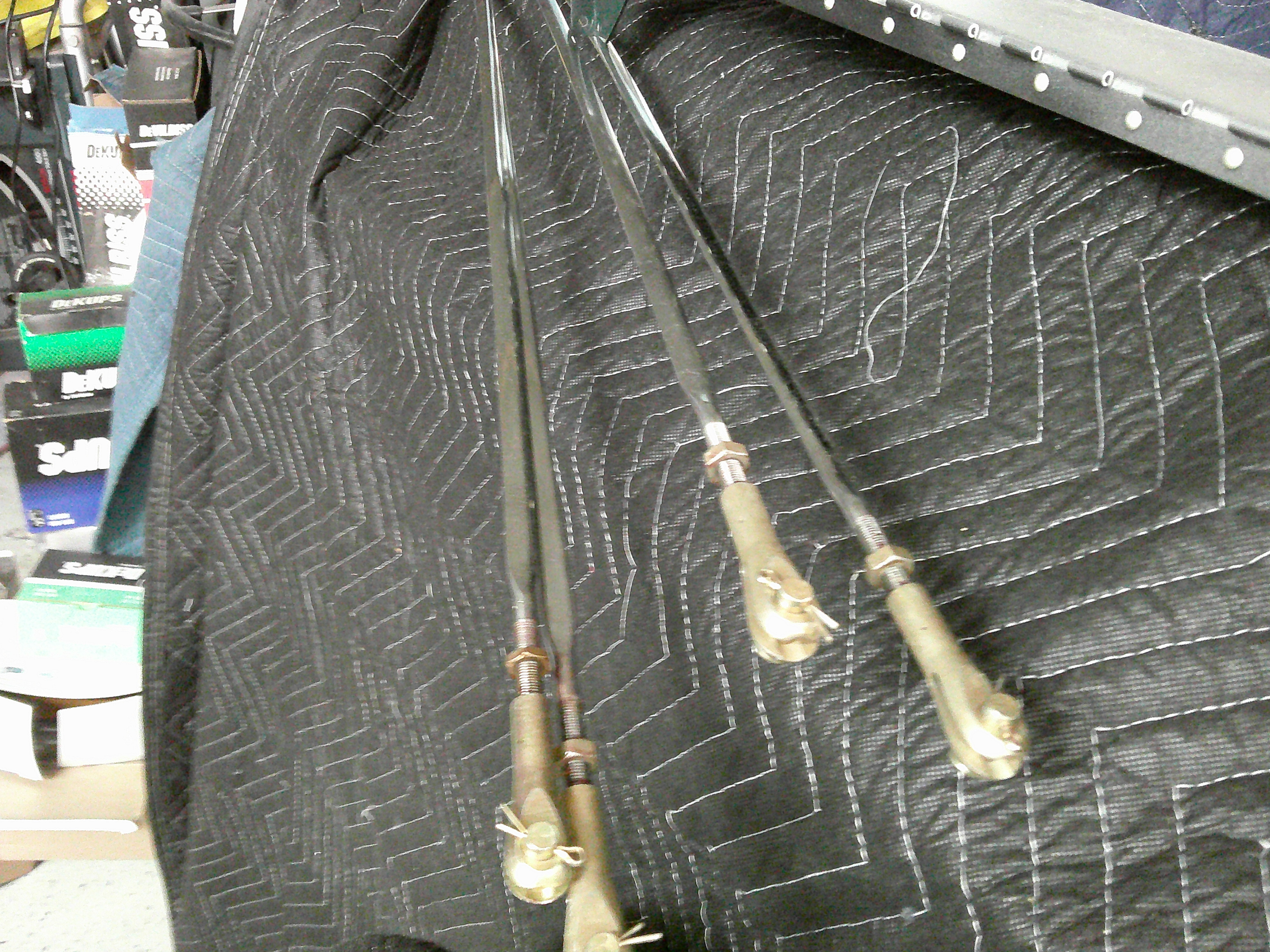

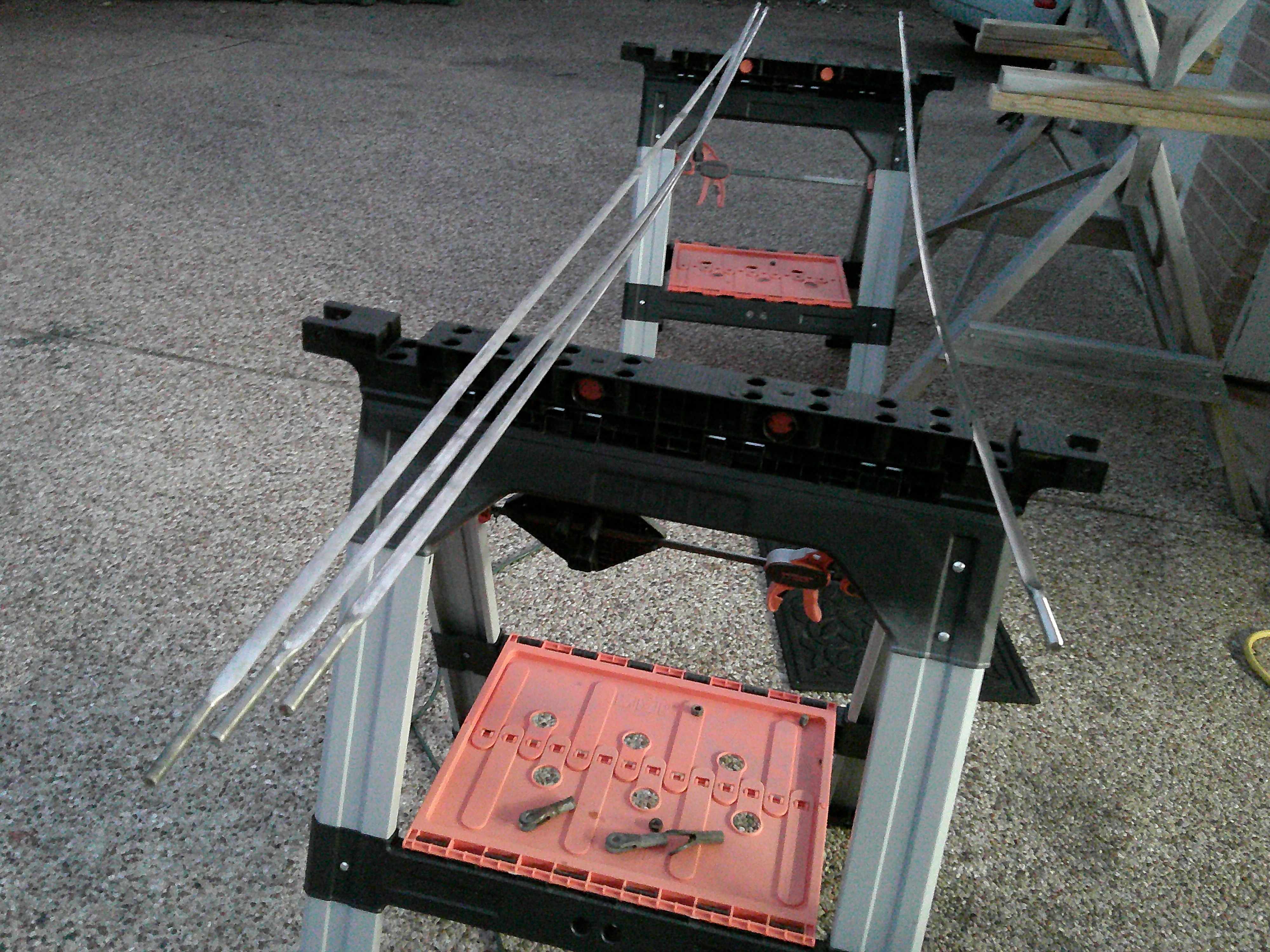

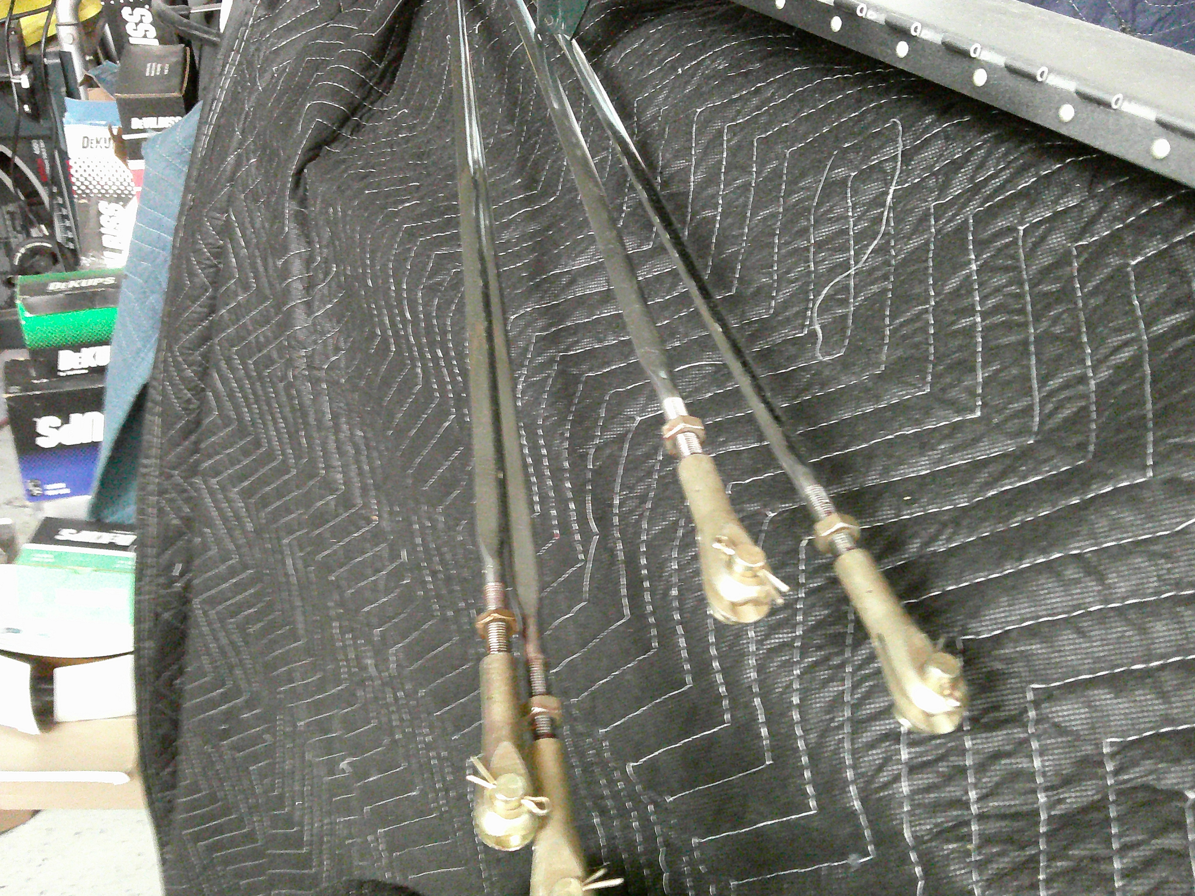

I procrastinated during the cold weather here in Texas before starting the last part to be covered...the fuselage! So I spent a week itemizing the flying wires. I was only missing 1, which is good, since these things cost a small fortune to replace. I got them all de-burred, polished back to a mirror finish, and sized to their proper lengths. Now I am out of things to fiddle with. It's time to cover the fuselage.

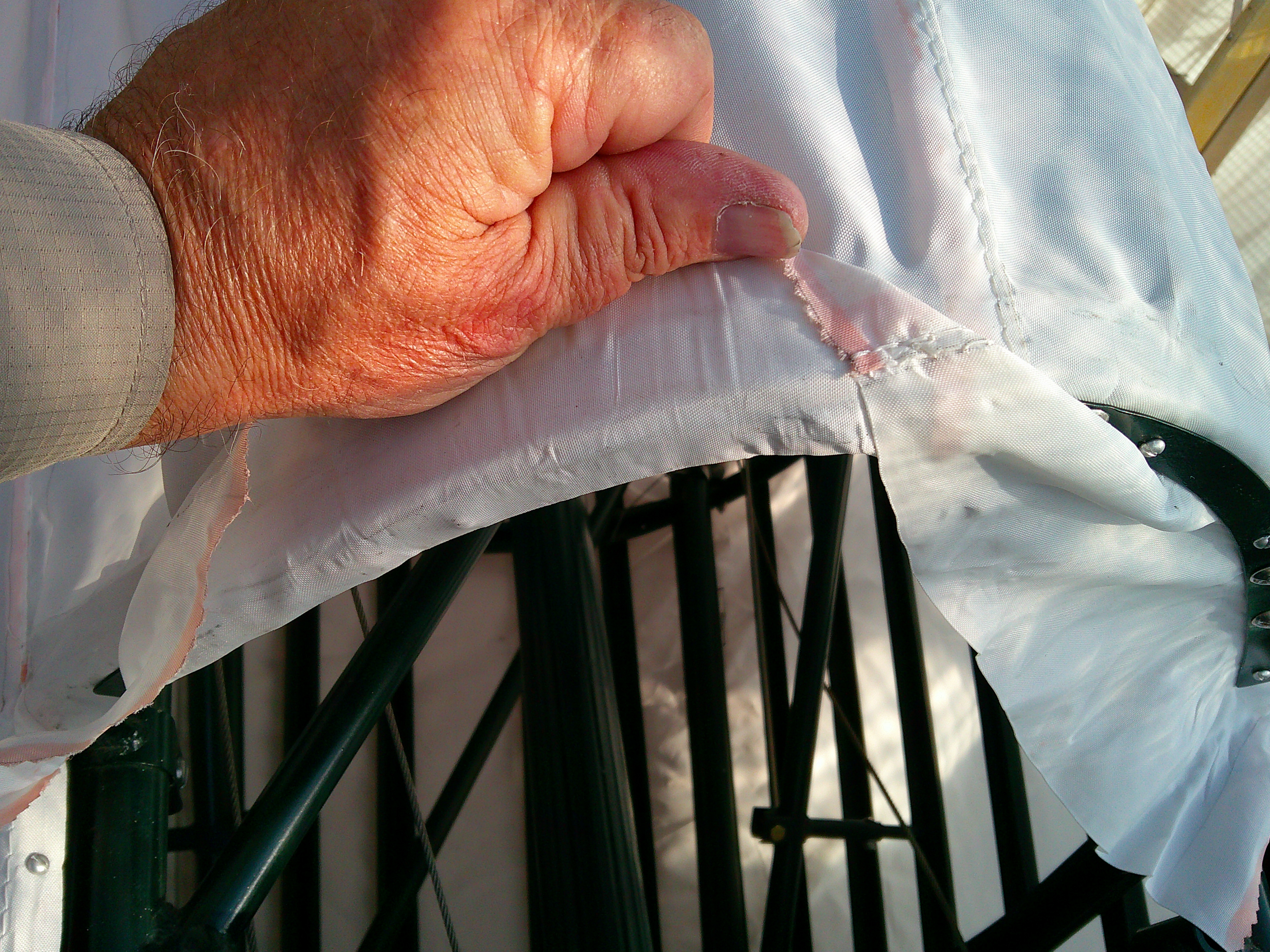

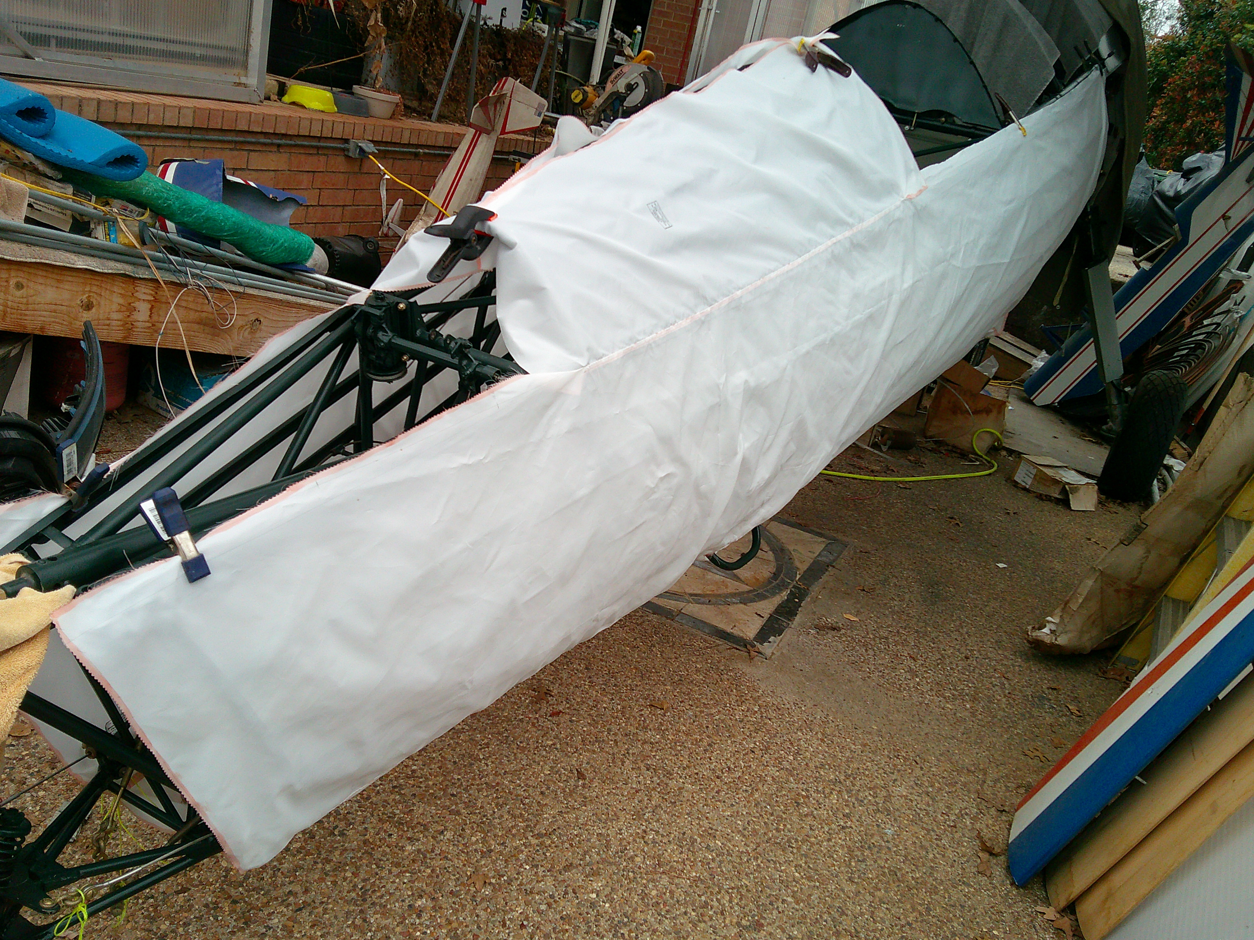

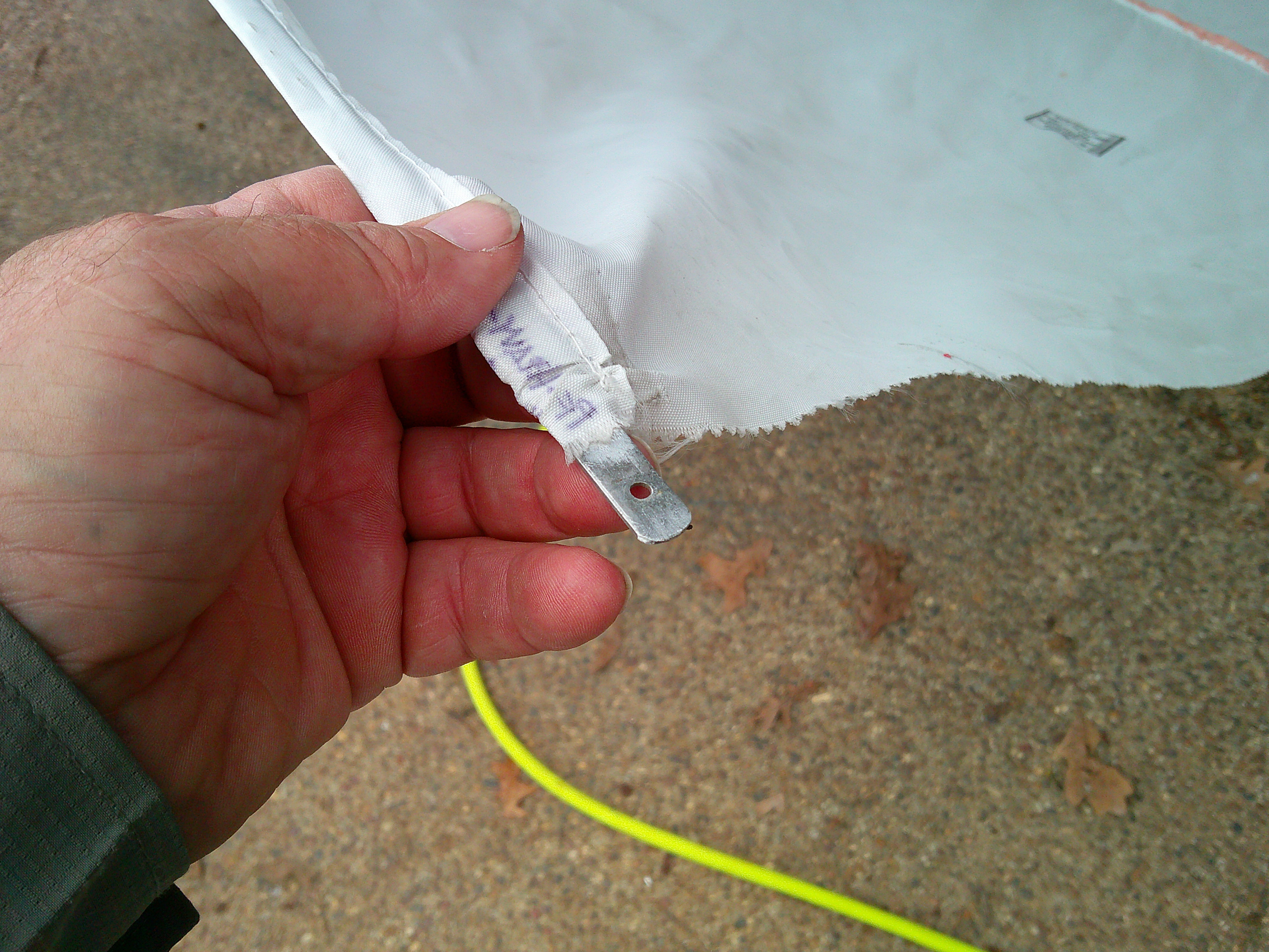

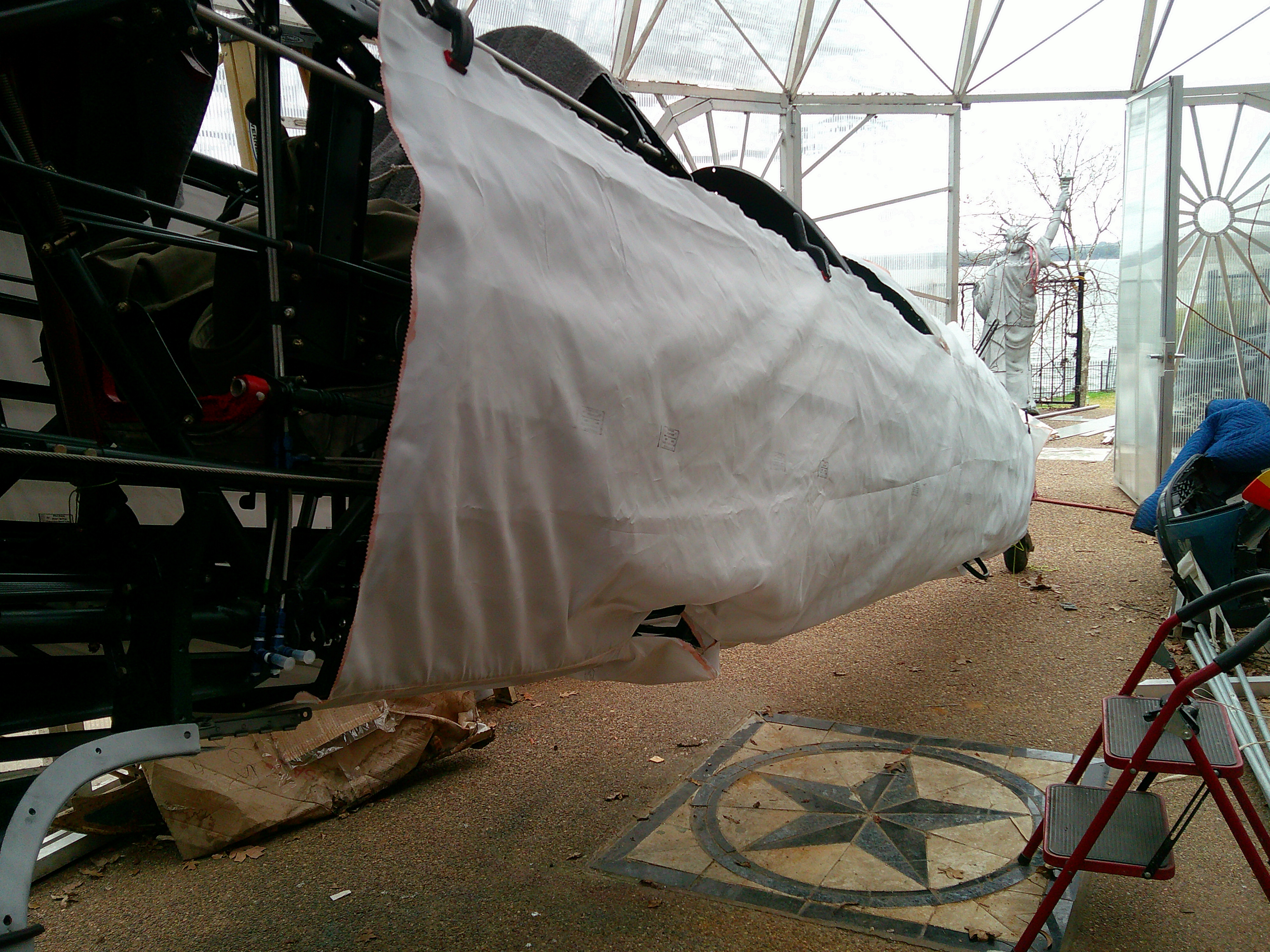

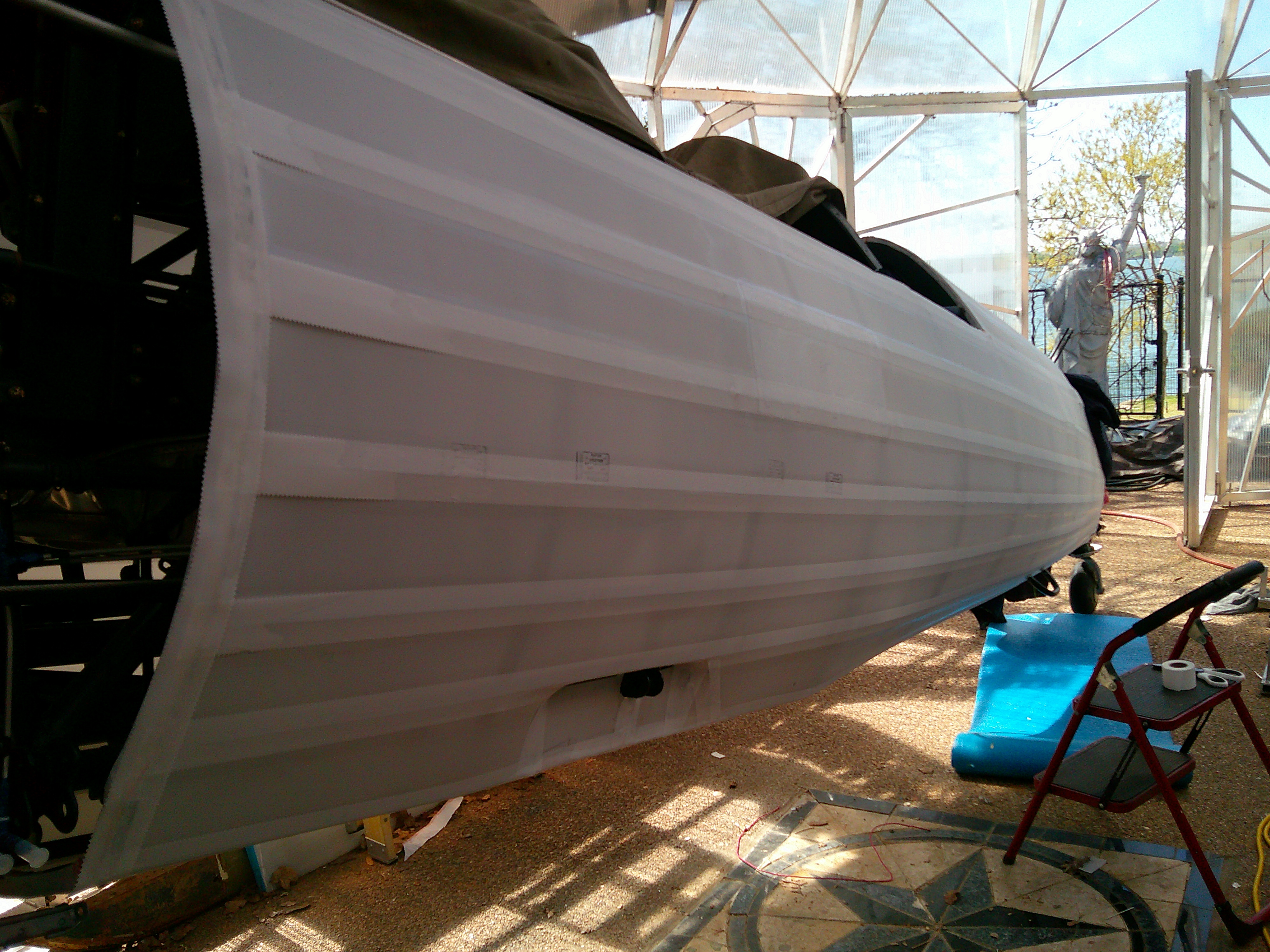

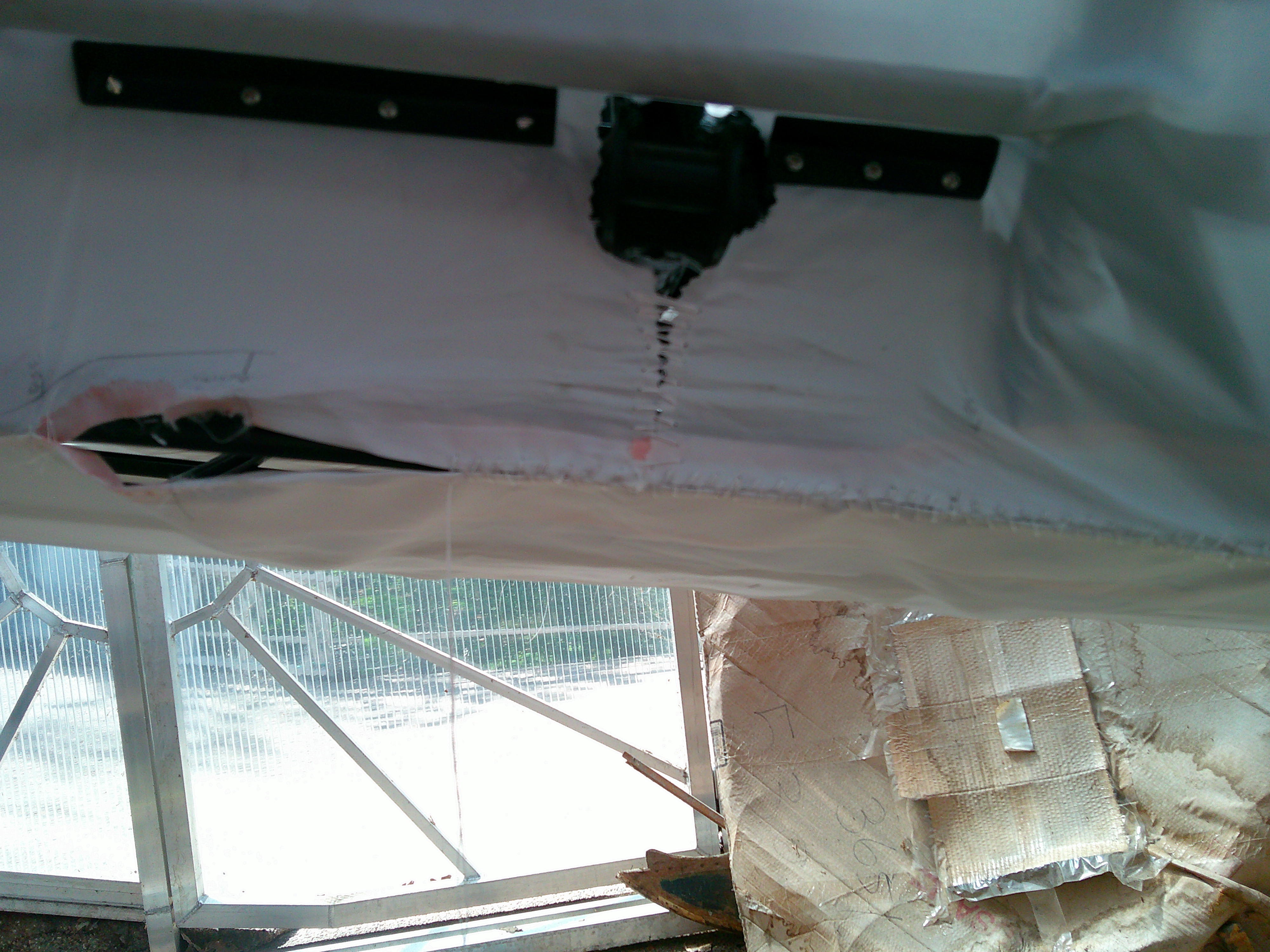

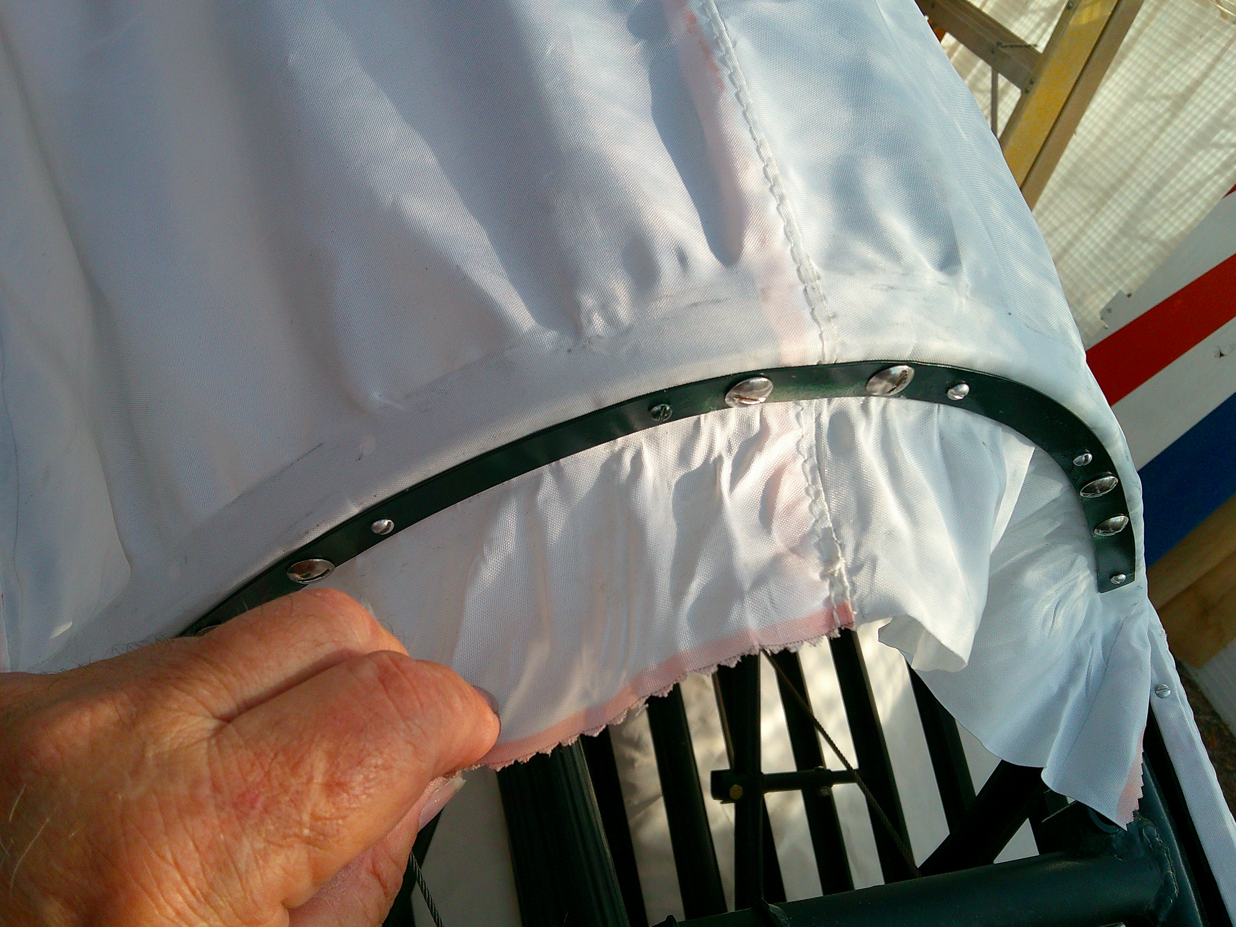

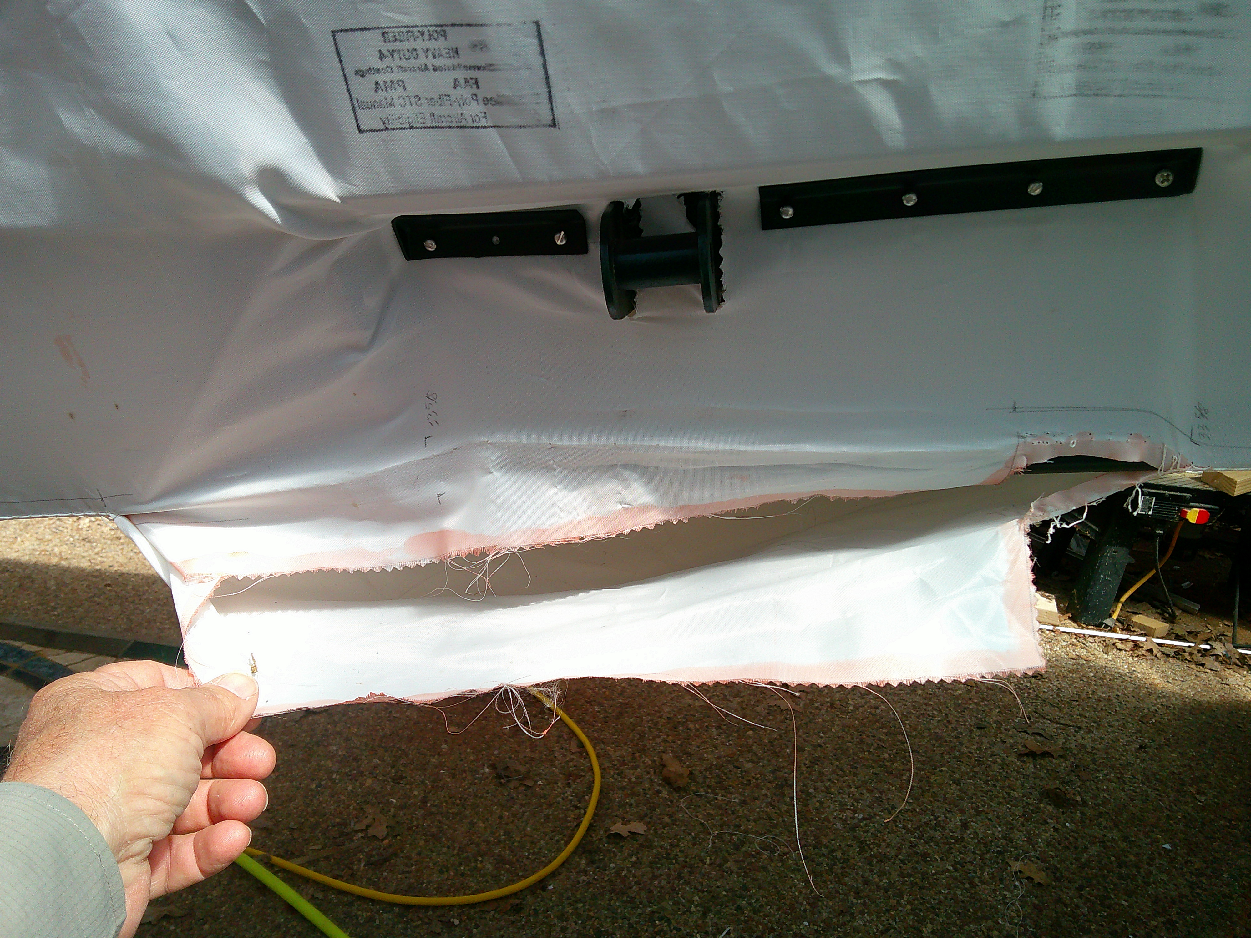

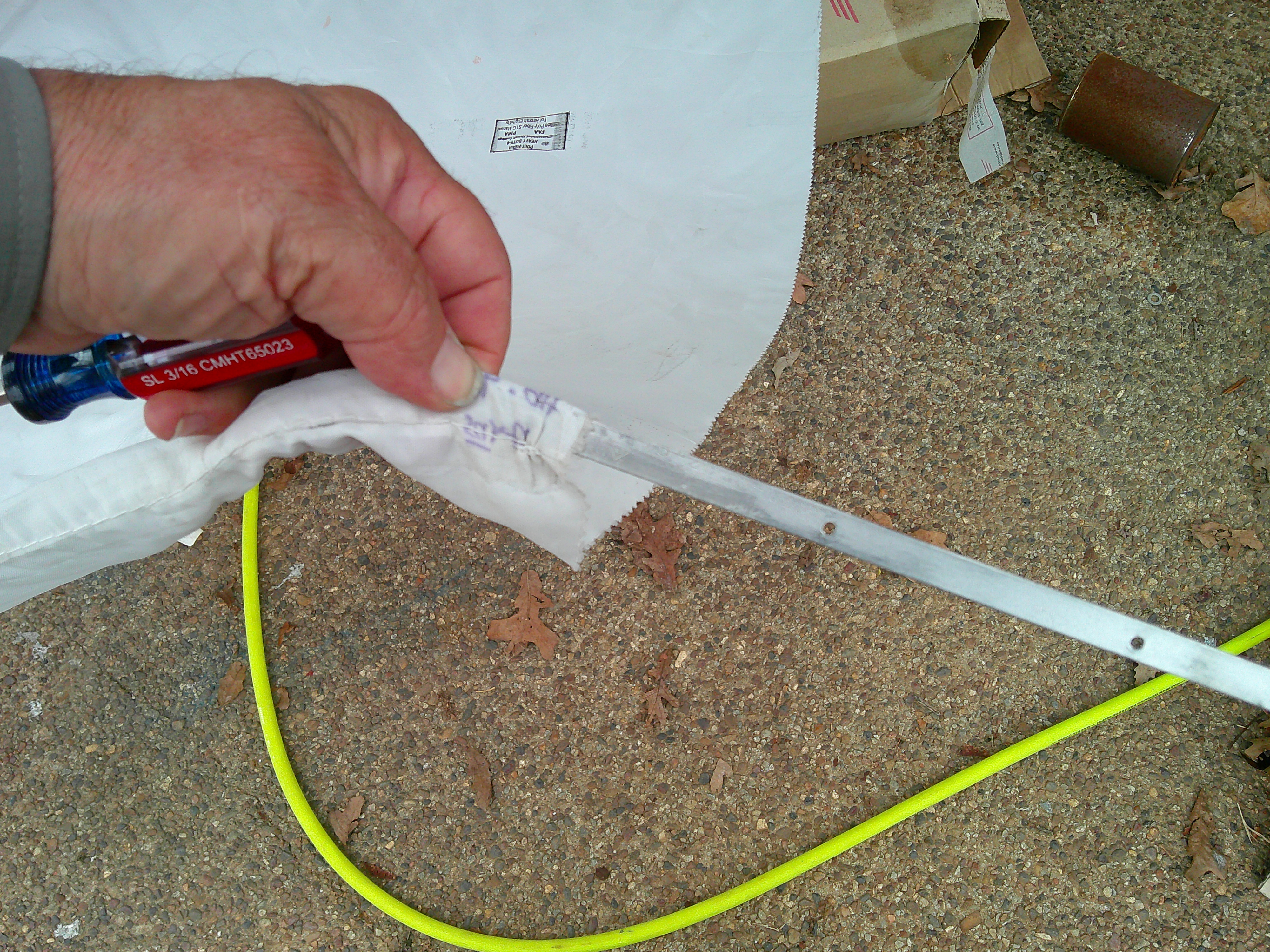

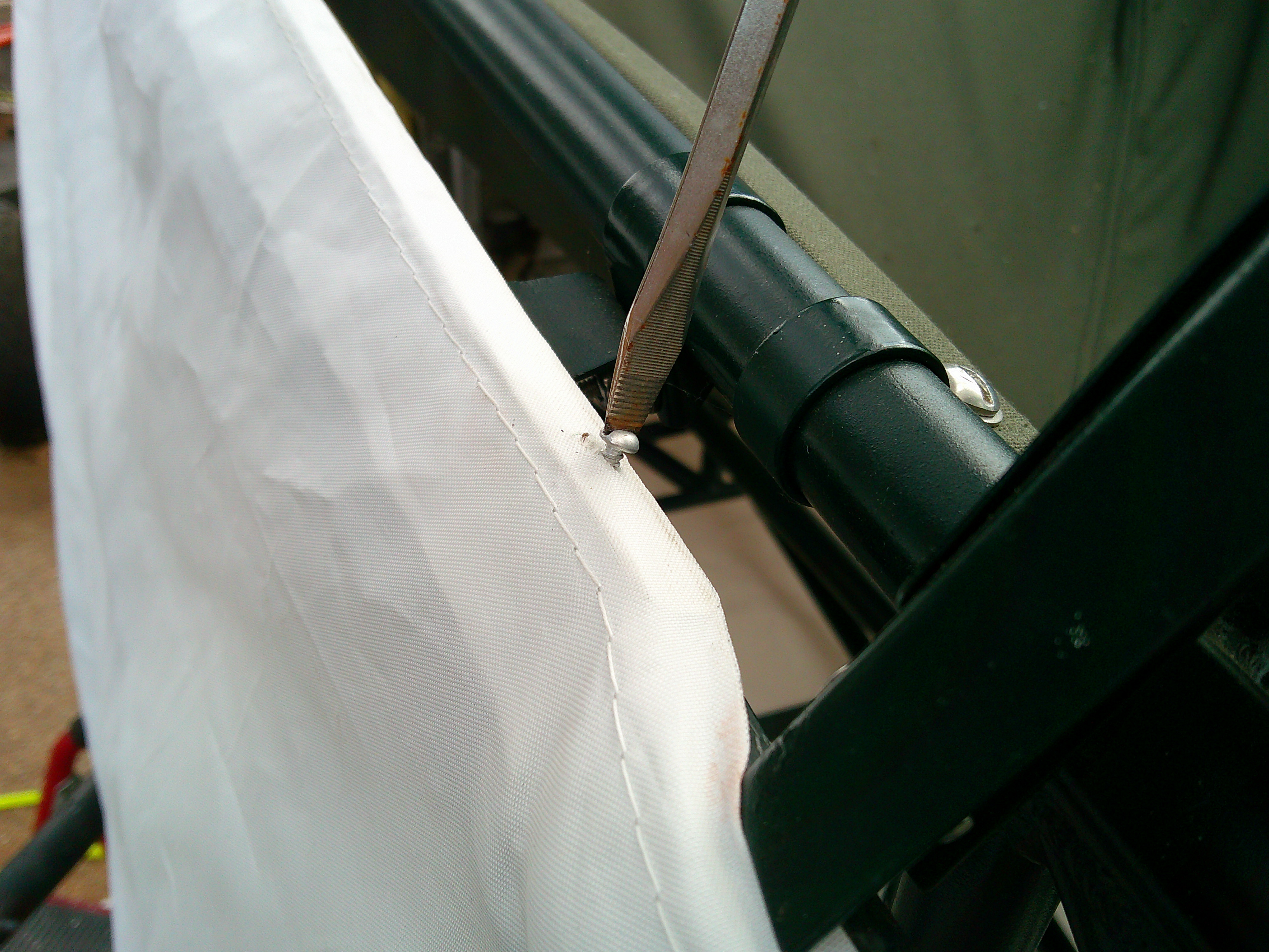

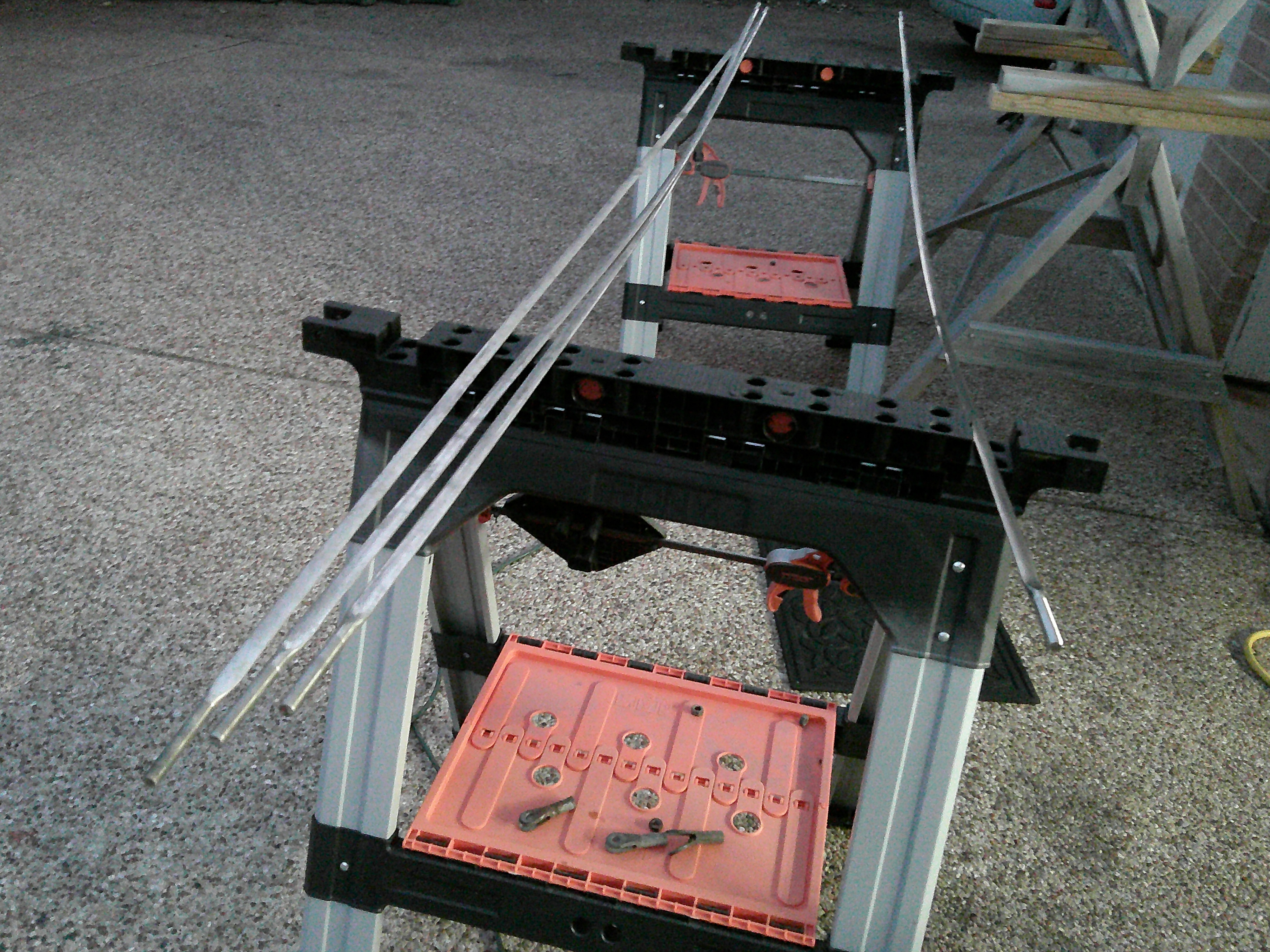

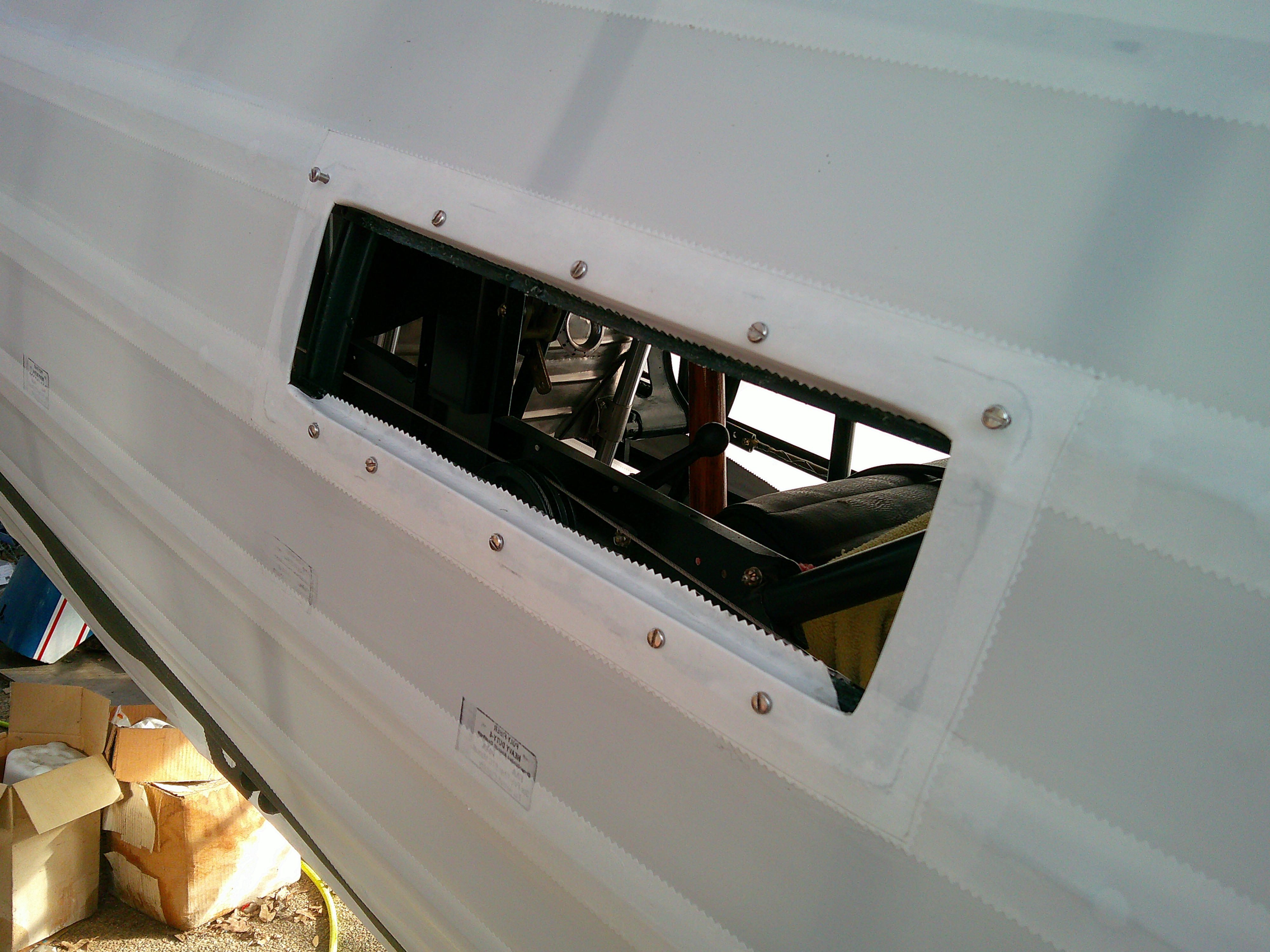

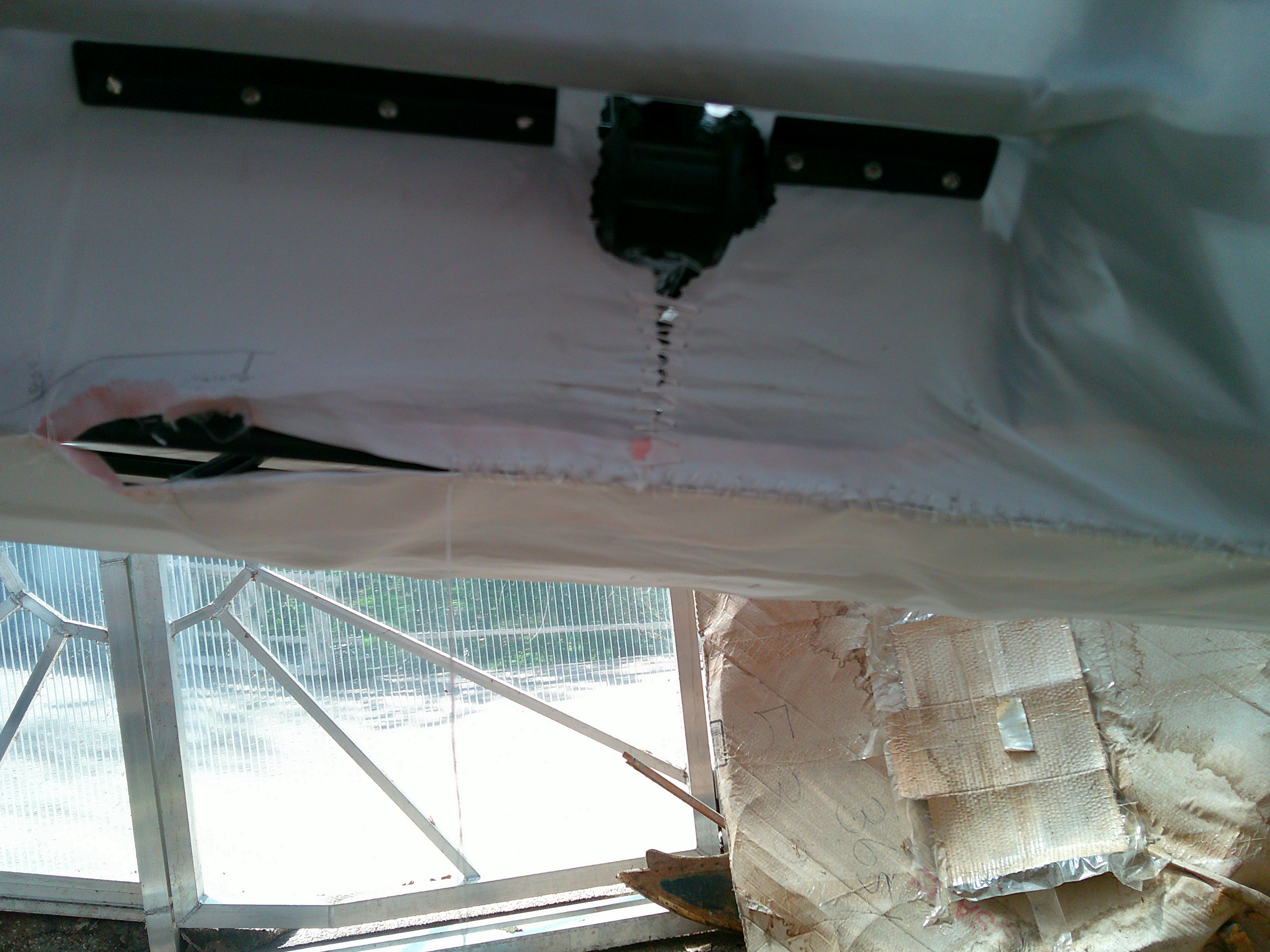

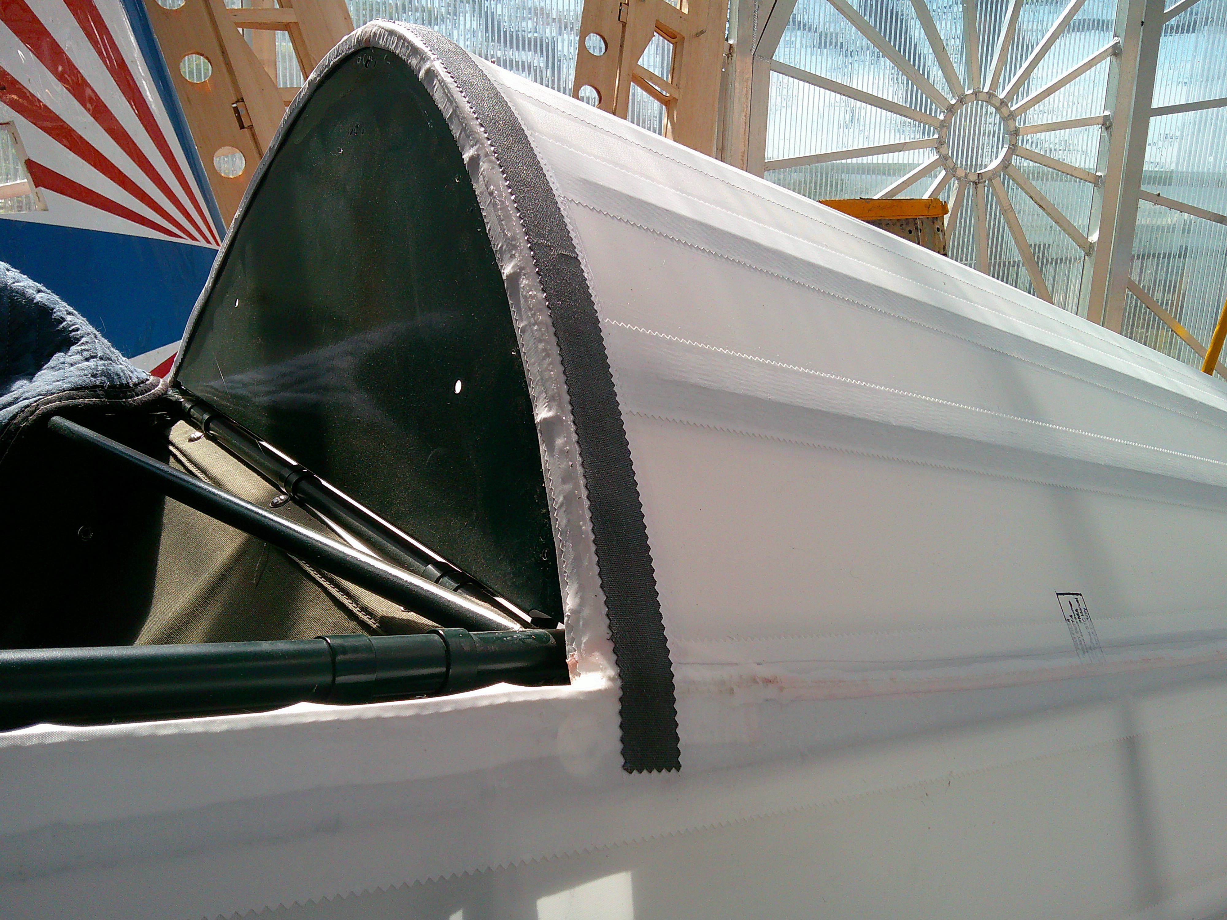

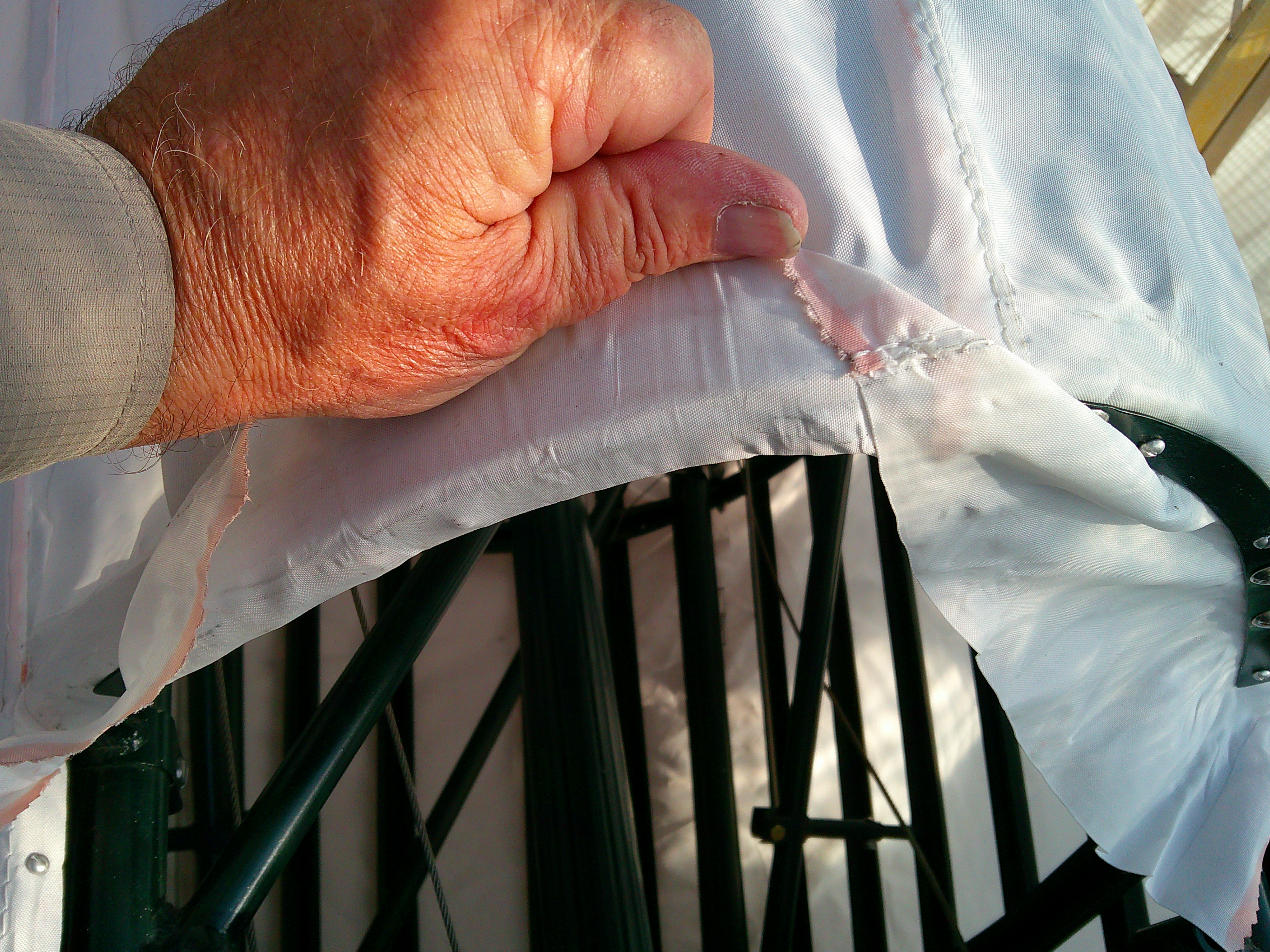

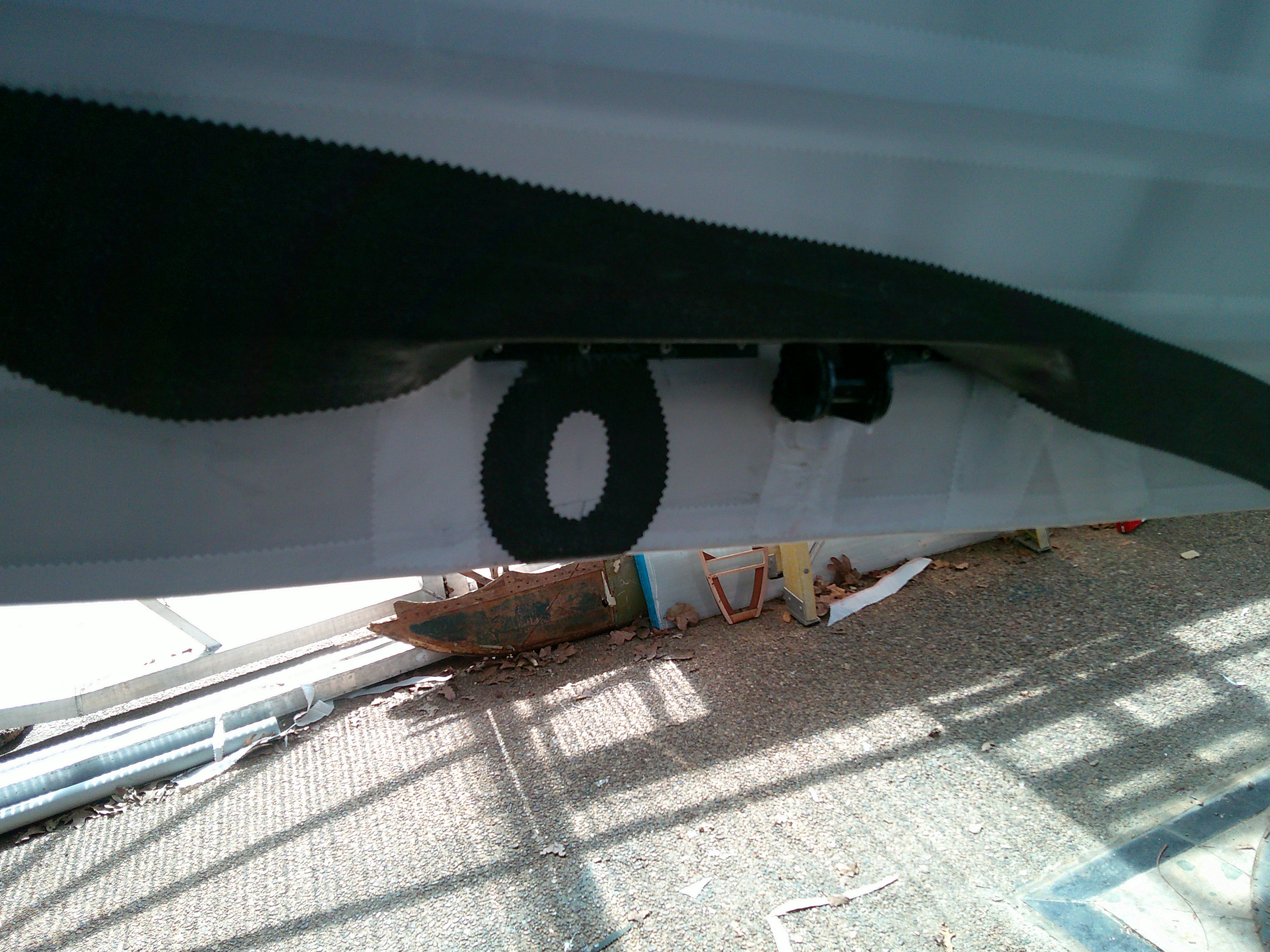

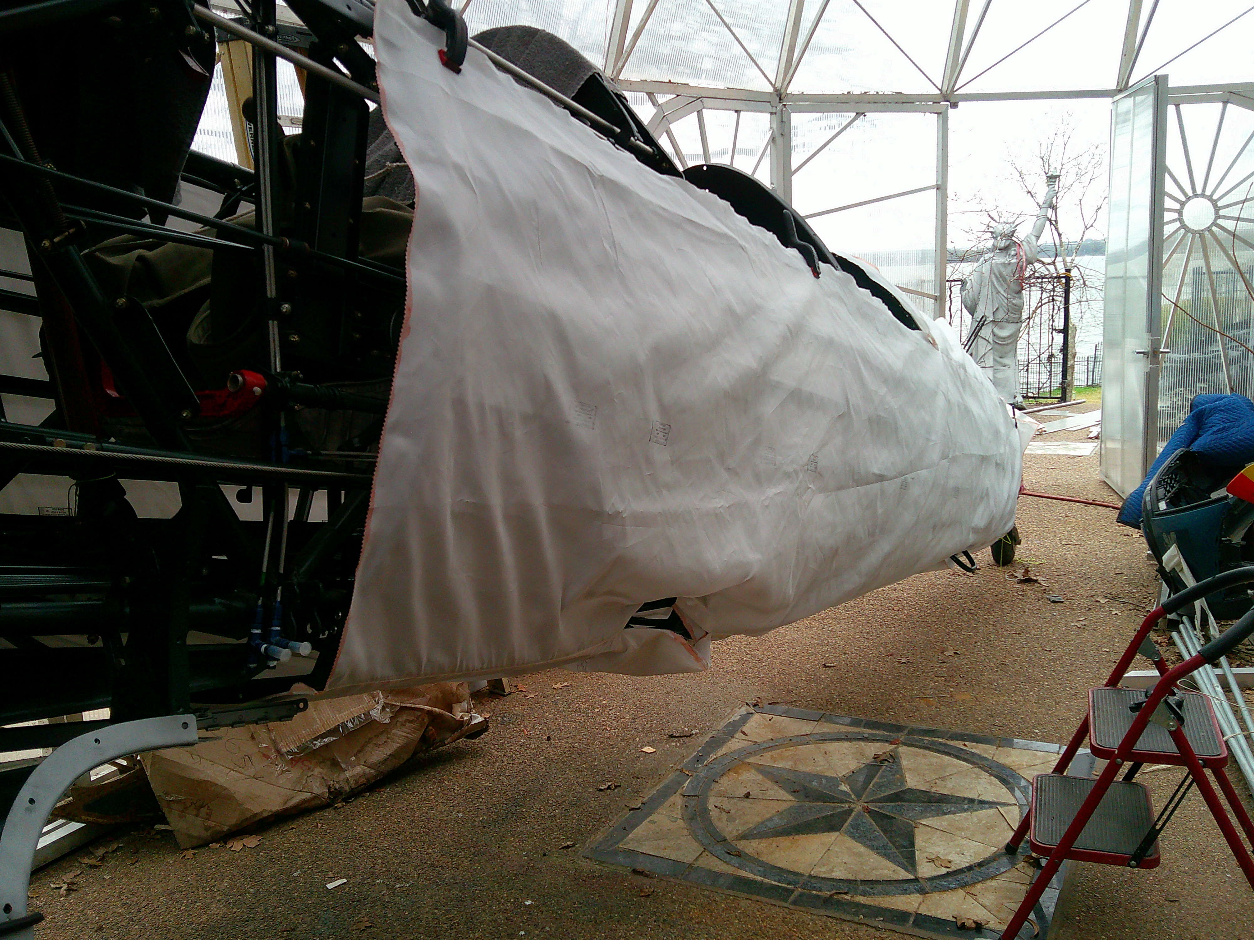

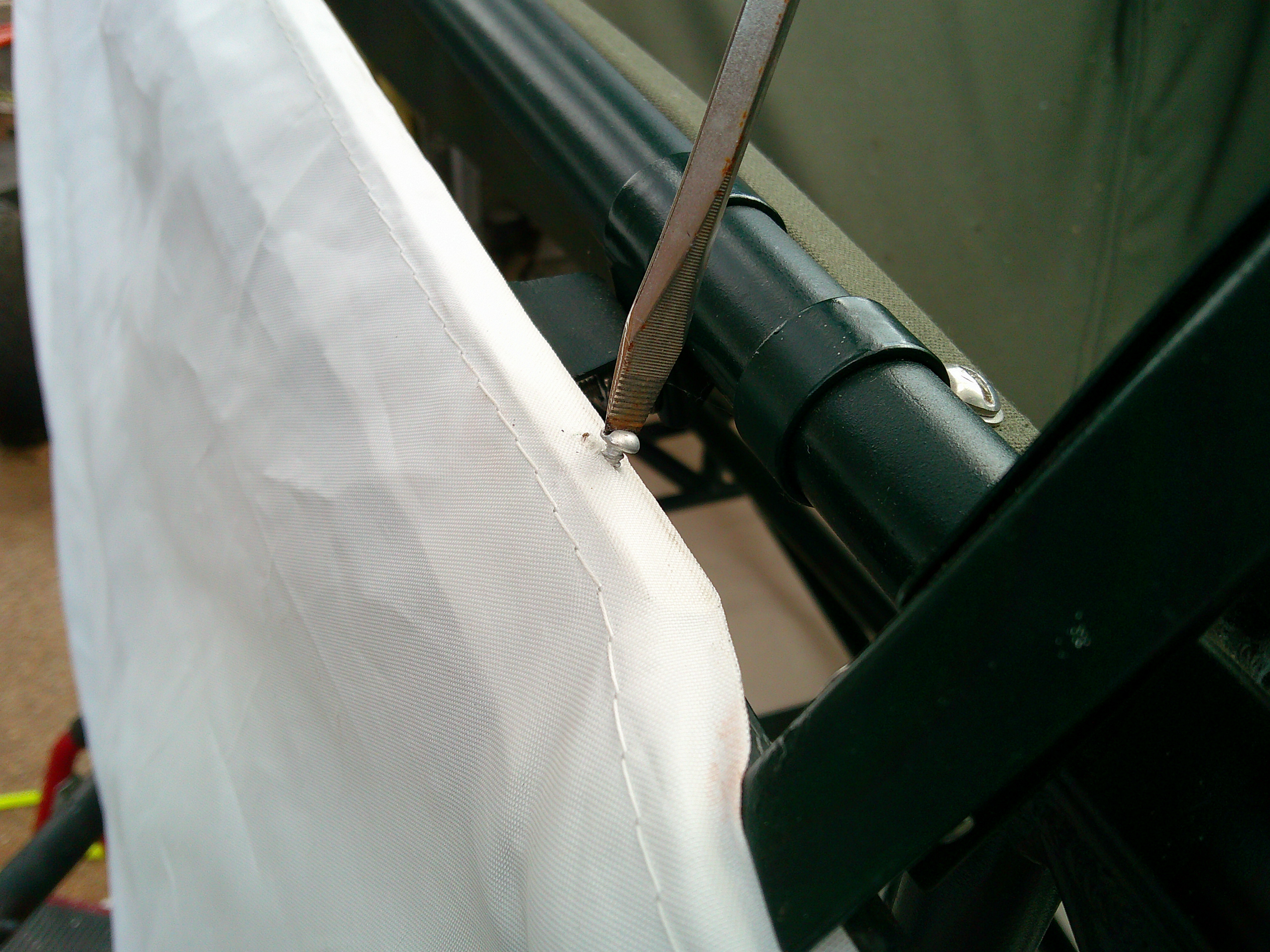

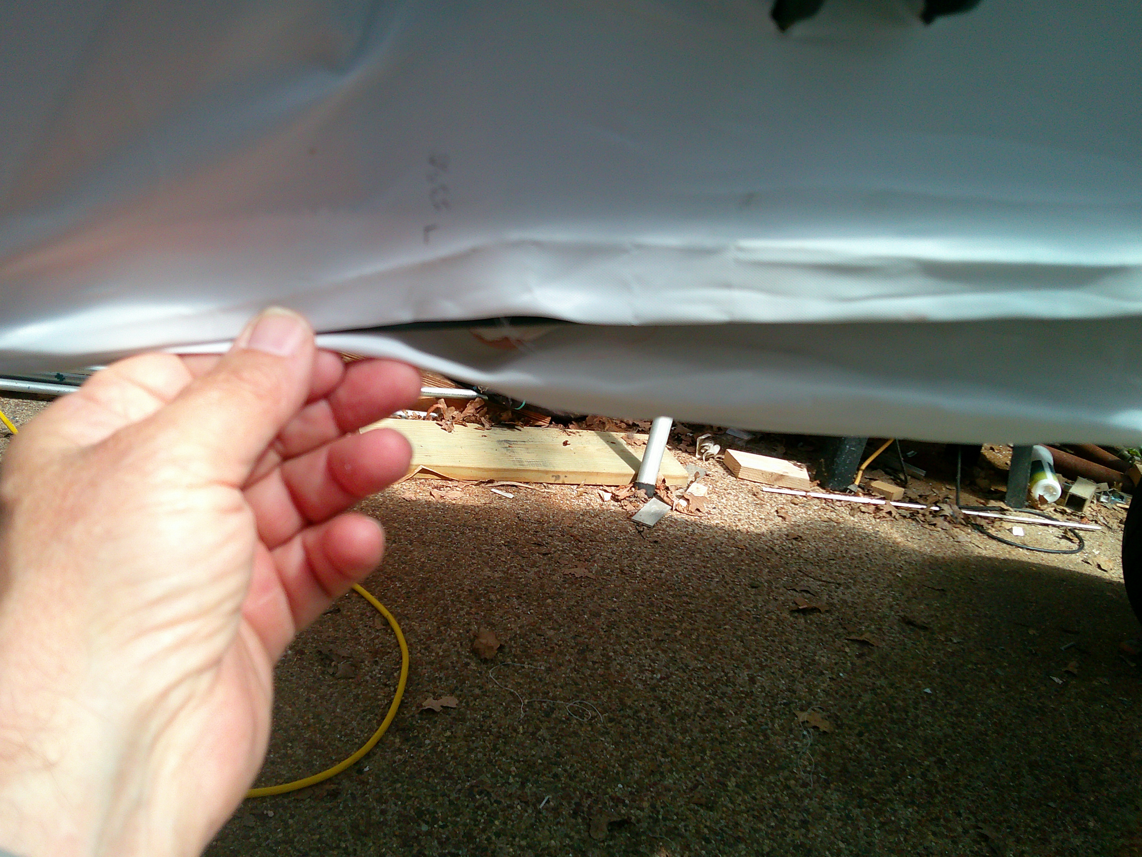

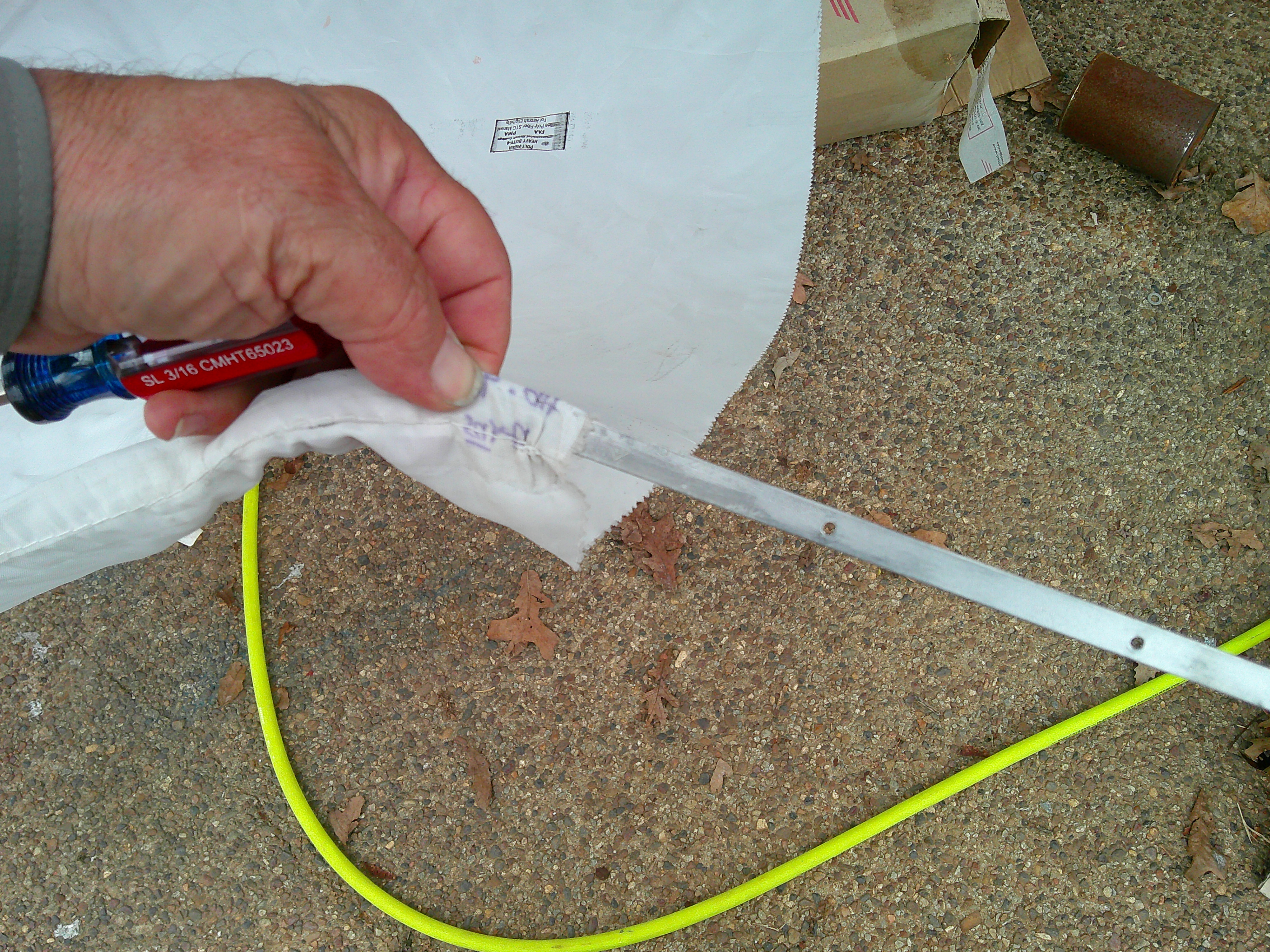

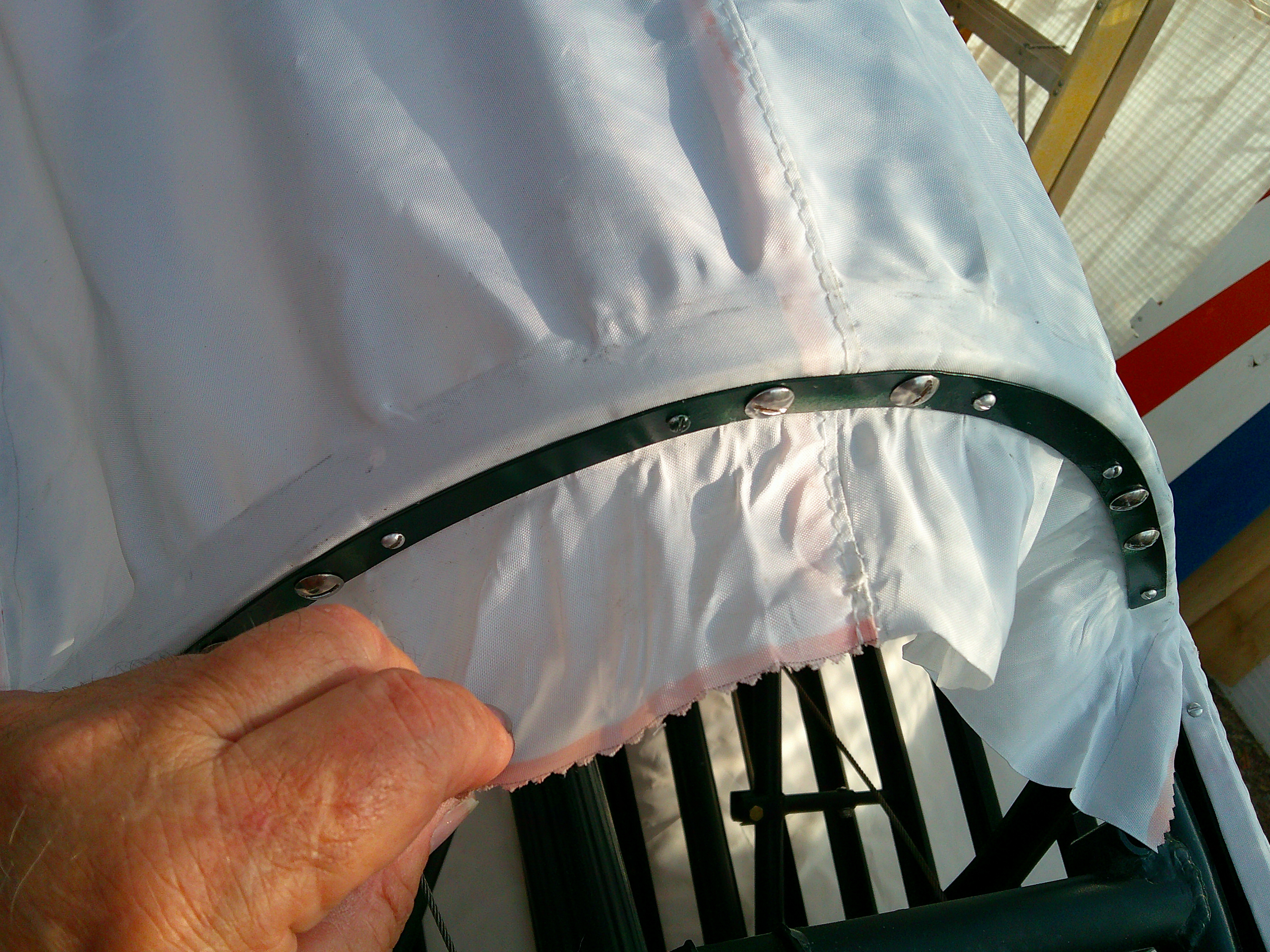

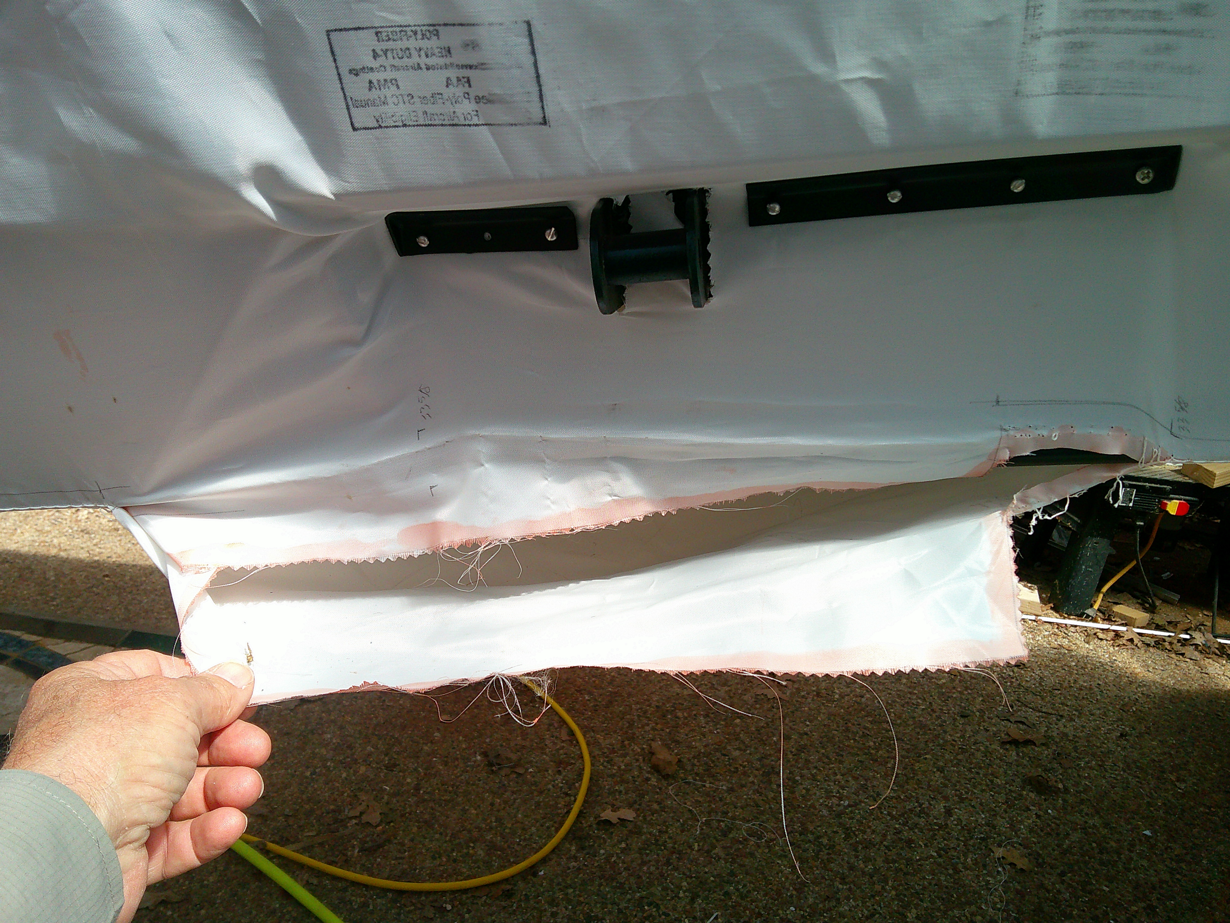

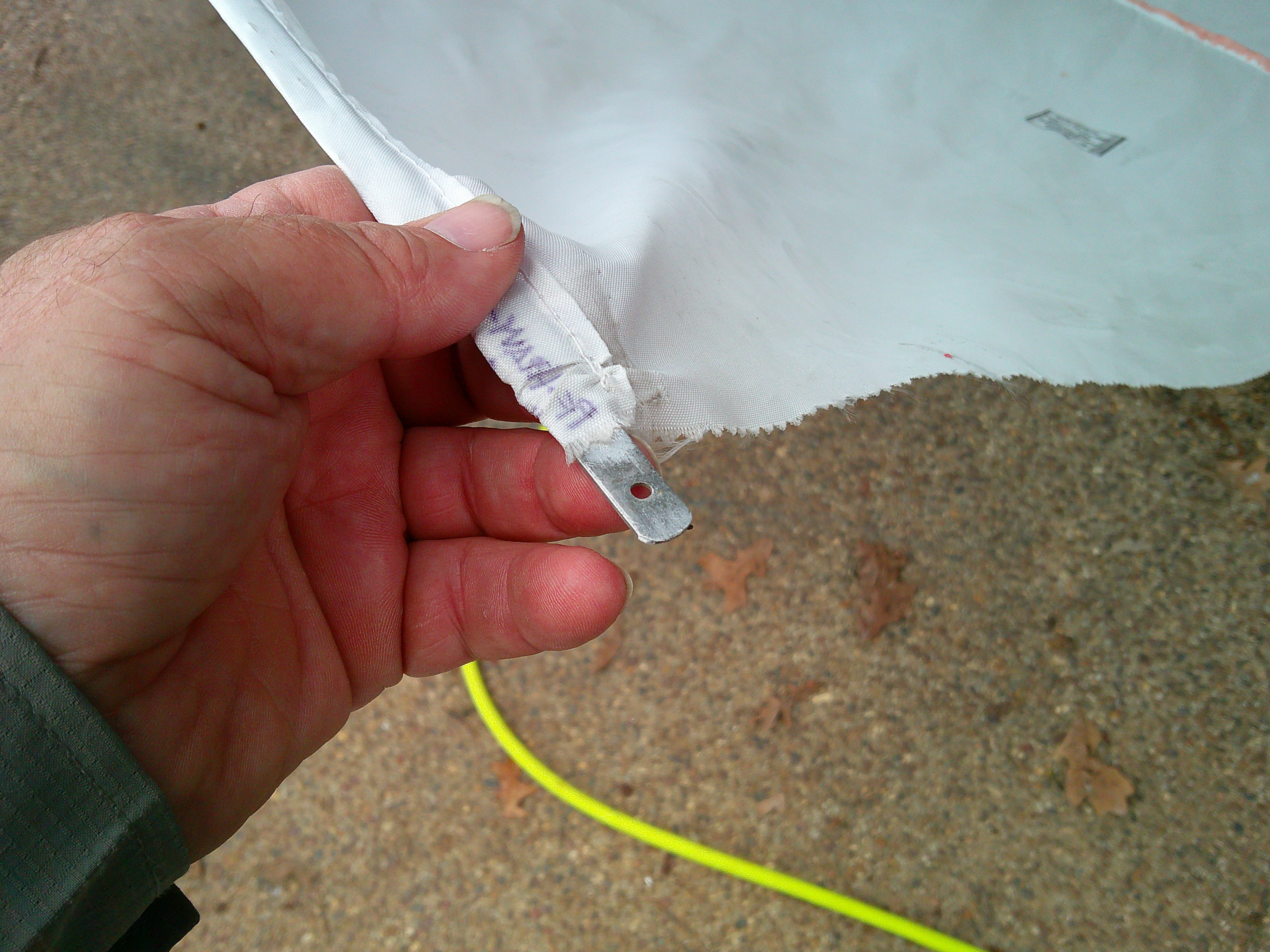

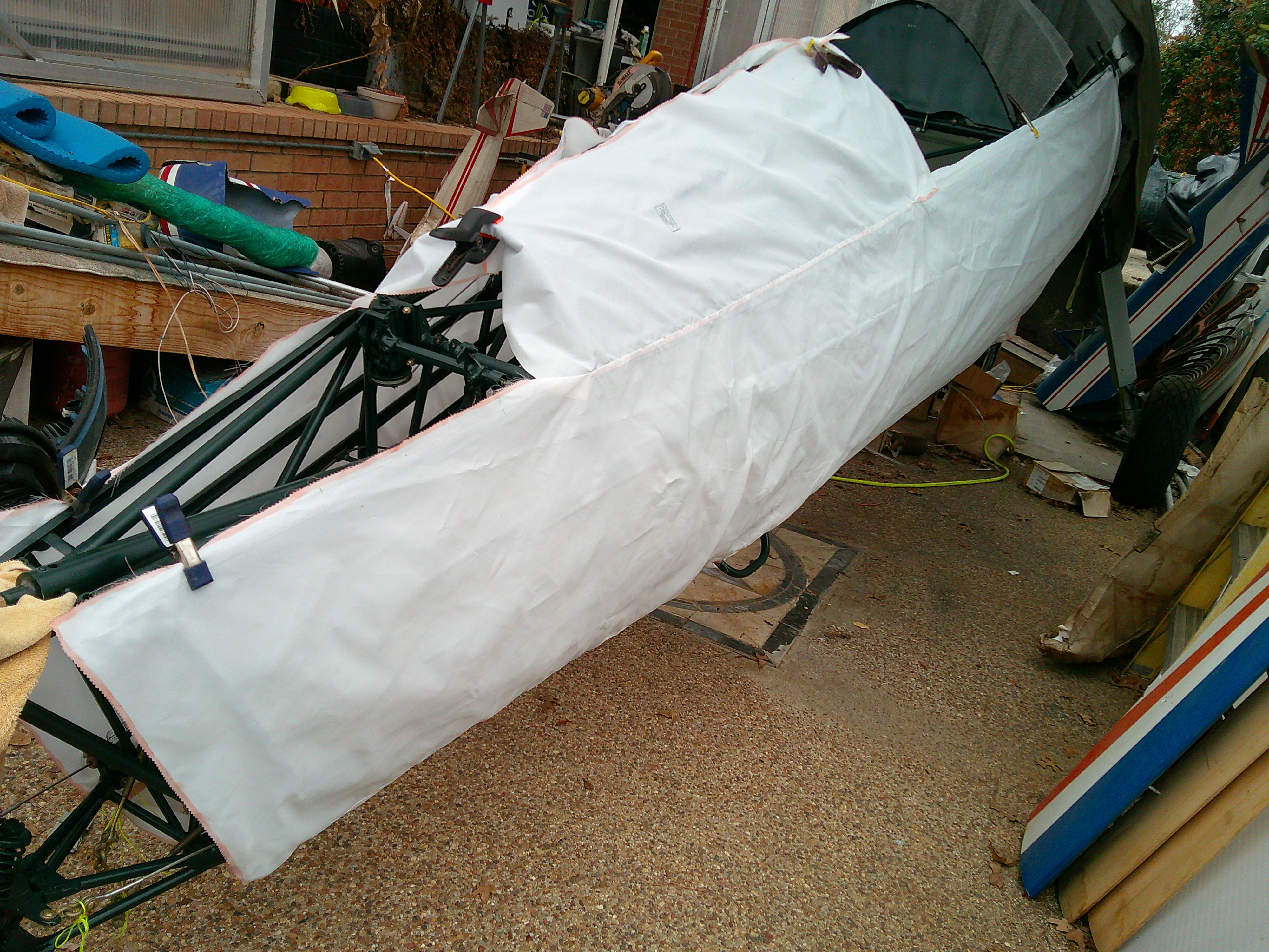

The fuselage fabric is sewn together from 5 patterns given in the blueprints. I worried there would be a fit issue, but that was not the case! The blueprints were spot on. The envelope is trial fit in the first pic, and then removed so thin metal strips can be sewn into the horizontal edges. The strips are then screwed down into the frame...or "bird cage". The ends are handled a bit differently. Here, the aluminum stips are screwed over the fabric to hold it in place. Then the fabric is rolled back over the retaining strip and glued down.
Where the wing mounts there are plates that pull the covering inward, giving access to the mounting eyes. The openings are then stitched by hand using a baseball stitch. My stitching was not neat, but fortunately it gets covered with fabric tape, so will not show...whew!

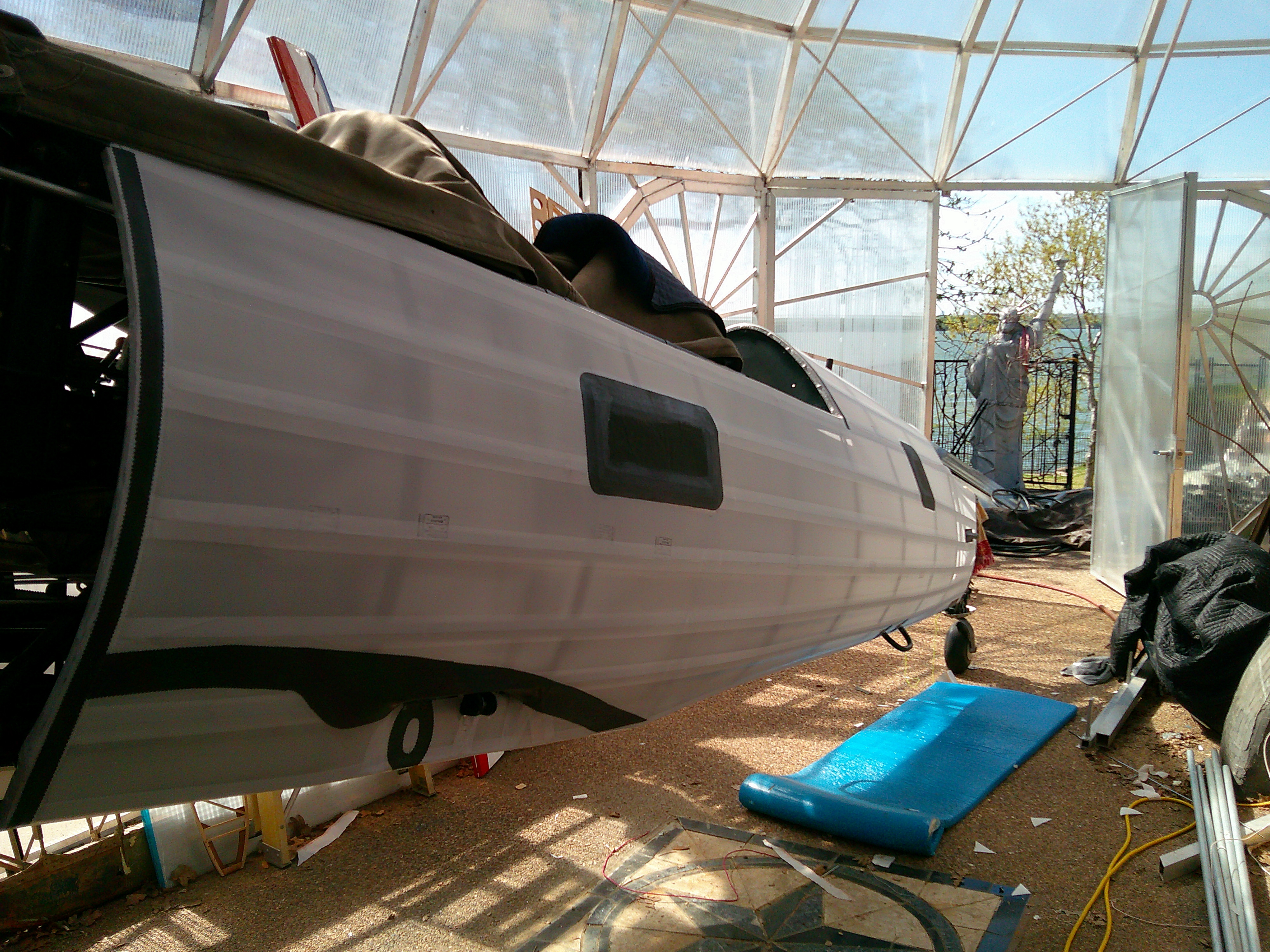

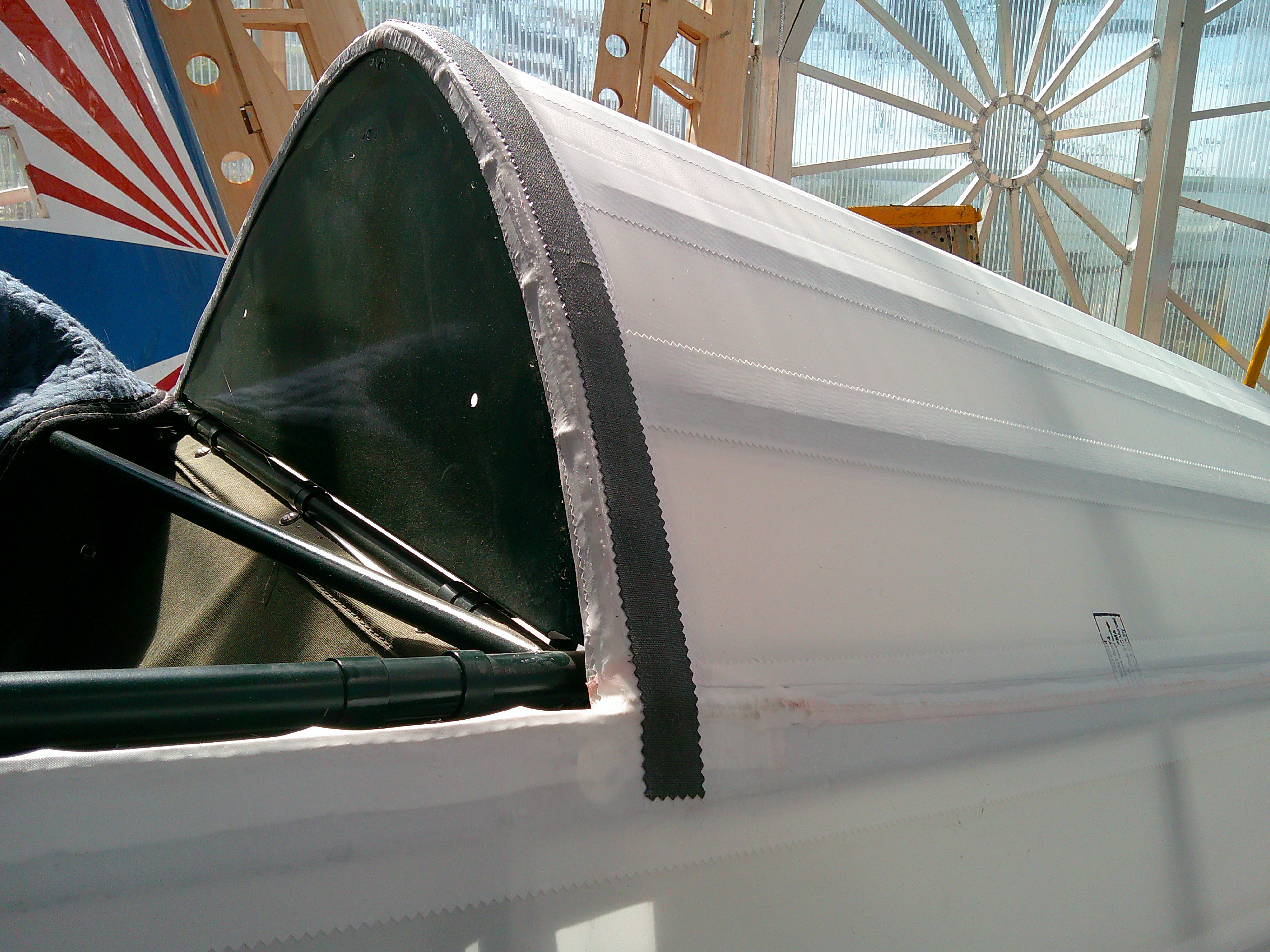

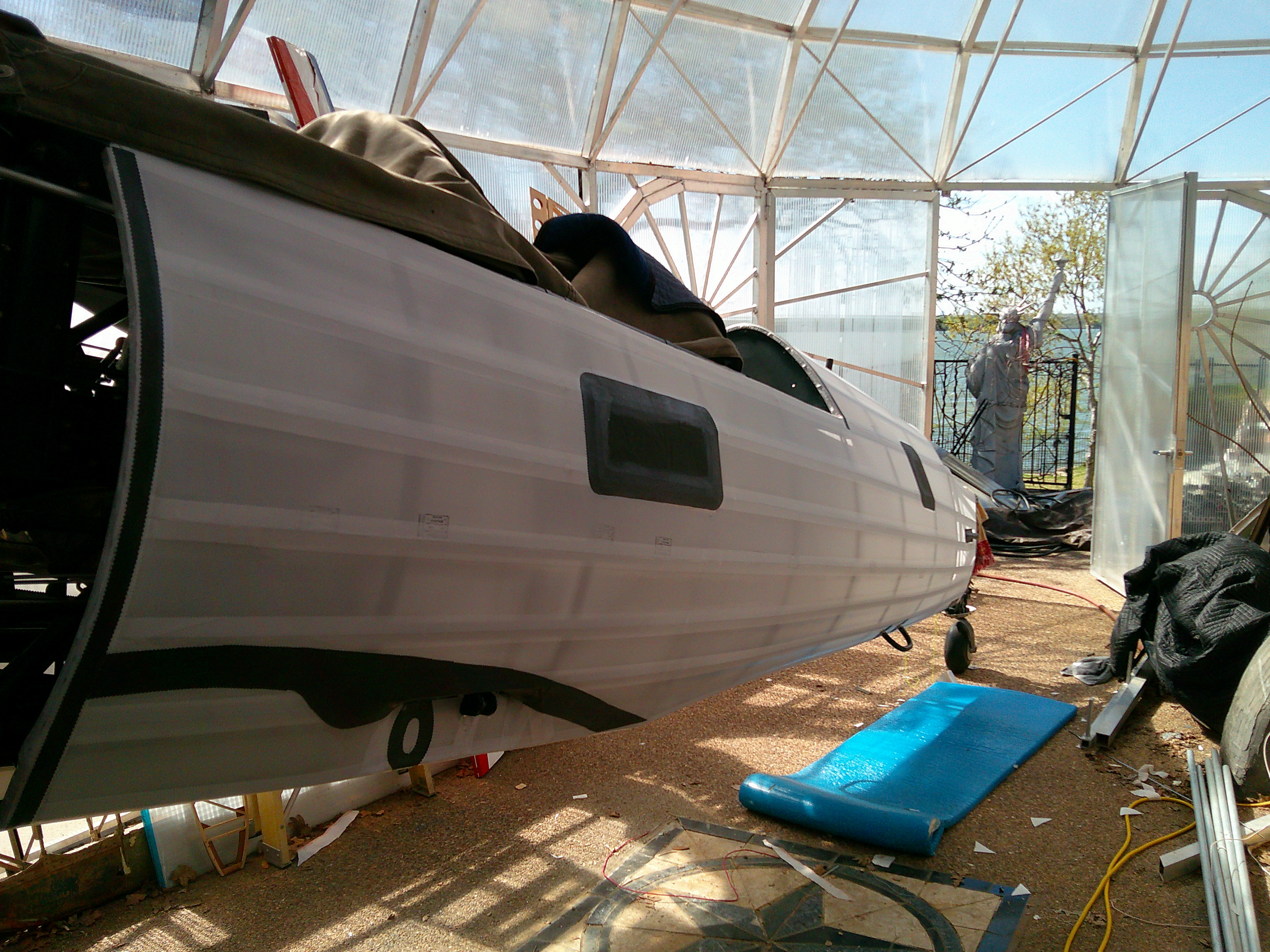

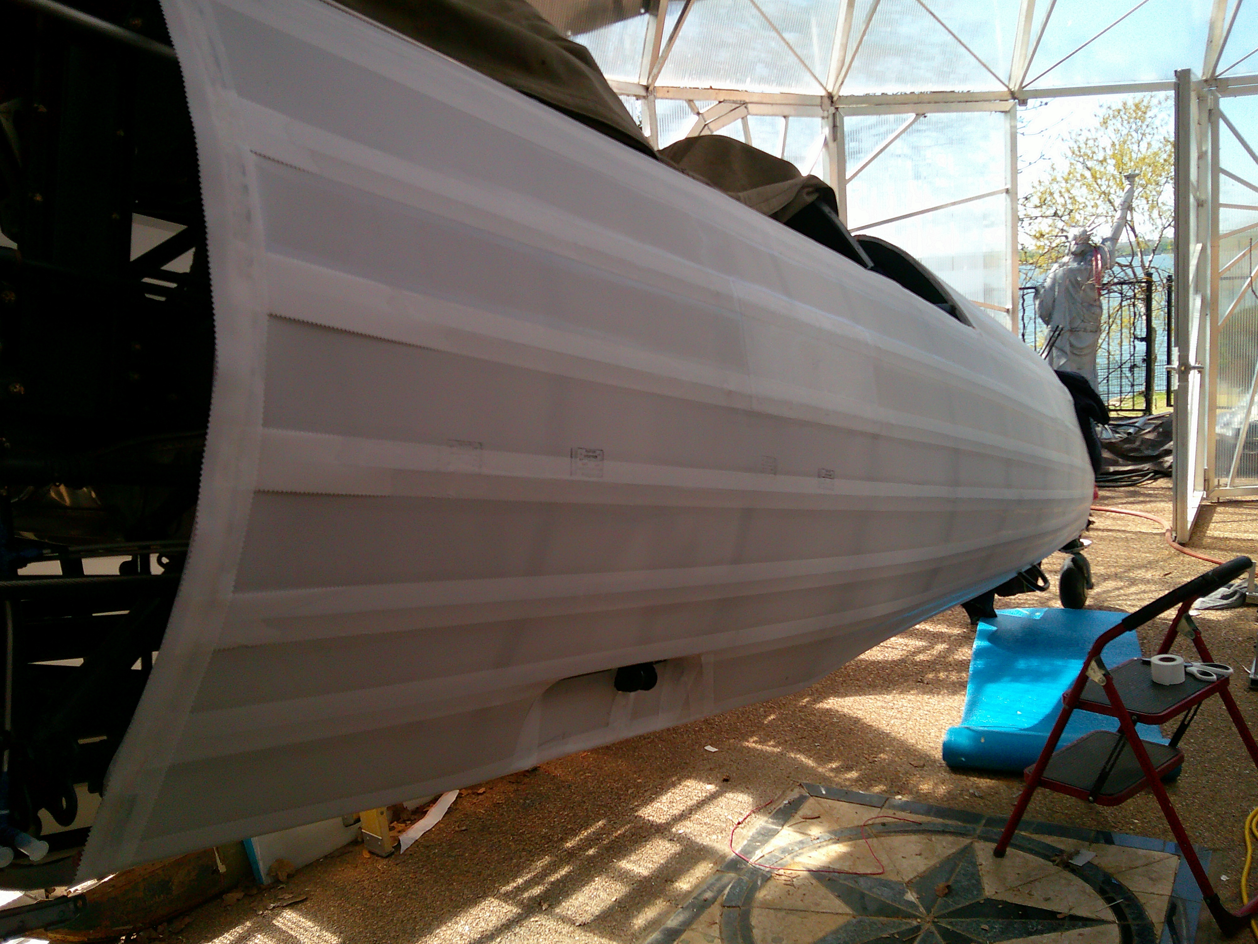

I am sure you have noted that the wings and tail were pinkish colored. It is considered a bit un-manly (no offense to the ladies) to see pink inside the cockpit. So the fuselage is shrunk to fit, and then an un-tinted sealant is used for a more acceptable color in the cockpit.

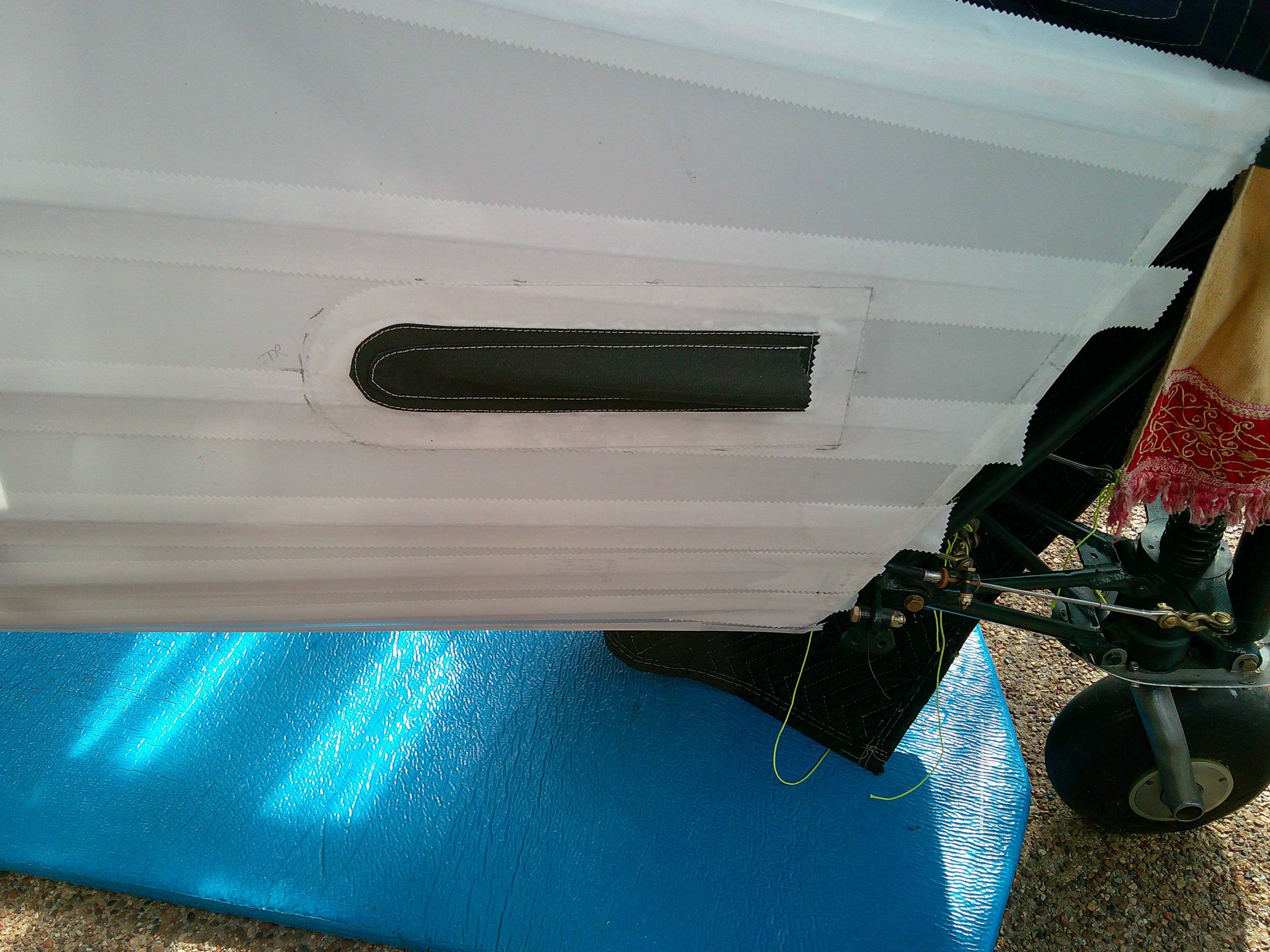

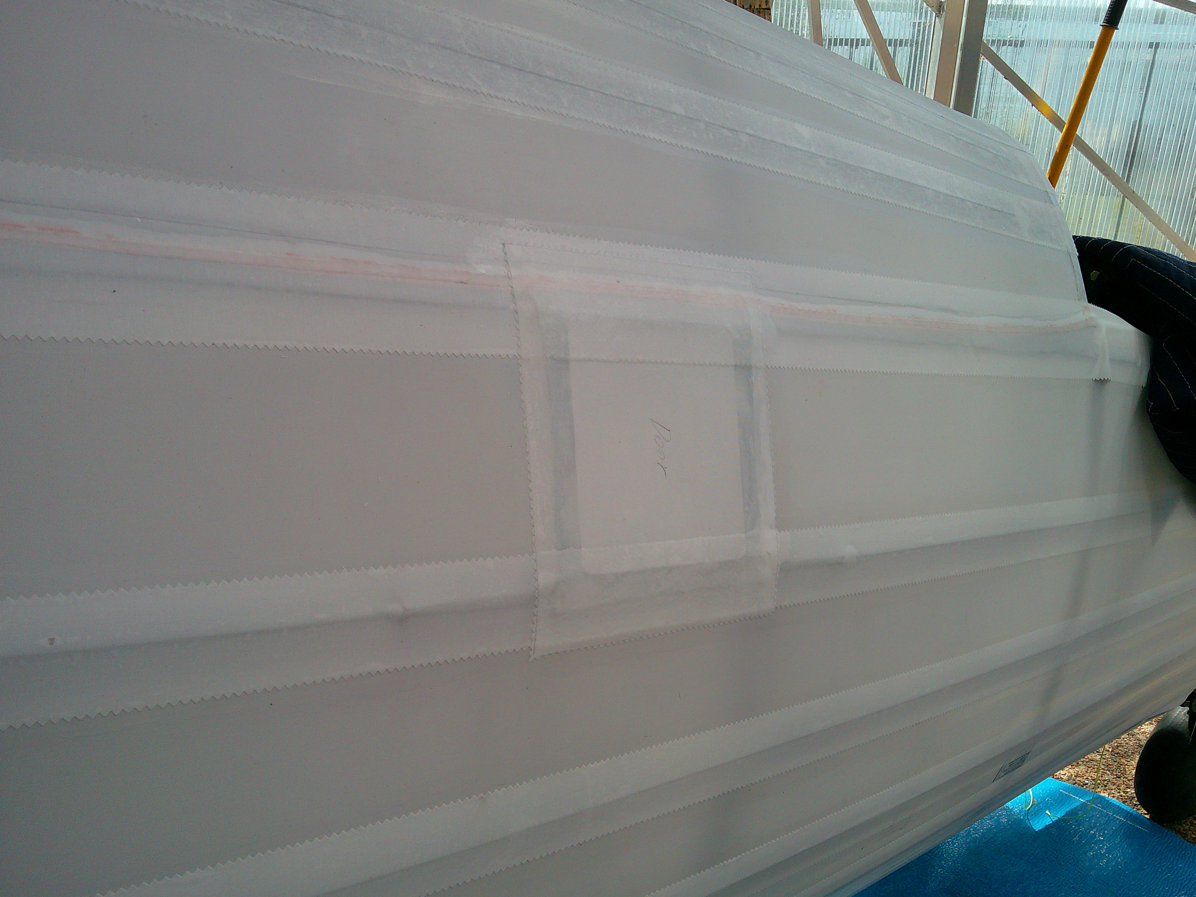

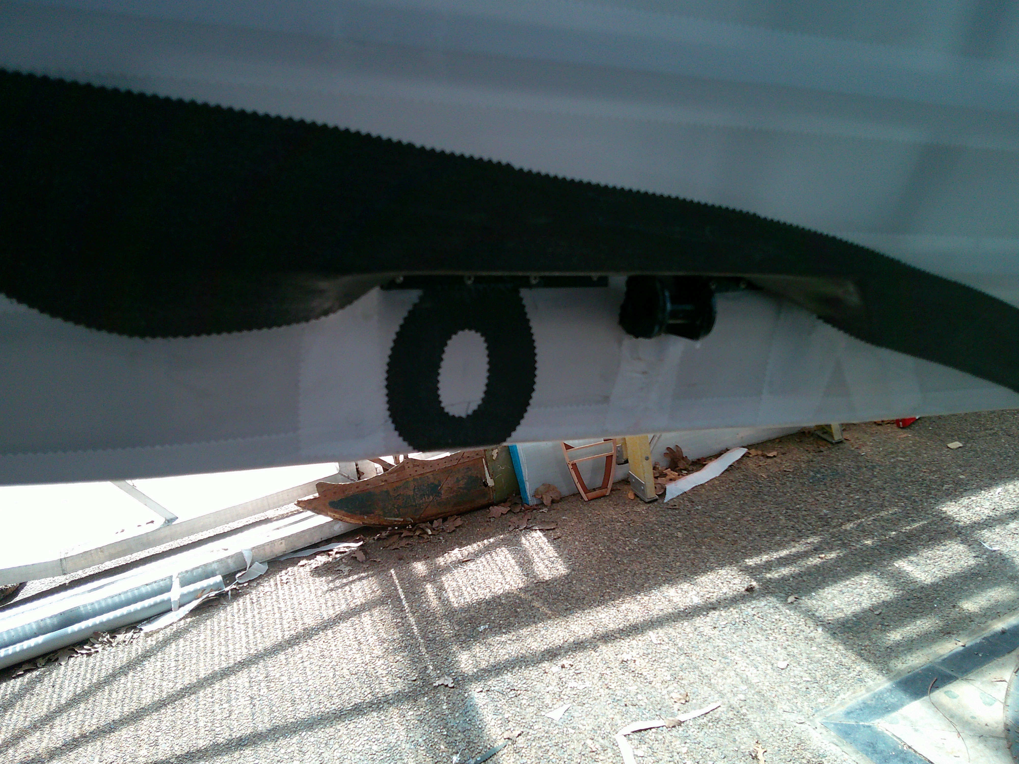

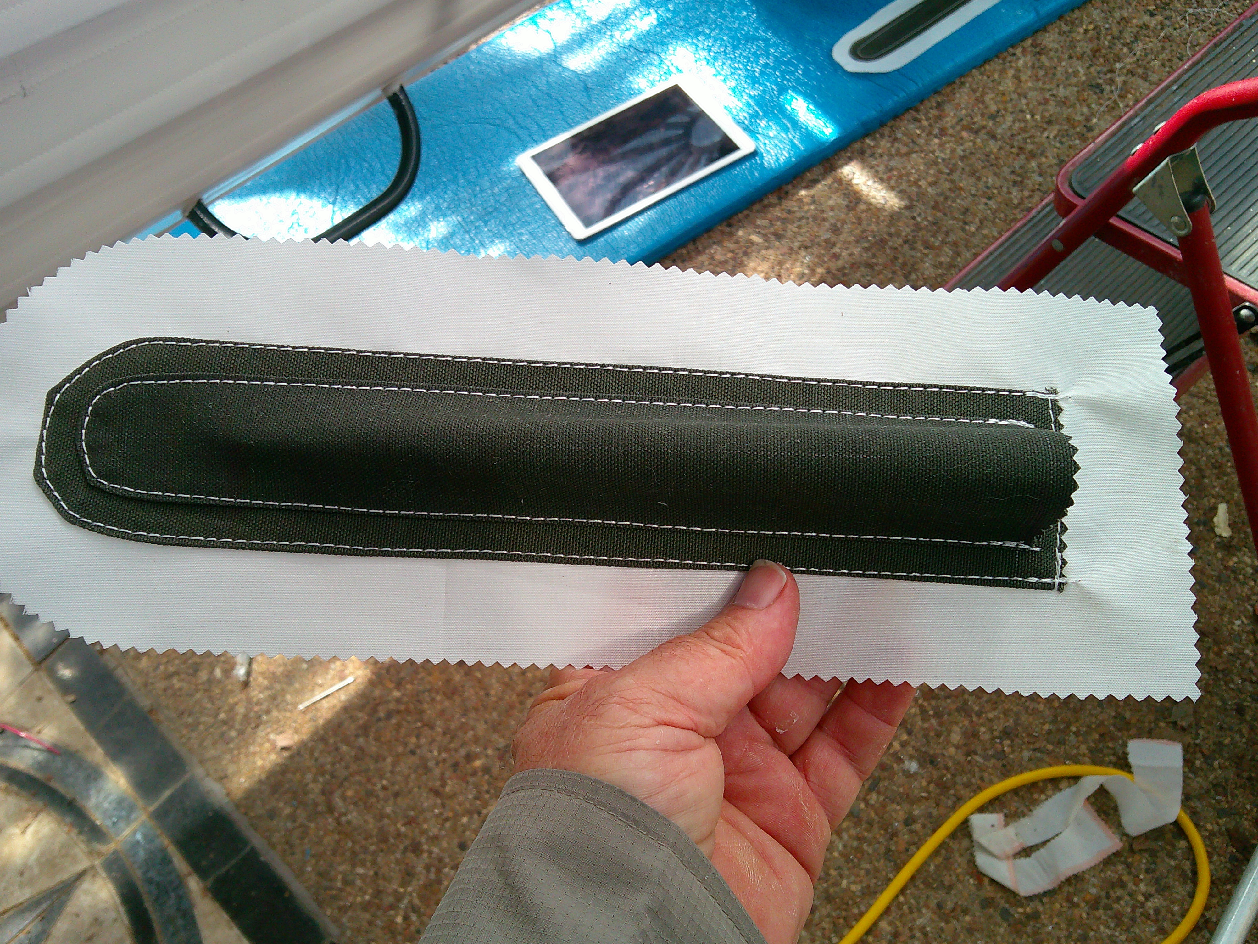

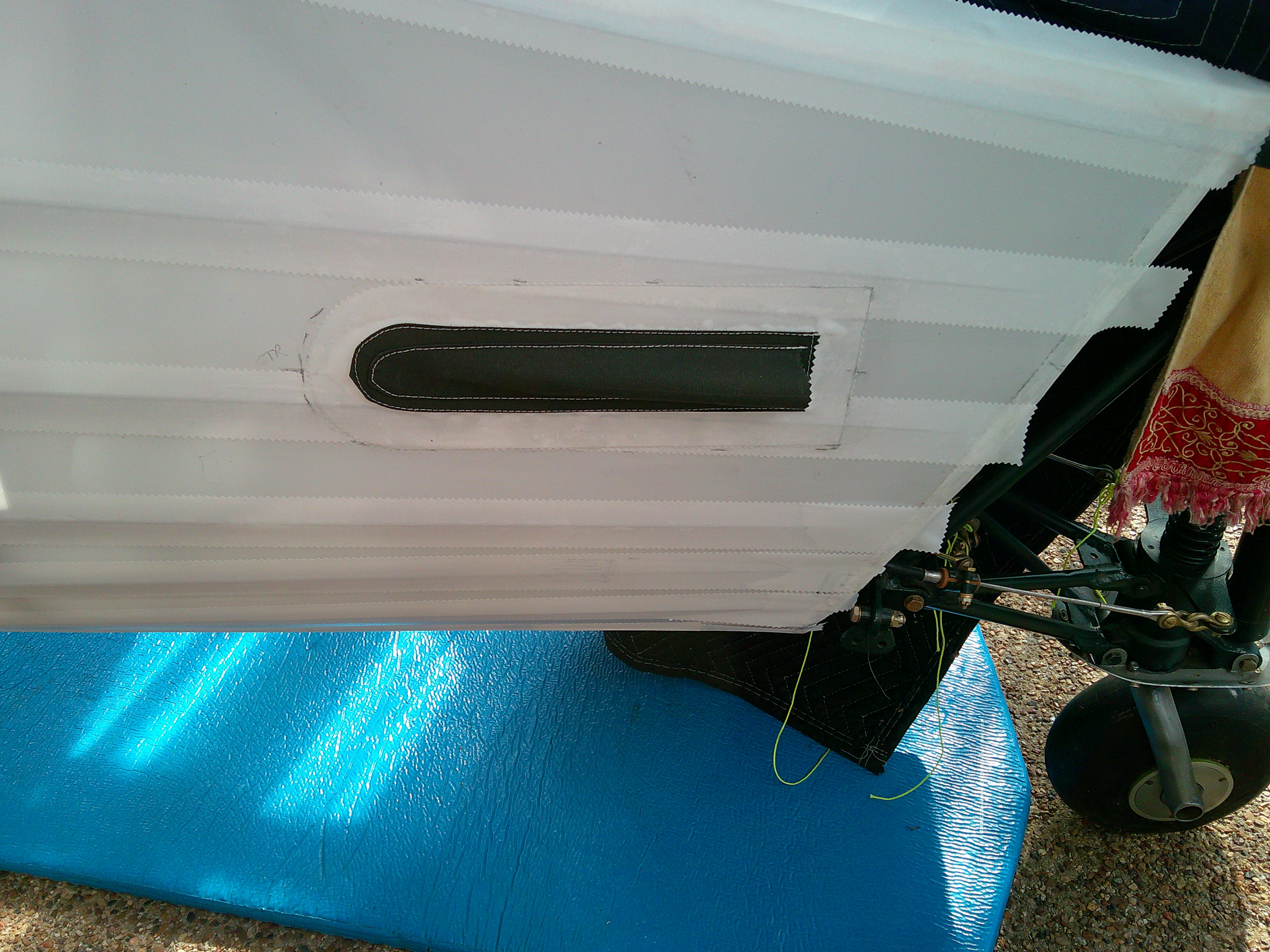

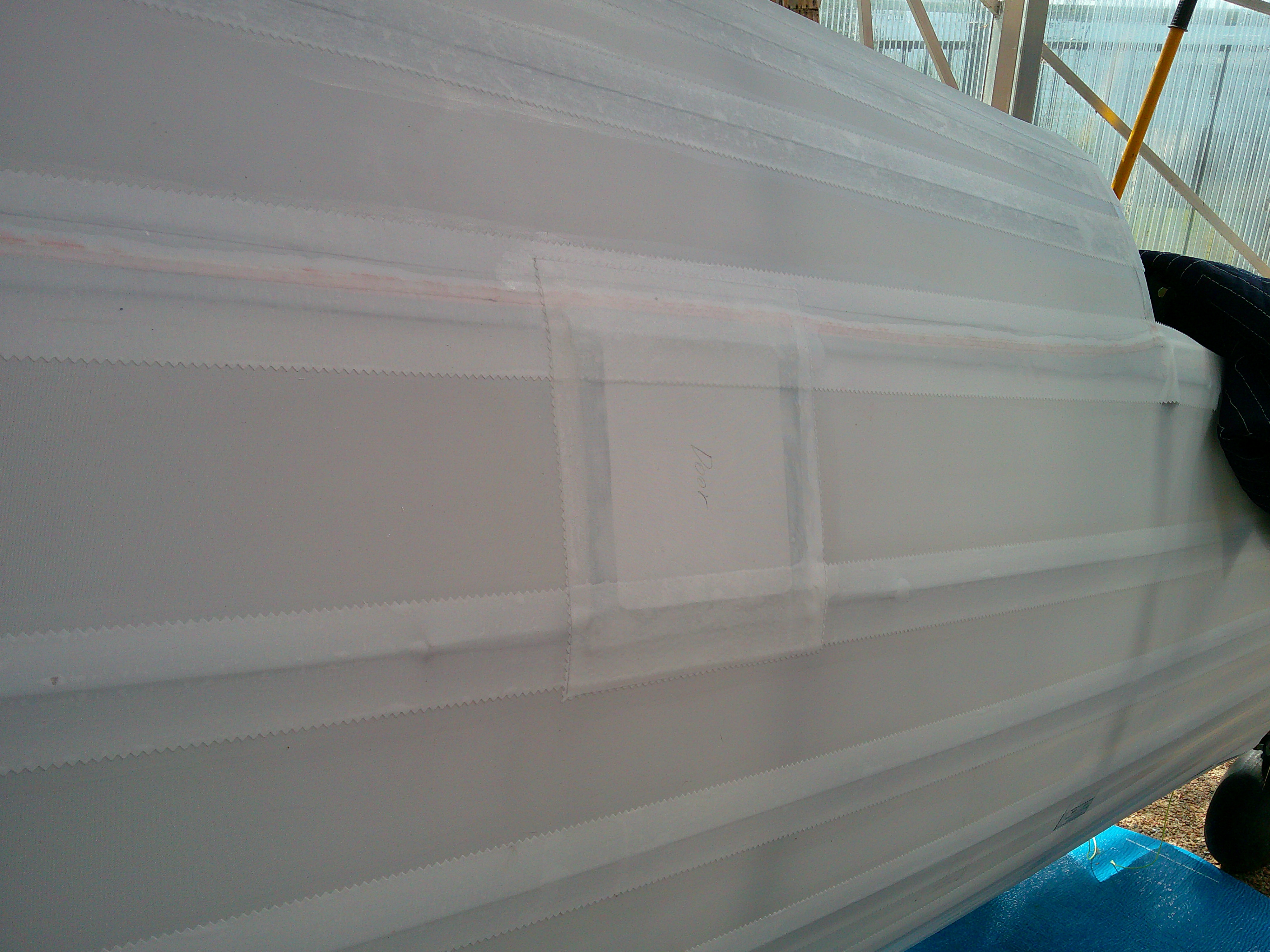

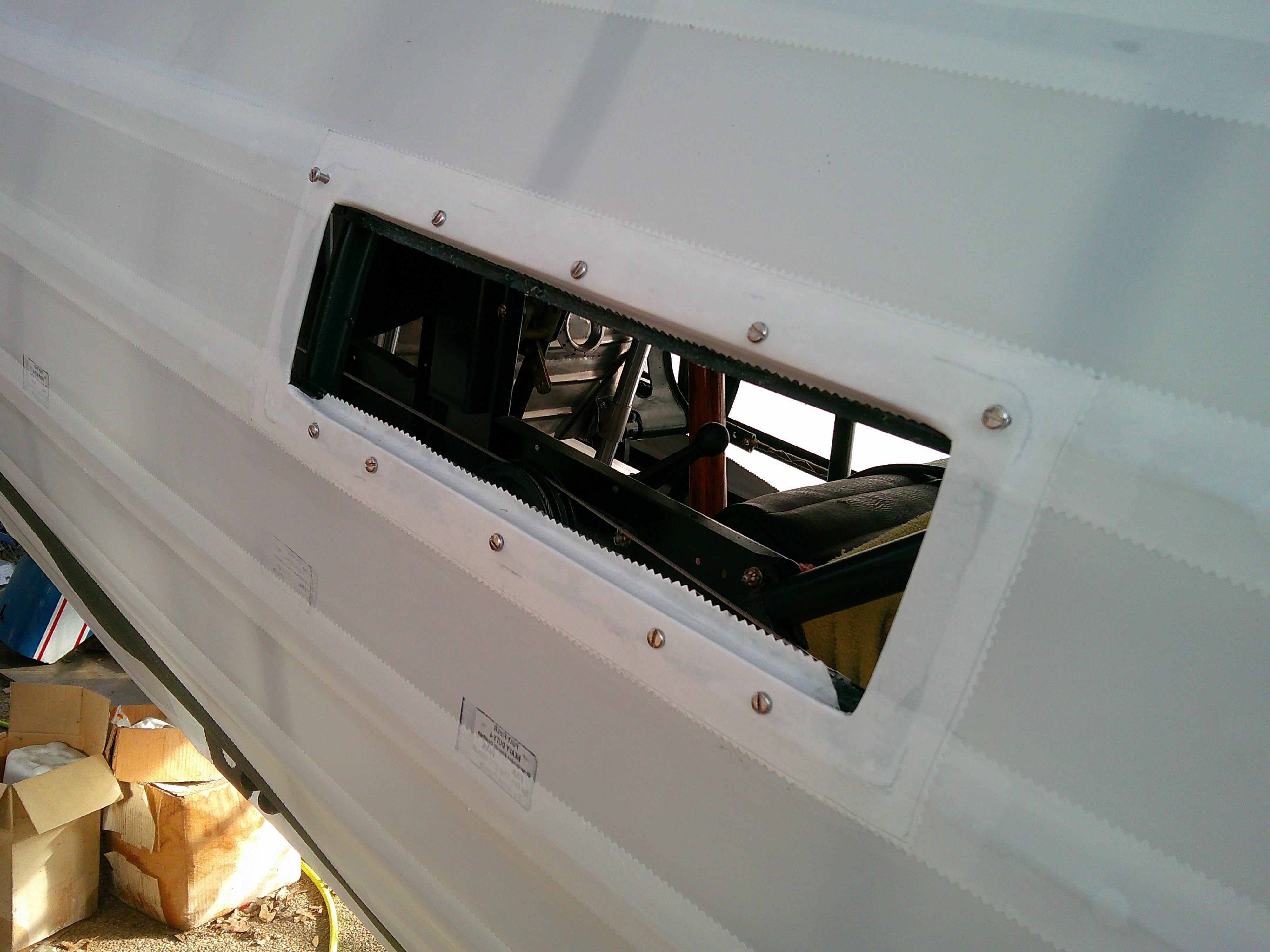

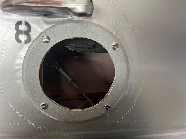

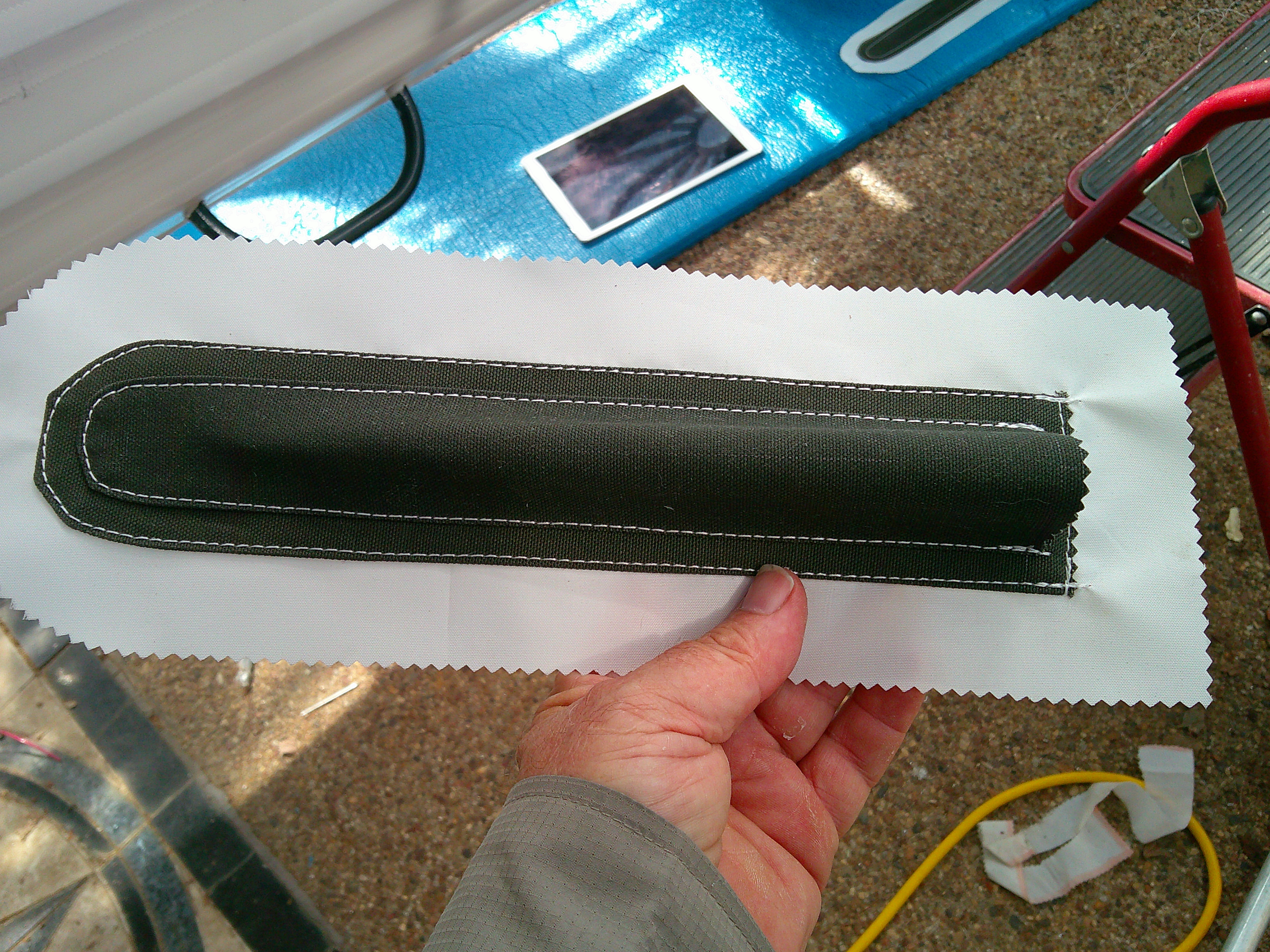

Once the covering is shrunk tight, then the frame strips are taped over so they won't wear through. Patches are added for doors and then canvas patches are added at all heavy use areas. The doors are for a fire extinguisher door and an access door for the elevator trim. The cigar-shaped canvas is where the rudder cables have to exit the fuselage to go the rudder horns.

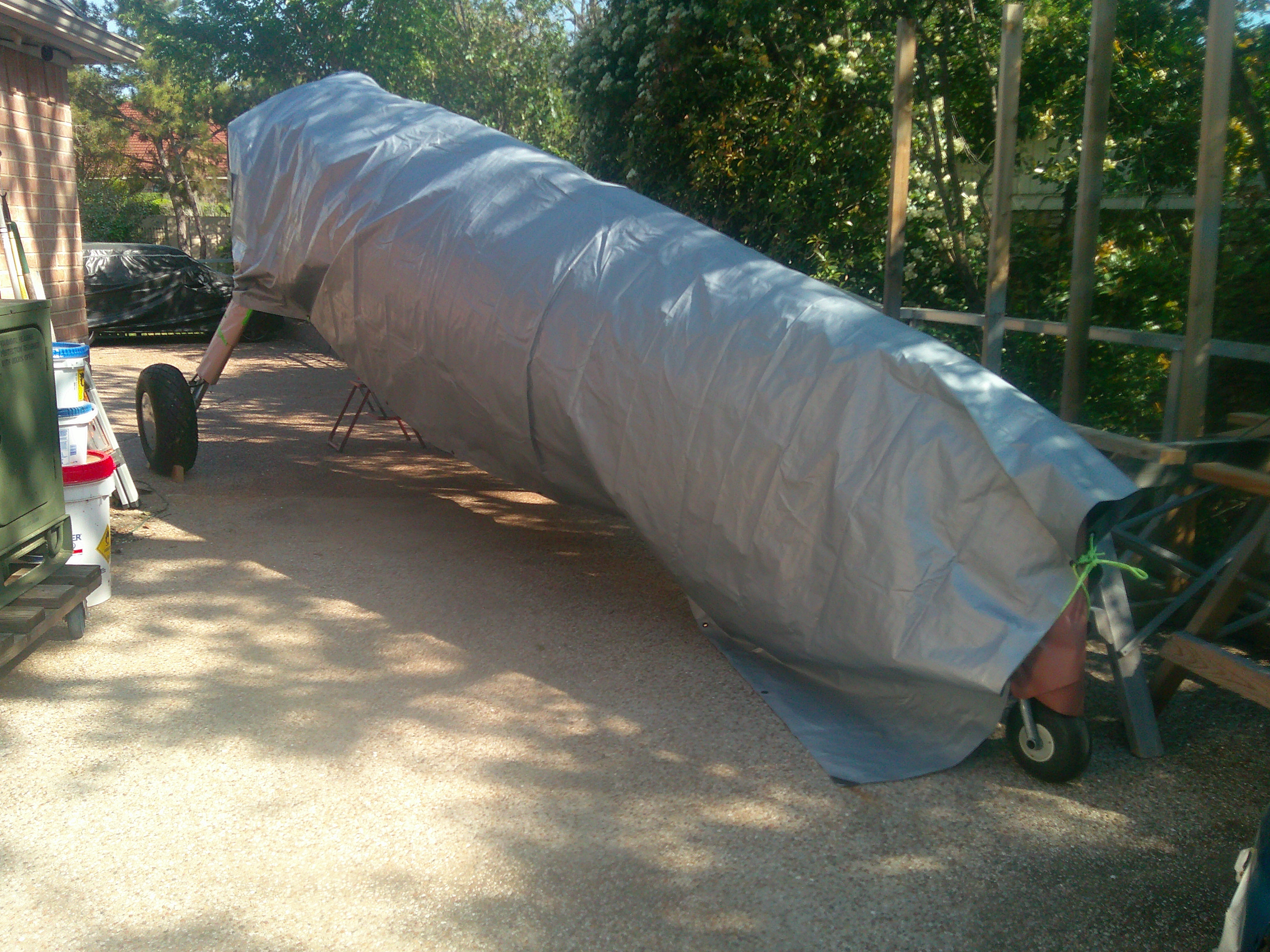

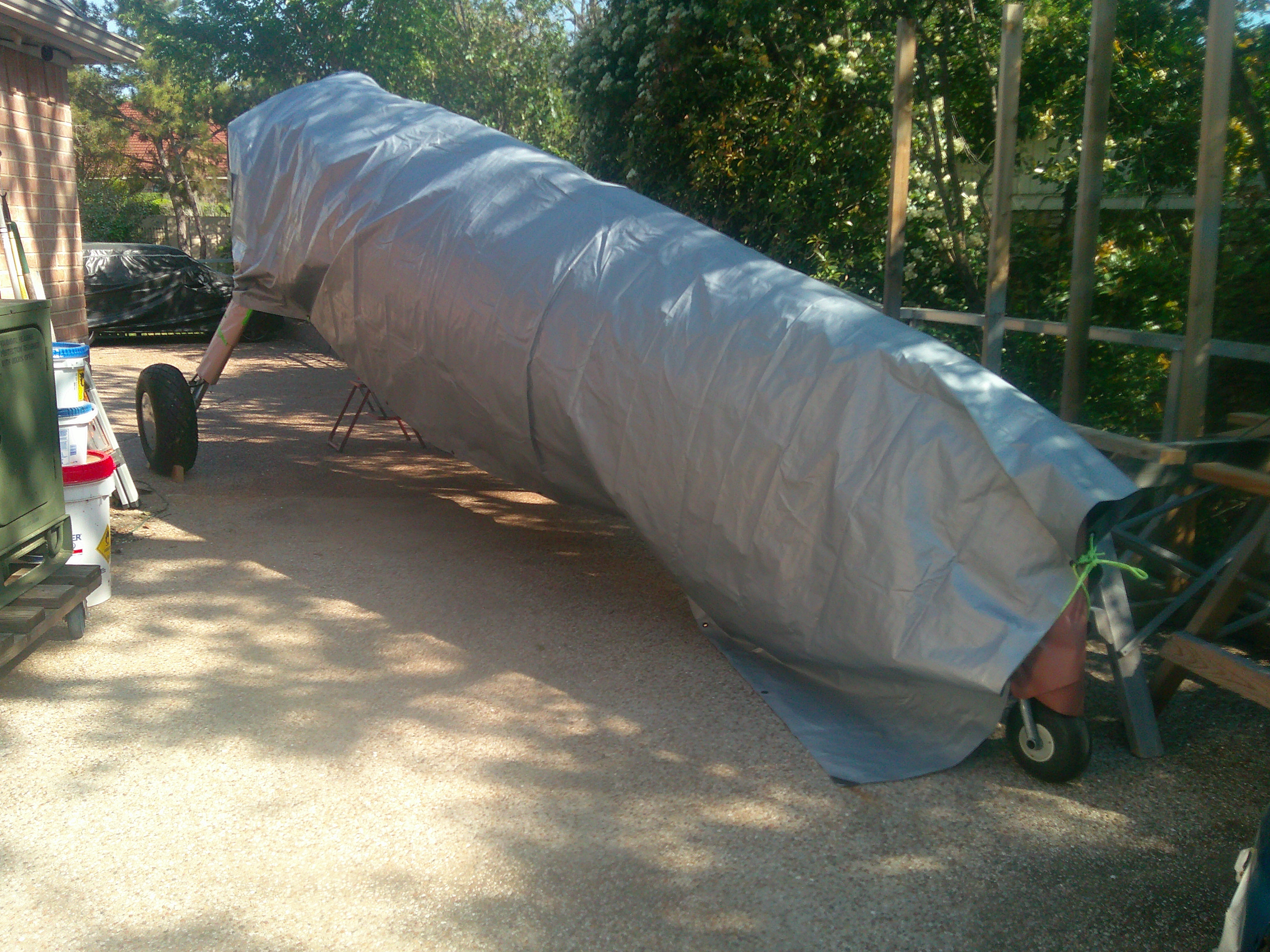

With the covering installed, it's time to pull the fuselage out of the Wife's greenhouse to start spraying coats of sealants. Now I need 4 good temperature, low wind, days to spray, and the fuselage will be ready for final assembly!
