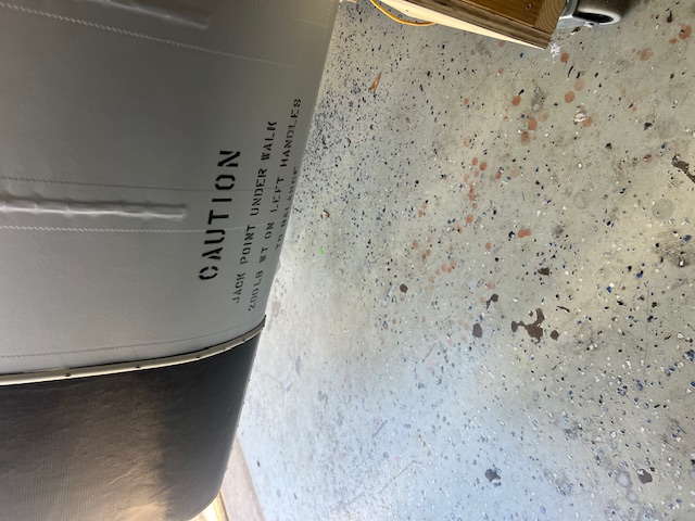

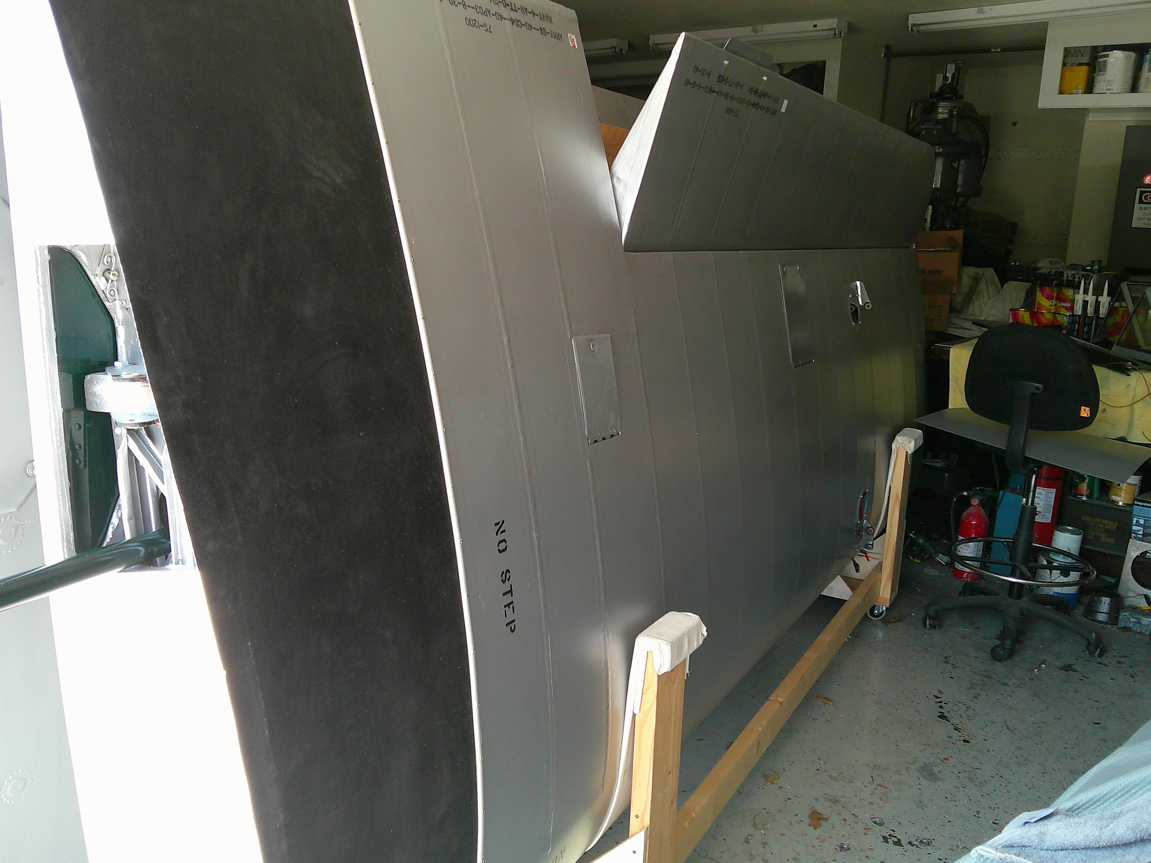

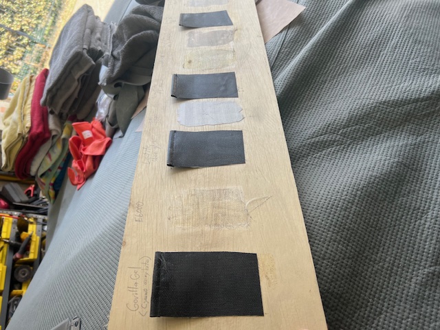

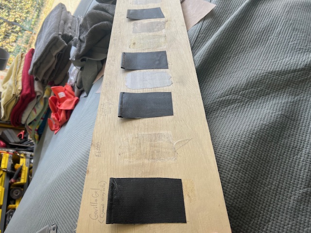

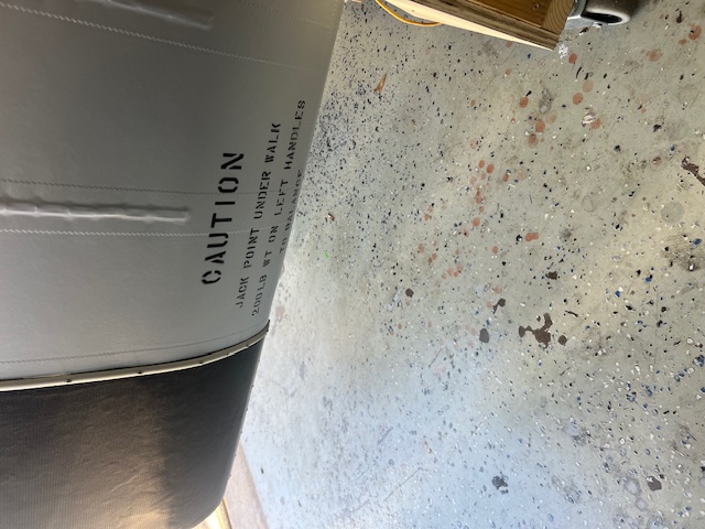

One little side project was the wing walk. The OEM spec is for a "rubberized canvas", which is not available any more. Not to mention, rubber does not survive direct sunlight very long. After sweating this for many months, I stumbled on a blanket of silicone rubber coated fiberglass cloth that welders use. It is impervious to UV light, has the exact texture pattern of rubberized canvas, and will not burn in temps up to 1800 degrees...perfect! Well, almost. Silicone is tricky to glue. So, I set up a test board using all the glues sold at Home Depot. I glued down patches, threw the board down on the garage floor and walked over it for a week. The winner? Loctite PL Marine. Best of all, it comes in a large tube, so one tube was enough for both wings. Bonus!

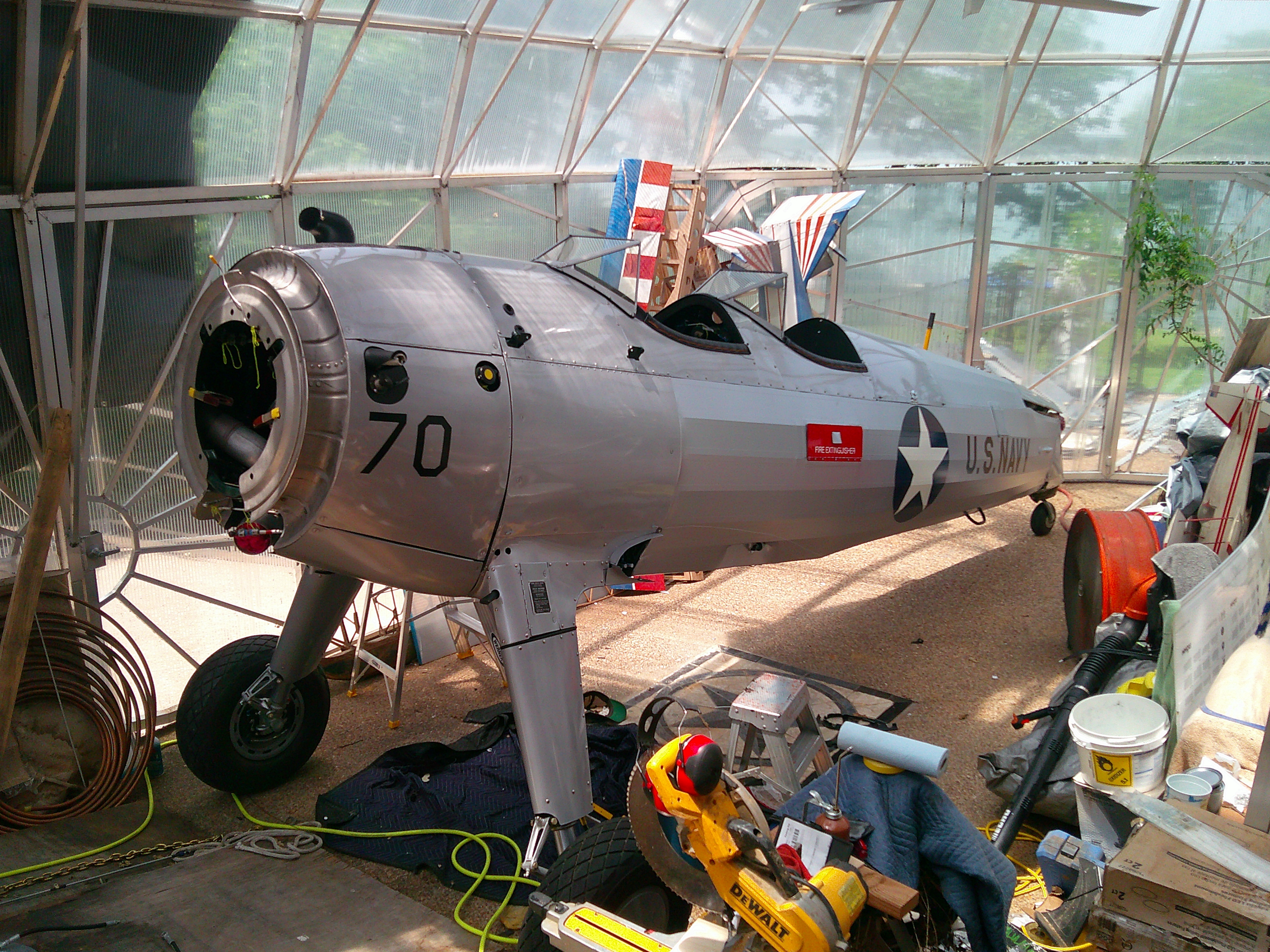

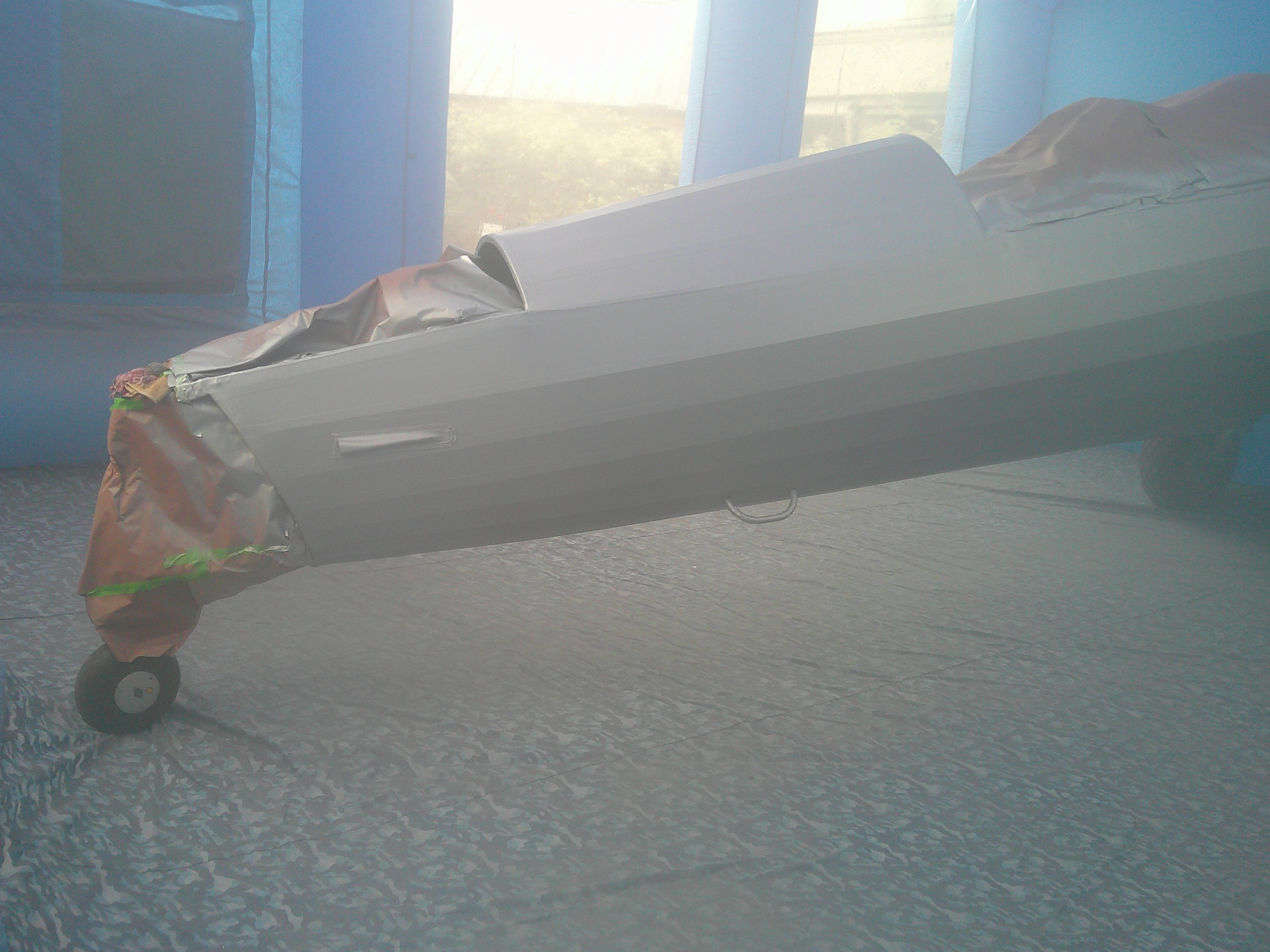

We are moving right along. I started covering the fuselage 2 months ago, but the wind and cold were working against me. It finally all came together, though, and the fuselage covering is finished.
With that big job down...as you can tell...there is a lot of reassembly to be done. So she went back into the greenhouse for the last time. Oh, some good news. We have a hangar that already has a plane in it, and I have been squeezing the wings, tail, rudder and all the other parts into it. There is one spot that the fuselage might fit, but I had to measure it. It turns out it will fit...Bonus!! That will get the big thing out of my way when I move on to the engine work next month.

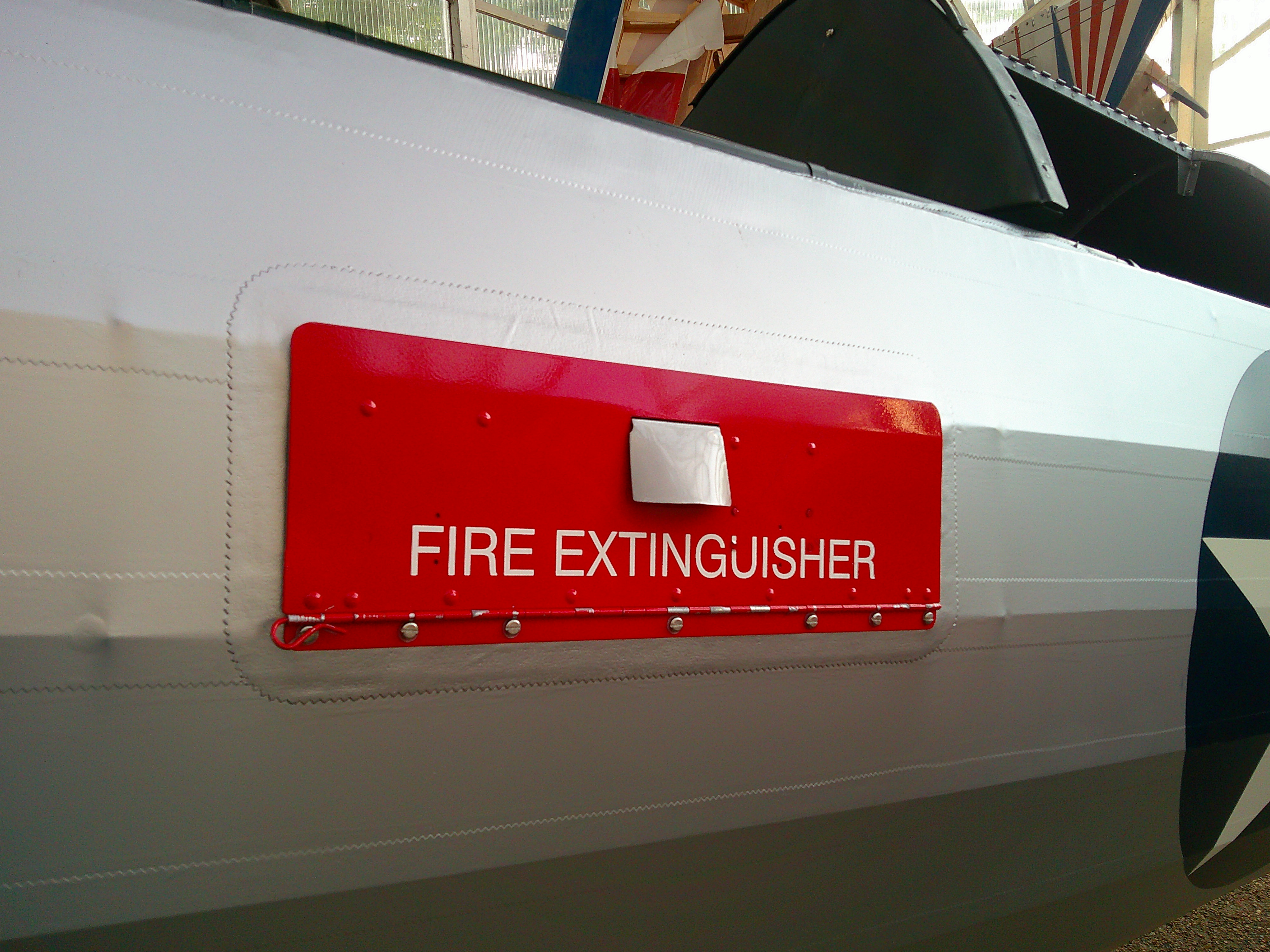

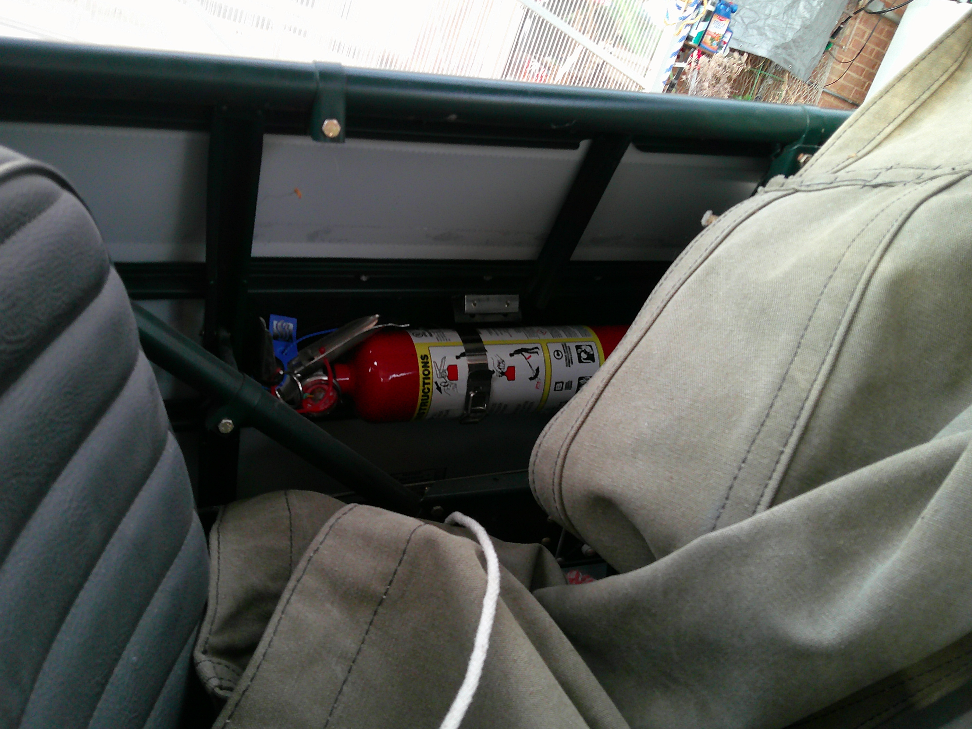

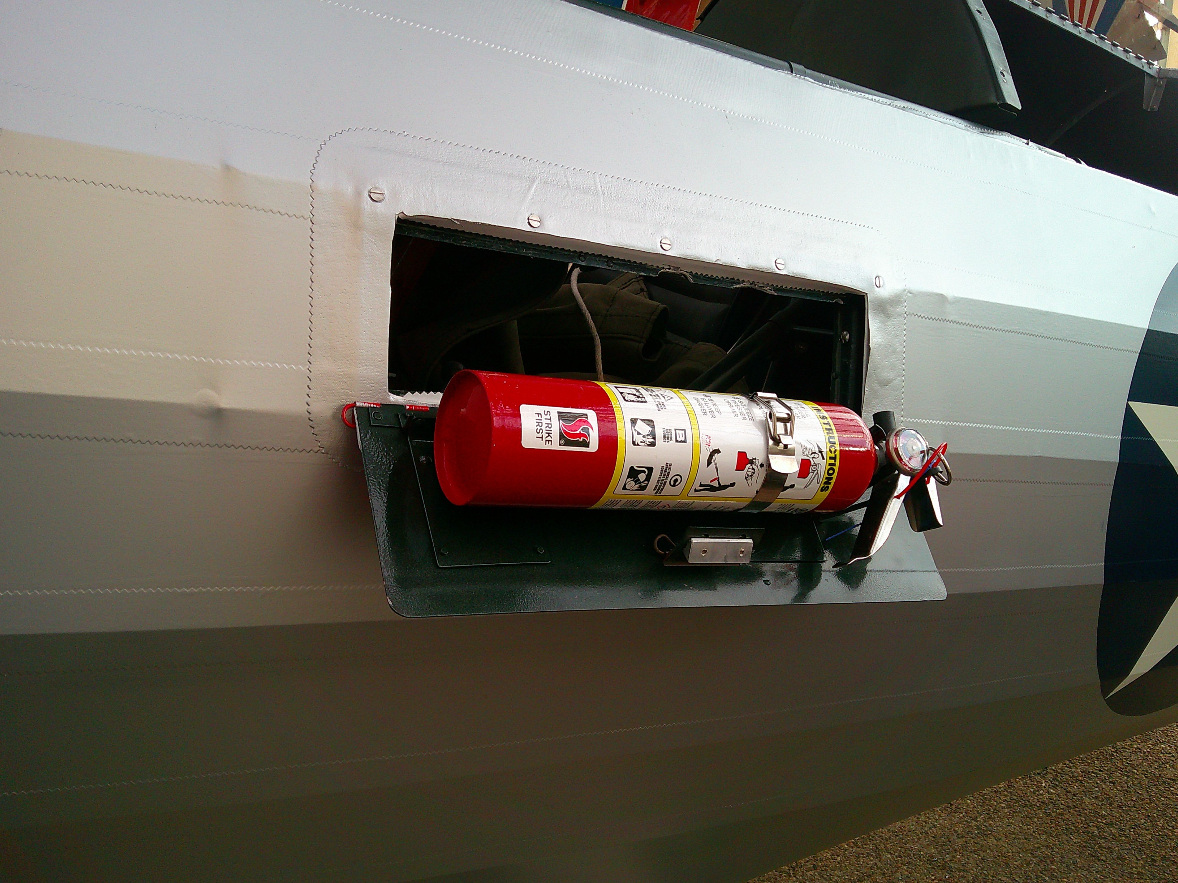

One interesting part is the fire extinguisher. Normally it is mounted inside the fuselage, so the rear pilot can easily reach it in case of an in-flight flire.
The cool part is that it is mounted to a door that allows it to be accessed outside the plane too, in case the ground crew needs to douse an engine fire or fuel spill.
Yeah...my hinges scratch when you open the door, but some things can't be helped?! The original extinguisher was a brass canister full of soda water that you pumped to spray on the fire. I had to find a modern replacement that fit the door.

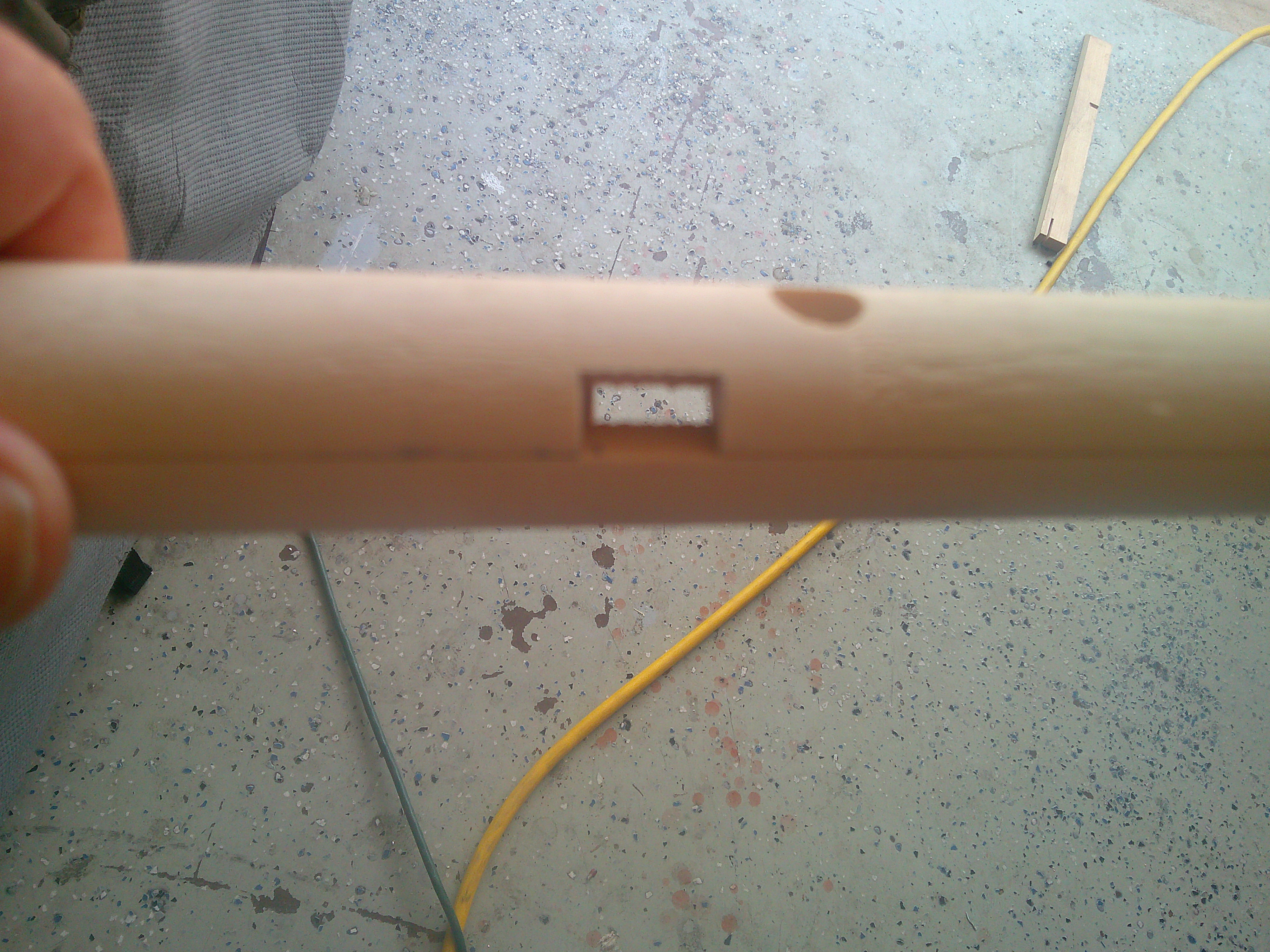

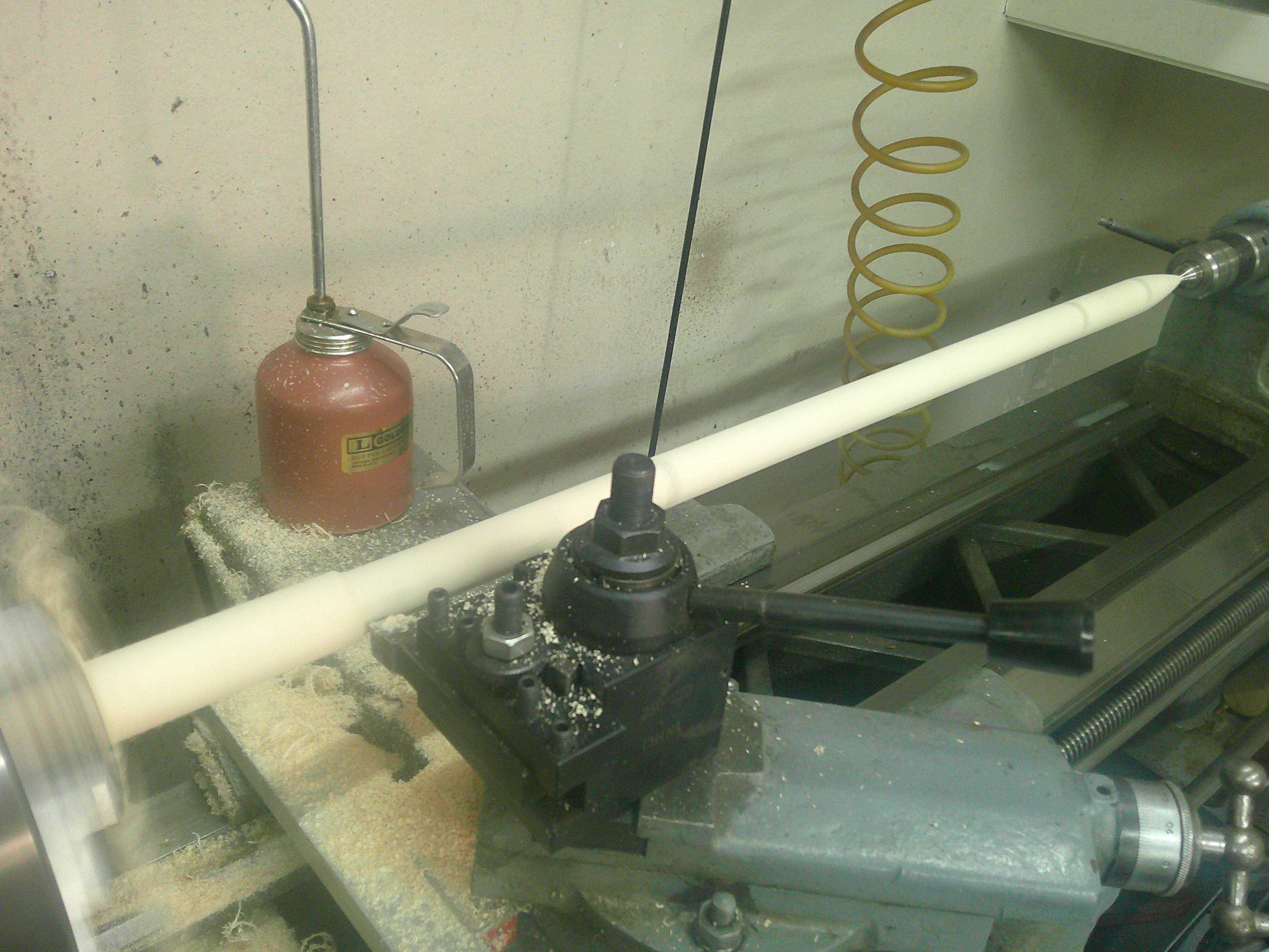

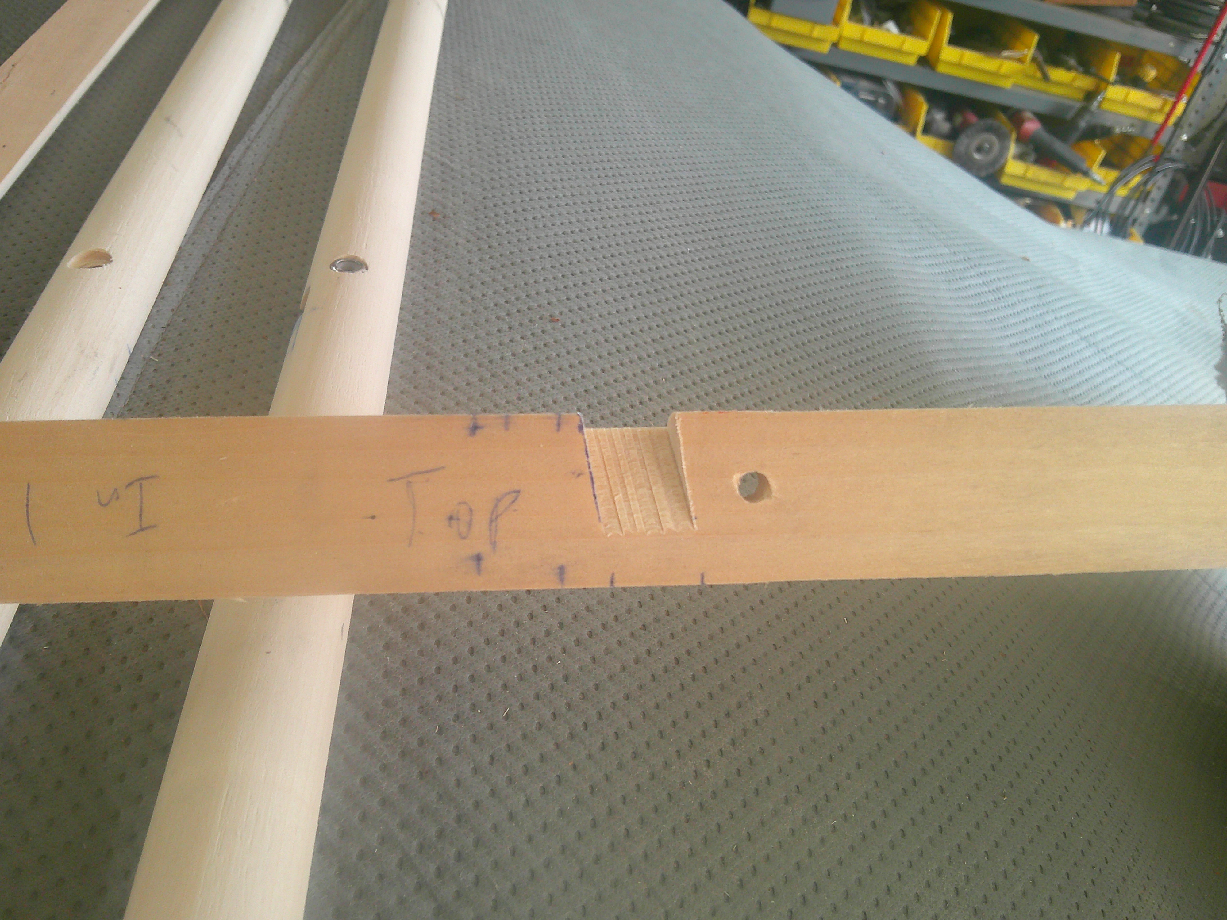

I did a couple side projects while waiting for the weather last month. The first was the wooden spreaders, that hold the flying wires going to the wings. They are round, but must split down the middle to place them around the wires, and then they clamp back together with screws.
I started by finding some scrap spruce, and bolted them together according to the blueprints.
I then worked them on the lathe to 1" diameter round.
Next, they come back apart and I used a table saw to carefully cut the slots that will take the streamlined flying wires.
I don't have a picture, but they finally were sprayed with silver aerothane...and were sent to the hangar for final assembly.

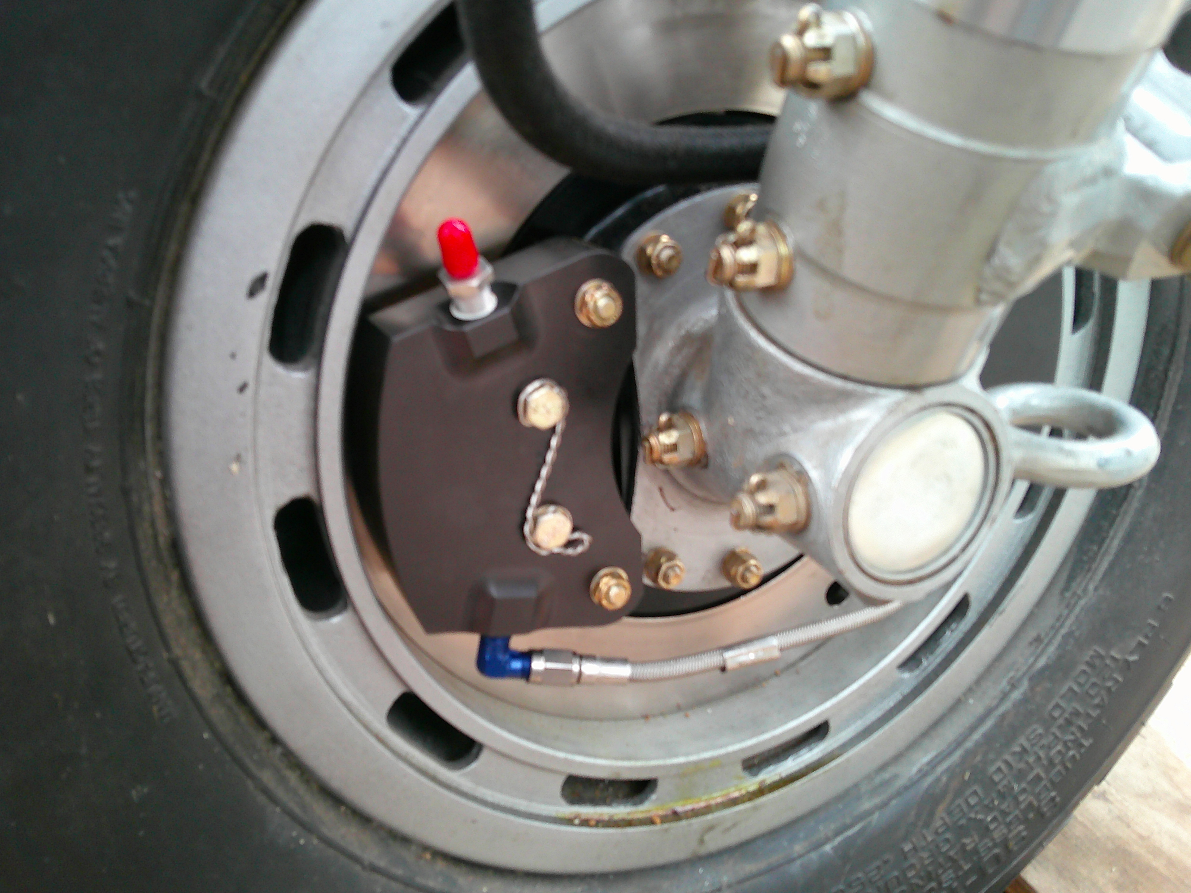

The second side project concerned the brakes. 3 years ago I restored and installed the OEM master cylinders and drum brakes. They looked great, but I could not get them to hold fluid...they would gradually leak down, even when not being used...and considering I re-sleeved the cylinders and used OEM seals. I used the OEM brakes due to my anal compulsion to "restore to factory original" on everything I fix. Even worse, when 5606 hydraulic fluid sits for a long time, it turns into a nasty, glue-like paste that sticks to everything I spent so much time cleaning.
You will remember that my Father crop dusted in these planes in the 1950's. He had a lot of stories, but none of them mentioned any problem with the brakes...until last year. I told him I had a concern that while pushing the plane around, the drums would occasionally grab unpredictably. I would have to push the plane the opposite direction to release the grab...and this concerned me. "Grabbing" could be very bad on landing a tailwheel plane!!
Dad's response was..."Son, those brakes never were any good." Oooo Kkkkk. Time to rethink these OEM brakes! He continued by telling me all the planes he flew had swapped out the master cylinders for packard auto masters, because the originals leaked so badly. Even then, the wheel cylinders leaked constantly. He would top off the brakes right before the first take-off of the morning. During the dusting, they would land on the roads, where they would re-load the hoppers from trucks and take off again. That is...until the 3rd flight, when the brakes would go flat from leaking all the fluid out! So the next re-fill would require them to go back to home field, where the runway had a steep uphill to stop the planes with no brakes.
Anyway, I bit the bullet...listened to reason (and every other Stearman owner who kept telling me), and bought a Redline brake conversion to disc brakes. This mod has been around for 40 years, and is almost considered standard practice. Your plane either has Redlines...or you will eventually learn why it should!?!

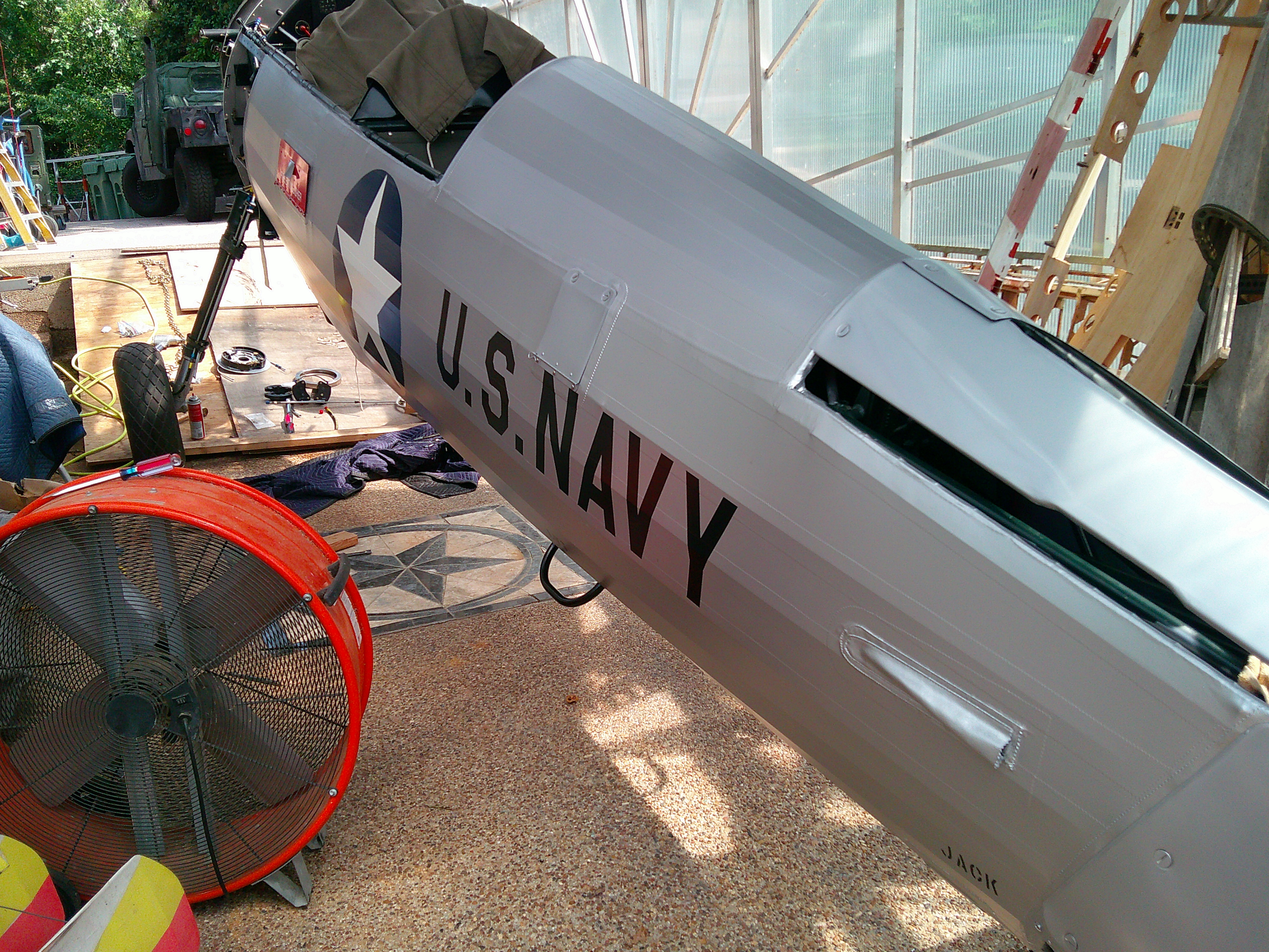

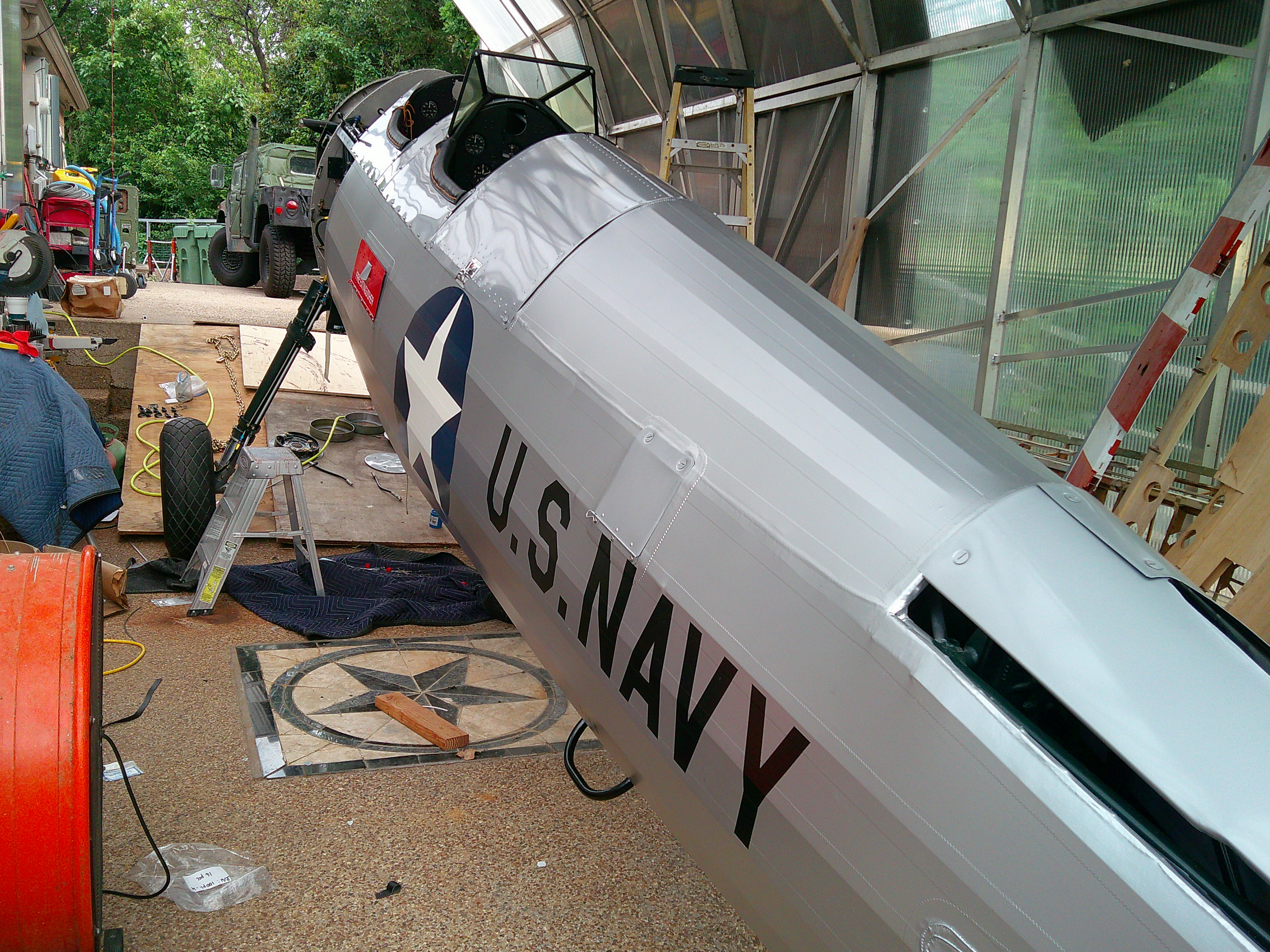

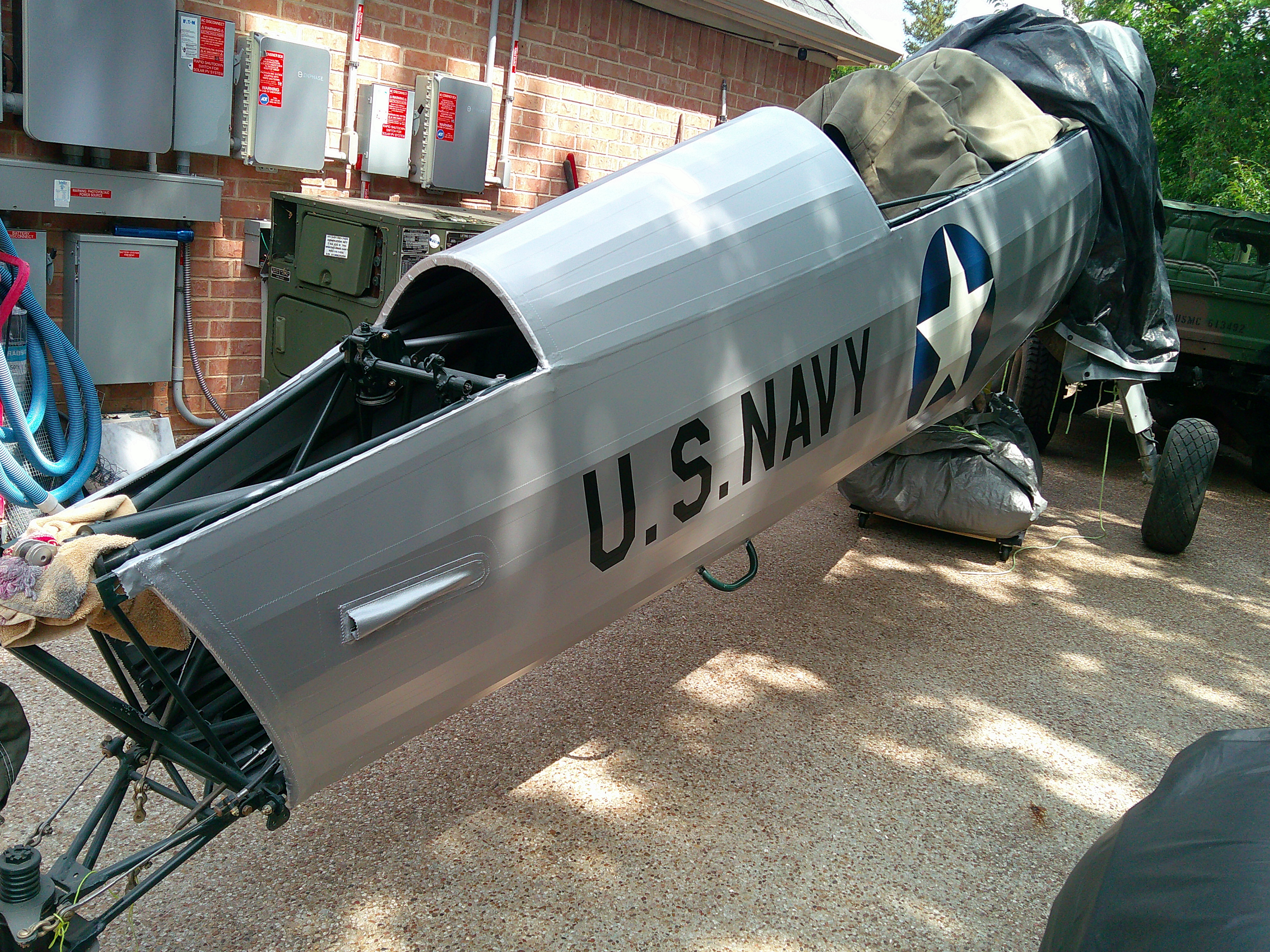

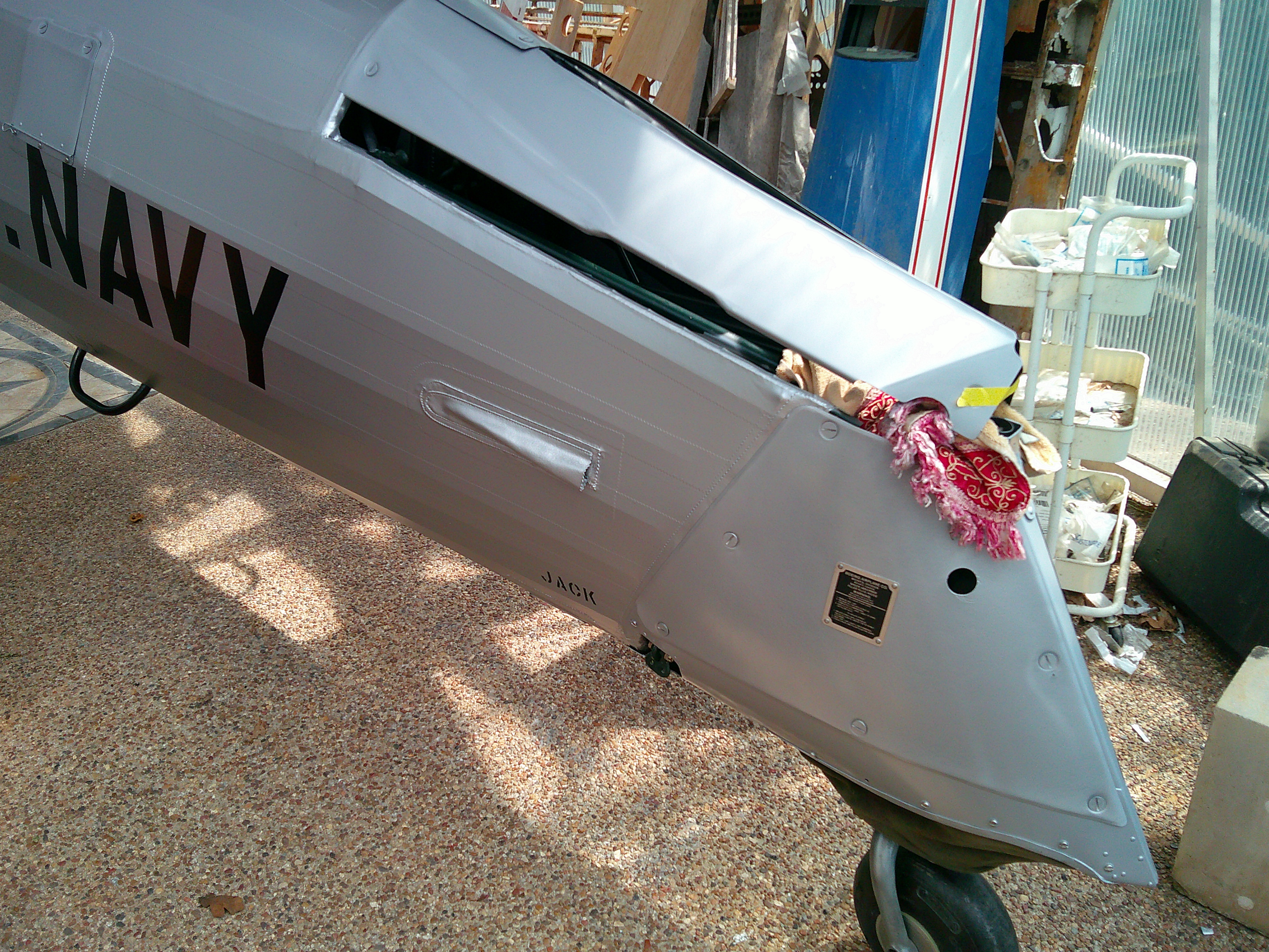

Thank you all for the support! You guys made my day, as my A&P supervisor hammered me the other day. Gary is a gruff old gentleman, and I think he is hard on me so I feel like I'm getting my money's-worth from him. I sent the same pictures above, and he said the "door openings look like I used a carpet knife and the square access door dzeus fastener is cocked...plus the hinge wire is not safetied properly". If you zoom ALLLL TTHHHEEE WAYYY INN like Gary does...you'll see he is 100% right. Of course all those items are still being worked on. The worst was he commented that he can, "see I am in a hurry, getting tired and rushing the job as I get near the end." Of course, not true. He has been on chemo the last few months, and I have to remember he is often in a bad mood and means nothing personal.

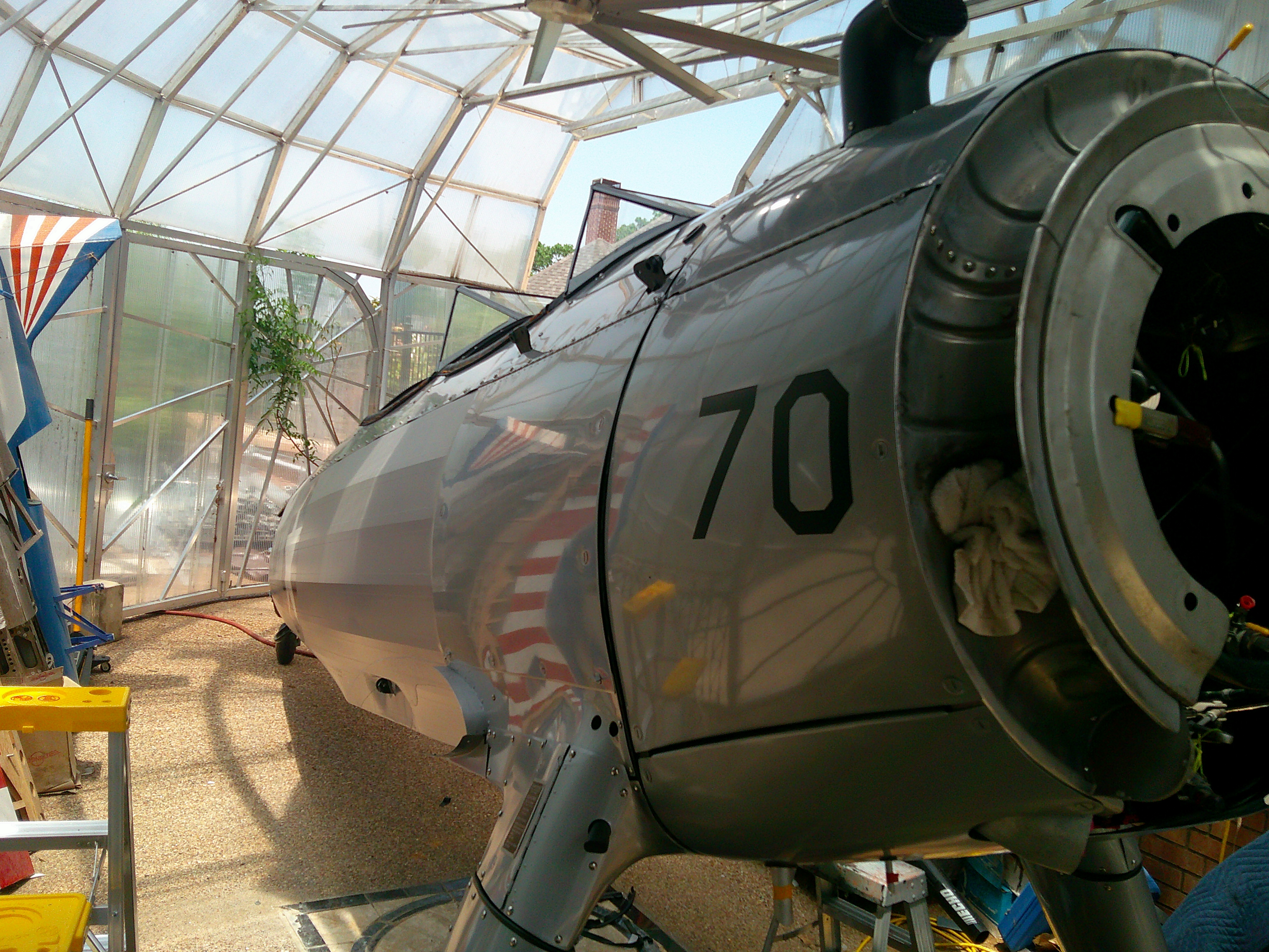

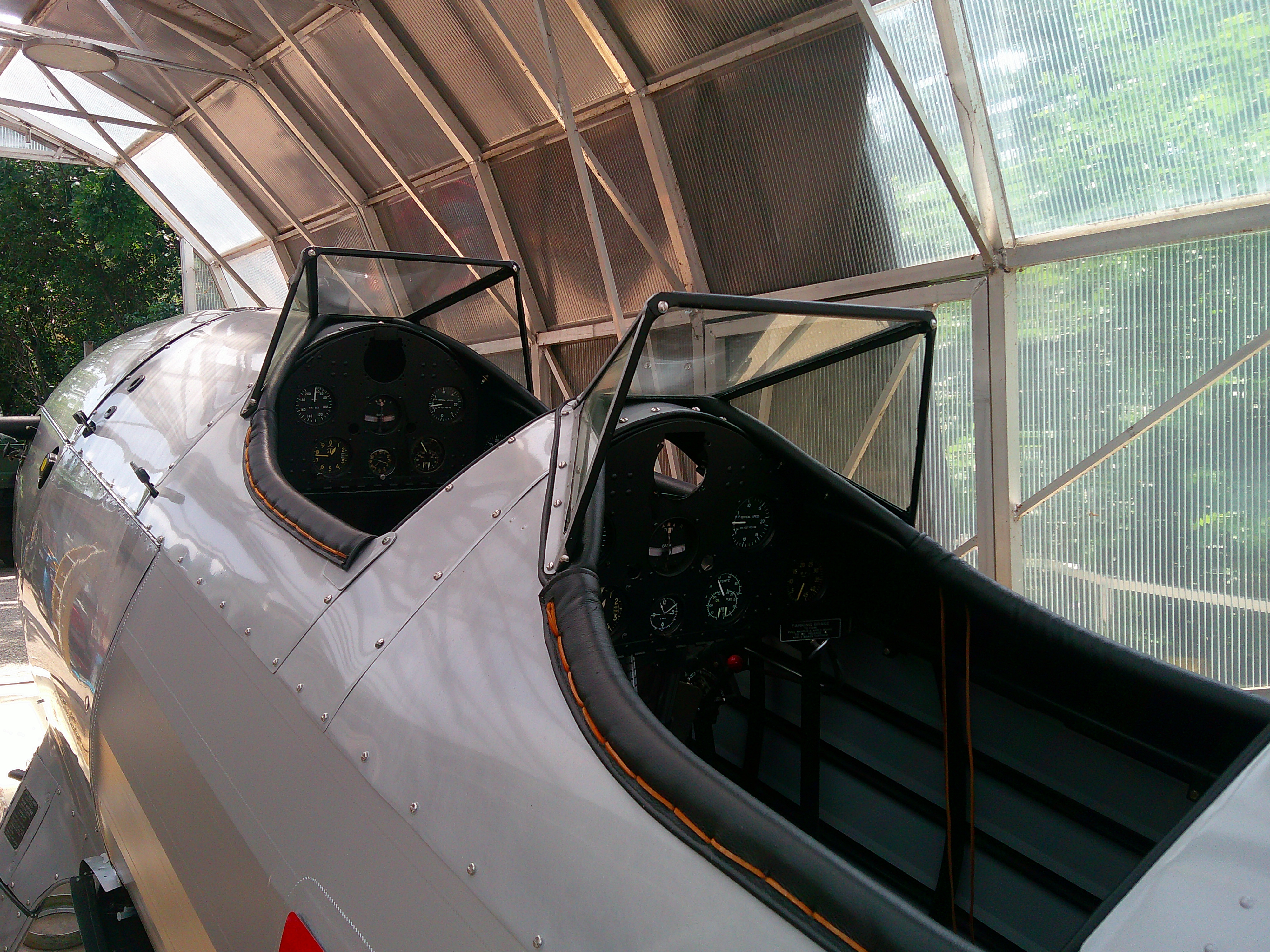

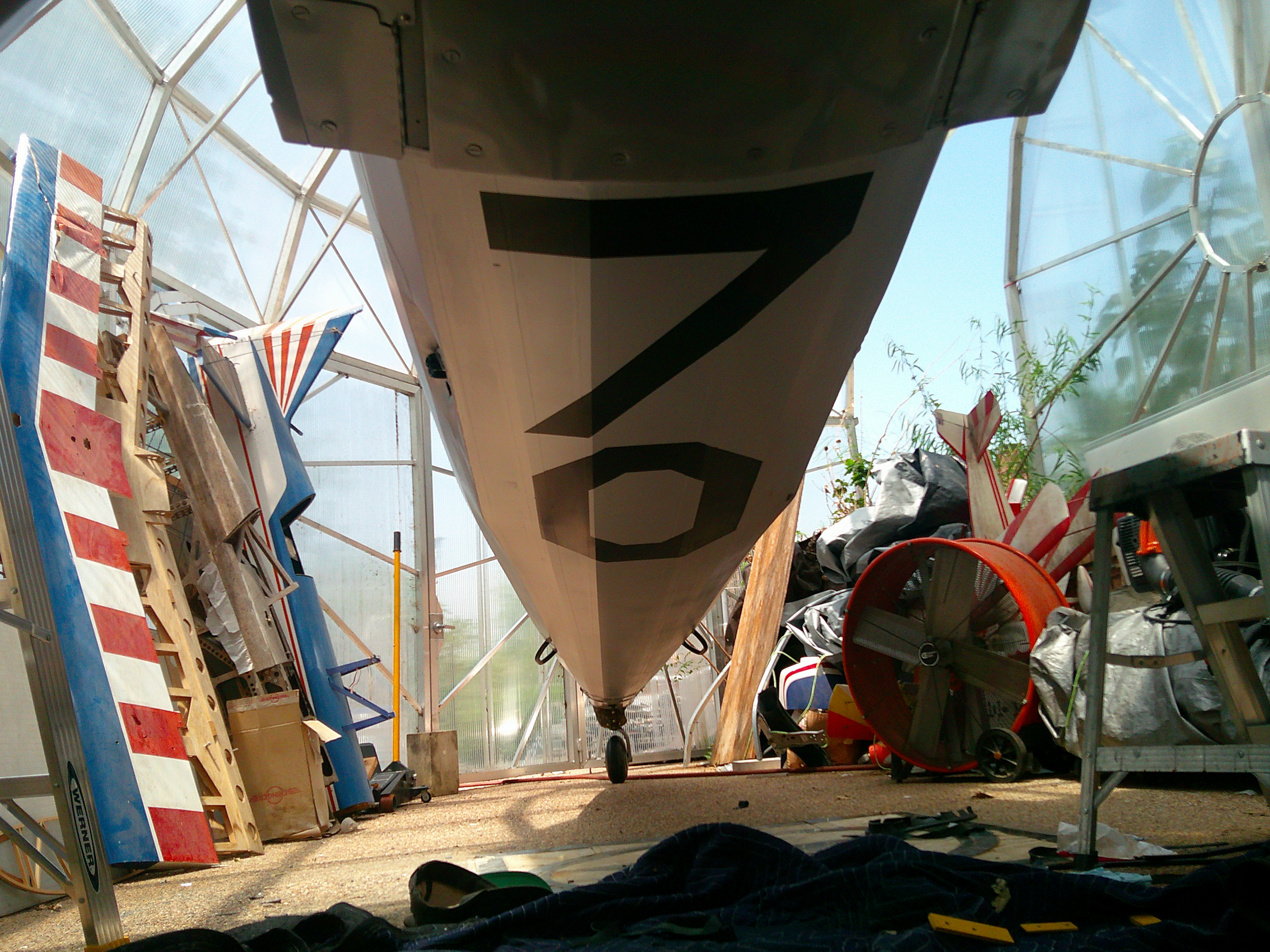

This is the finished fuselage. I think the TR2 and 3 restorations prepared me for this project, as it has the same difficulties you have with any hand-built vehicle. The order you put it together makes a difference, and you often have to back up by removing some panels to make others fit!?! This weekend I will move the fuselage to the hangar for storage...and then I get to dig into the engine...woohoo!
Yes...the compasses are missing. I am using vintage compasses from 1937. I had them rebuilt, but they still leak fluid, so I am working on seals to get them air-tight. I'll keep them out until final assembly...just to make sure they are sealed before I install them again.

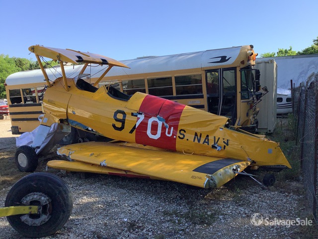

And, a reminder of where it started...
