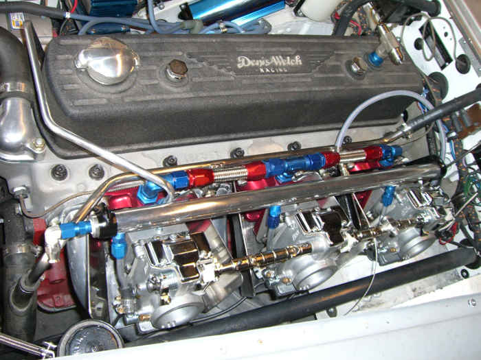

I have a question about hooking up the brake booster vacuum line. I’m not even sure if the Tri-carbs had the booster option, I think it started with the BJ7s? Anyway, I have the vacuum line running off the front manifold at present. I’ve been struggling with the thought of tapping into the balance pipe instead, in between the front and middle manifolds. Any thoughts? Seems like it would keep things more even if it was connected to the pipe instead. Here is how it’s configured at present, aluminum pipe from front manifold wrapping around the valve cover. See arrow. Thanks.
Re: 1500 CFM anyone up-date
Hi Greg,
My thoughts,
You "might" have slightly more vacuum with a multiple or central takeoff point, but probably not worth the trouble. The plumbing is so clean now that it would be a shame to change it if not needed. In reality, you already have all cylinders pumping through the existing manifold equalizing tubes.

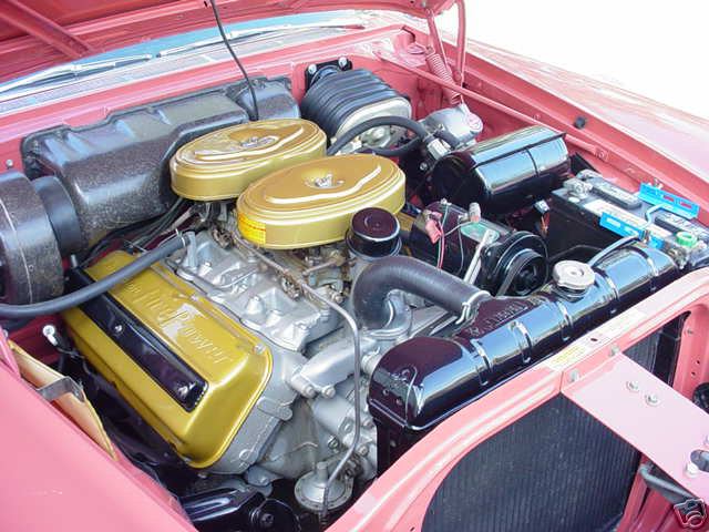

Cars with radical cams that don't have much vacuum often use a vacuum storage can (accumulator?) with check valves, maybe two quart capacity, to keep the booster working when temporary low engine vacuum conditions occur. The last one of these that I had direct experience with was my Chrysler 300D. See attached pic, it's the black can on the left inner fender panel. It was good for about four brake applications with the engine not running. Some boosters accomplish this right in the booster body via a check valve. I don't know how your booster is set up.
I would certainly give it a driving try, as is, first. I think an accumulator, if needed, could be added later. There are some clean looking "cans" available on the street rod market.

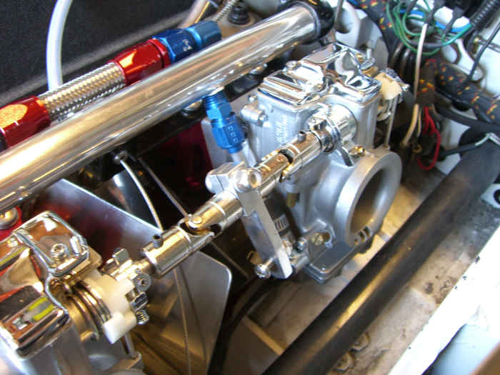

Wooo Hooo, they’re in! I wrestled with one bolt for a long time. The bottom bolt on the rear intake to head. Once I was past that it was pretty smooth sailing. Need to tweak a couple of things (fuel lines). I ordered a Heim joint for the throttle cable last week, called today and they said that it shipped and would be here April 26th! Are they kidding? Anyway, I’m happy with the way it finally came out. Can’t wait to see if it actually works. (crosses fingers).

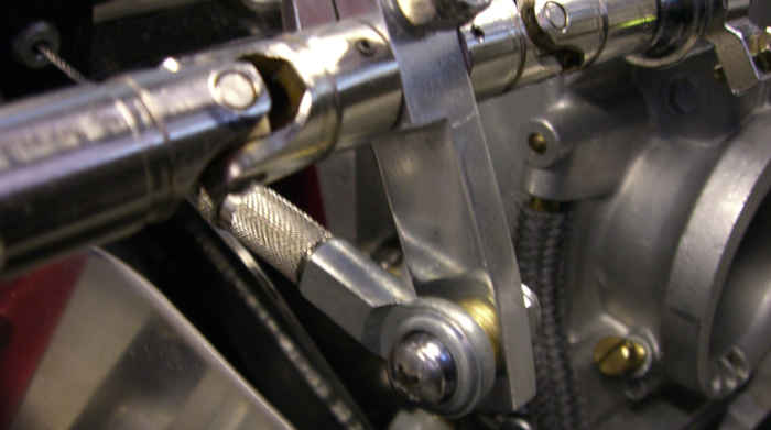

Hi Lin,
It will attach to the lever on the throttle shaft (see arrow). I haven’t had any luck finding what I wanted locally. It needs to have a 3/16ā€ hole and a female 10-32 end. This will thread onto one of those Verlocks which attaches to the cable.

So far the cable system is working fine. I need to tune the carbs today, so I’ll know more later. I had forgotten about your question regarding the heim joint after it arrived in the mail. Sorry. Here is where it went.
