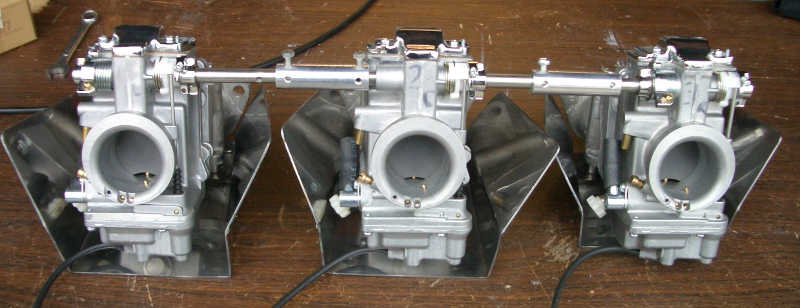

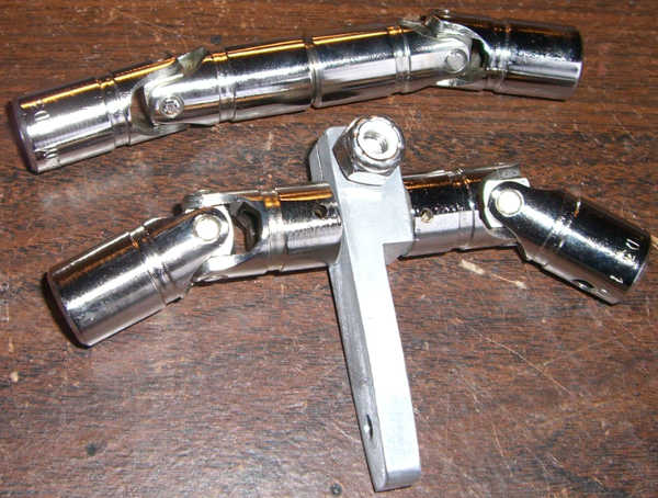

Well, the plot has thickened to the consistency of molasses, and my progress has slowed to that also. I sent the carburetors back to have the adaptors shaved down as I mentioned earlier. When they eventually came back they cleared the steering column. Problem solved. I had to lower a section of the pedal box by about a half-inch to clear the float bowl of the rear carb. Welded in a new piece, no fuss. Then I bolted all the carbs on and none of the throttle shafts lined up. #2 and #3 were offset by about an eighth of an inch! Aaaarrrr /ubbthreads/images/graemlins/cryin.gif guh! Turns out that the adaptor plates weren’t milled together. The amount shaved off was different for each and the angles were different also. What to do? I mulled it over for a while. I didn’t want to send them back, ‘cause they might come back wrong again, but take a long time. I decided to tackle it myself. Trying to salvage what I had, I decided on double u-joints. I found some joints that would fit length-wise but they had a smaller bore than the 10mm throttle shafts. Also, the throttle shafts were cut to the wrong length for what I wanted to do. So I wound up getting some 10mm rod, cut it to the right length for each carb and turned the ends so they would fit into the u-joints. Next, I cut a half inch out of the middle of the u-joint and fabricated a new lever that would fit on the u-joints 5/16” shaft. Here is the progress thus far.

Pardon my primitive ideas, but lots of motorcycles use multiple throttle cables. Maybe not quite as clean looking, but a whole lot easier to install & adjust. Seems like you are doing it the really hard way?
D

I hadn’t thought of using multiple cables. I’m pretty much done with fabrication so I’ll stick with the direction I’m headed for now. Thanks for the suggestion, they’re always welcome. /ubbthreads/images/graemlins/grin.gif
