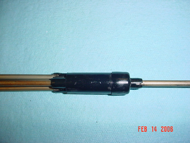

I have tried it both ways. On motorcycles, individual cables make it very easy to obtain off idle, part throttle, & full throttle synchronization of the carbs independently of the idle settings. The individual cable lengths are very precisely adjustable. I find this to be an advantage over a single fixed linkage. If you don't like the lack of adjustability with your linkage, you can always change to cables later.

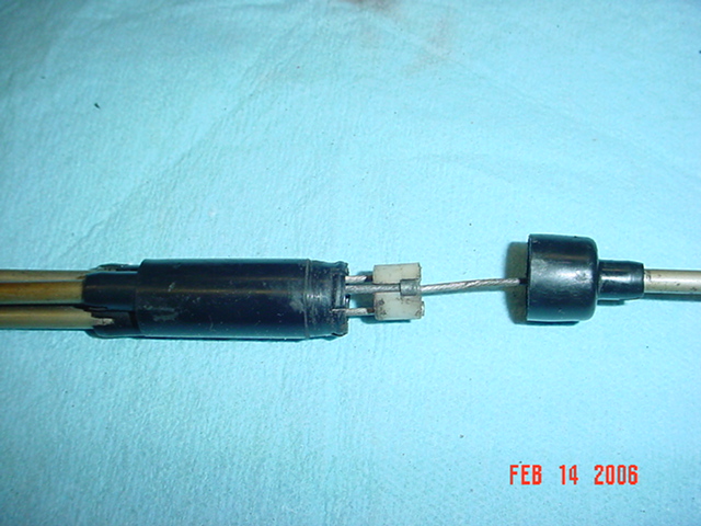

MC cables are available with multiple cable junction connectors that make it very easy. I have a one cable in - three out junction box that works very well on one of my MC's. Especially if you use teflon lined cables, they are very smooth & easy to pull. A pic is attached.

Cool part, but I’m not sure what I’m looking at. /ubbthreads/images/graemlins/blush.gif Is that a flexible casing and the cables are connected inside the black housing? What is the travel on it? I would imagine there would be a selection of travel lengths.

Here is a better pic. A barrel with a slider inside. Cable outer housings seat in the barrel ends. One cable in, three out. Slider is counterbored for the inner cable ends.They are commonly available in metal & plastic bodies, various lengths & travel. Actually wouldn't be hard to make one but there are hundreds available in MC junk yards. This particular cable has 1 5/16" travel. It's a spare for my 1969 Kawasaki 2 stroke tripple.
I'm sure that what ever you do will turn out first class. Just showing a different way to do it.

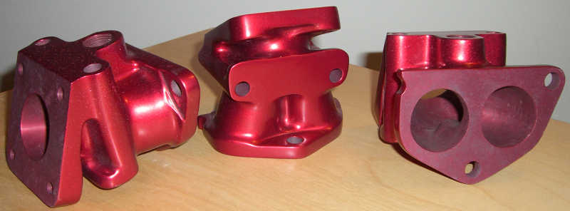

This week certainly had its ups and downs. My digital camera was stolen from our “Secure” warehouse Monday. On the upside, I found a polishing shop near where I’m working. Dropped in and had them polish the outside of my intake manifolds. Picked them up Wednesday during lunch. They turned out great. That afternoon, found a local plating shop in the phone book. Over the phone quote of $125 minimum to anodize, but bring the parts in for the owner to look at. Went by to drop them off to the owner who said he could do the 3 manifolds for $75, which was his minimum..? Got the call that they would be ready for pick-up today. When I arrived, the owner had changed his mind about the cost. I know what you’re thinking, but that isn’t the case. He wouldn’t take any money. Gave it to me for free, and what a beautiful job he did. He only asked that I didn’t say his name. It’s hard these days to find good quality work without referrals, but this kind of service with no prior relationship is rare indeed. Hope everyone’s week ended as well as mine. /ubbthreads/images/graemlins/grin.gif
Oh, forgot to mention, these are original manifolds. What’s that, 44 years old?

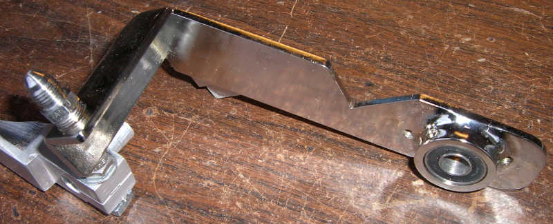

Finally got my butt in gear and finished the throttle linkage fabrication. Did some sanding, polishing and then nickel plated the pedal bracket (and double U-joints) today. The thread “Accelerator linkage restoration” got me thinking, so I combined the bush (now a bearing) with the cable stop.

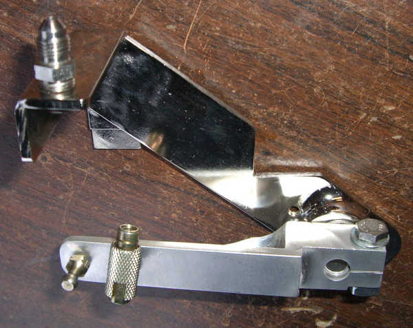

Here’s a shot with the lever in place. The ball joint with the socket will be connected to the overdrive switch, the other ball is for the throttle cable.

Looks beautiful. So can you run a cable through there and show me how the cable stop works. I can't quite conceive how that will function. As you know I am in the process of doing something similar and I am always looking for good ideas! Details on the bearing? Size, brand, asssembly? etc.

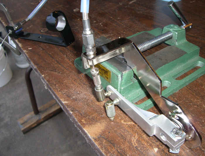

Here’s a bench mock-up. This picture show the orientation the pedal bracket will have in the car. It angles up towards the firewall. I don’t have any specs on the bearing, it was something I had in the garage that had a 3/8” ID and fit snugly in some steel tube I had laying around. I used a 3/8” or so length of the tube to make the bearing housing. Overall height of the bearing assembly is about 1/16”-1/8” less than the original bushing, so the lever is a little closer to the pedal box. I found some cable grabbers (Verlock Jr.) locally that screw into the ball socket. I had to enlarge the hole and re-tap the ball socket to make it work. The Verlocks are hollow, you feed the cable (1/16” stainless) into it and tighten a thumb screw to lock the cable at whatever length you want. At the top of the bracket I tapped a hole for a #3 AN to 1/8” pipe adaptor. The cable housing is #3 Teflon lined SS brake hose (wish they made #2). I haven’t decided on a final length for the hose yet, but it goes straight up from the bracket and loops around to wind up pointing to the left side of the car. It attaches to the fuel rail bracket that’s mounted to the top of the rear intake manifold. From there, it attaches to a lever on the carburetor’s throttle shaft via another Verlock and ball socket.

Thanks, the bracket mounts to the side of the pedal box. The aluminum lever in the lower right of the last photo clamps directly to the accelerator pedal. All of the linkage originally on the firewall has been deleted (but not thrown out /ubbthreads/images/graemlins/wink.gif). Unfortunately, I won’t be able to start assembly until the weekend. I’ll post some pictures of it going in so you can get a visual of what I’m trying to say. Stay tuned…

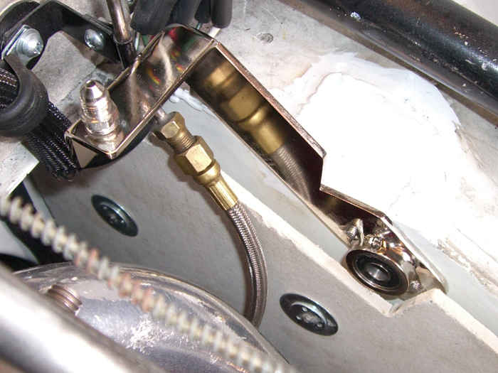

I didn’t have much ambition this weekend, but I did install the pedal bracket.
