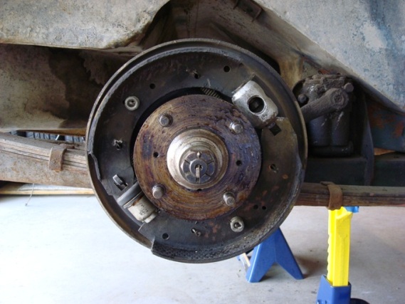

Reinstalling the rear axle in my 59 TR along with the brakes and can't remember [ no pictures, I am learning] what position the brake adjusting nut should be in [12 1 2 3 o'clock]so that the emergency brake cable dosen't hit the frame or rear springs.

Here is a photo of mine from 1990. It is taken from the rear of my 1958 TR3A and you are looking at the brake on the LHS, beside the mufflers. As with the TR2s, the TR3s and the early TR3As like mine, this is a 10" drum system. At some time later TR3As switched to 9" diameter drum brakes. But the positions are the same.

Thanks Don, picture very heplful

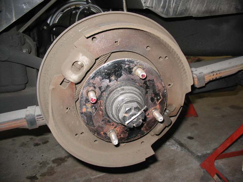

Don - I notice in the second shot that the brake shoe retaining pins are absent.
Was this because they were not put back on yet or do you run without them?

George - You have a keen eye. On TRs with 10" drums, there are no retainer pins. My early TR3A has never had any. My TR came this way when new.

Mine (with 10" drums) has the pins... they are the sort that have a cupped washer and a spring and lock with a quarter turn.
I left them off when I was doing some experimenting with the position of the shoes and couldn't tell any difference so I didn't put them back on. Couldn't really see how the shoes can go anywhere w/o them and they are designed to allow a fair amount of play anyway.
