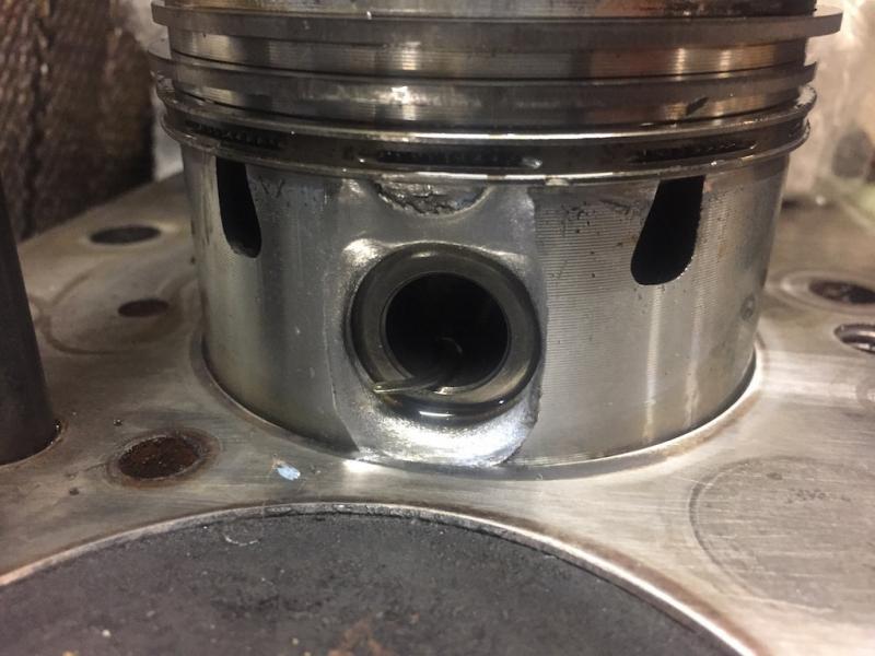

- Piston/gudgeon pin circlip 2nd cylinder broken (see pictures)
- 2nd cylinder damaged
- All bearings worn (bearings at 6th cylinder show the most wear - 1st cylinder bearings - main and rod - look ok)

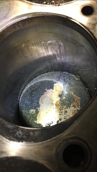

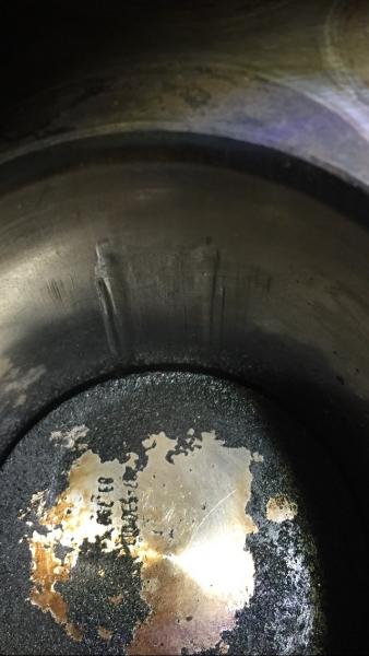

And the cylinder was badly damaged by the circlip. I don't know how long it takes for that to happen?
Re: Zero oil pressure at 4.000 RPM

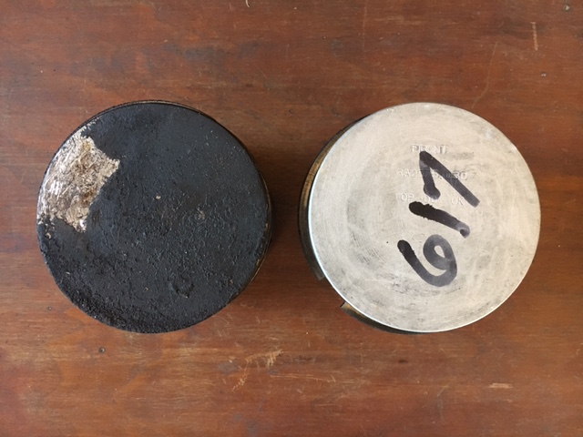

Is that excessive carbon buildup on the piston (asking because I don't know, but wouldn't expect that on a low-time engine)? Would that be a clue?
J
Jurjen
Good question, I don't know whether it is excessive.
On this piston (the 2nd) the carbon was partly washed of, due to the head gasket being blown after the overheating/breakdown. Altogether I have driven the car for 100 miles after that (on different occasions, trying to figure out what was the problem).

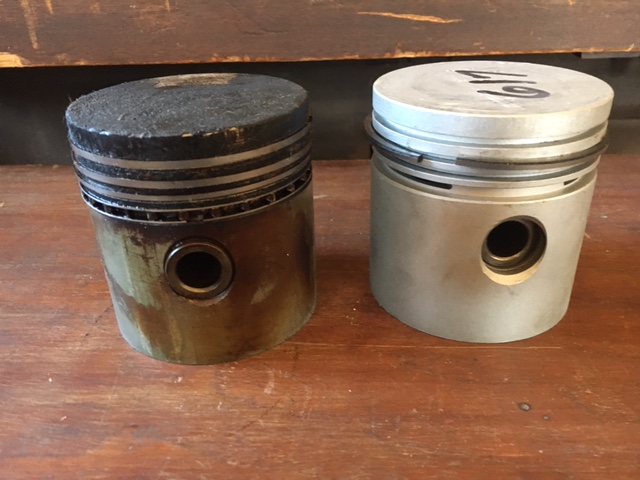

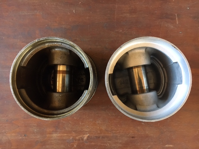

Here's a couple photos of 2 pistons removed from my BJ8 engine at overhaul (one was cleaned-up for inspection). These pistons had about 100K miles on them since a prior overhaul, and they probably had about 150K miles total (I don't remember if we cleaned them up when we reused them). So, the carbon buildup on yours may not be excessive:
I vaguely recall when we did the first overhaul the pistons had a lighter-colored, dry-appearing coating on top that didn't have the dark, oily appearance of these. But, at that time I was still running on mostly ethanol-free gas.
