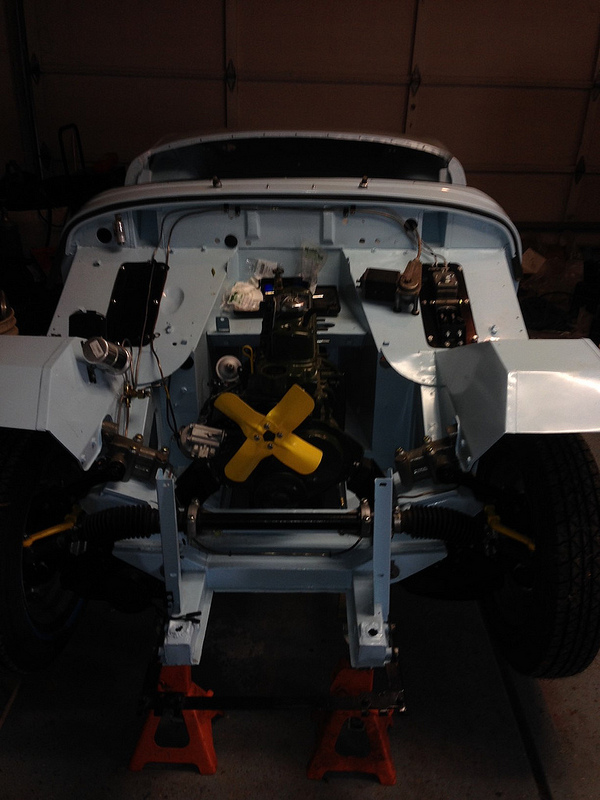

Nearly ready to drop the lump in the B/E. What can I have bolted on before installing it? Starter? Generator? Spin on oil filter? Header and carbs?. The bonnet is off and heater has yet to be installed so it is as open as it will ever be. Fuel lines and Brake lines are in and the dash is wired up. Your thoughts? Pics later.

It is in! What a pain. Mostly of my own doing. I forgot the motor mounts were handed and with the new paint always on my mind I was worried about destroying it. Well now I think it gets easy. Lets see how long it will be before we hit the road!
