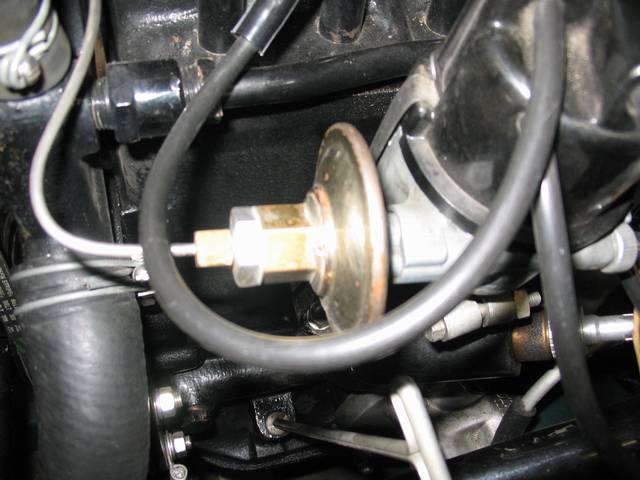

By the way, the final location of the distributor is so much turned clockwise that the vaccum advance unit is touching the water pipe on the engine. Is it normal?

Yvan - If you pull out the distributor and the drive shaft that drives it off the cam, you can index the drive shaft one tooth counterclockwise (or two if needed) and then re-assemble it. This way, the direction of the distributor can become "horizontal" when you look at it.

Thanks Don, I will try to index the distributor shaft.
