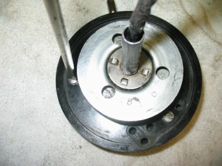

There is a round plate about 3" outside diameter on the rear of the complete assembly. Look carefully at the outer edge of this circular plate and you will notice it has an inverted "V" profile all around. The grub screws are pointed on the inner end and if you unscrew the grub screws quite a bit, you can push the whole assembly into place far enough. The point on the ends of the three grub screws will "catch" onto the inside of the inverted "V" and it should be secure.

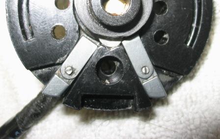

I repaired mine with some brazing rod. Not too big of a deal. Of course after careful cleaning and lubrication of the control head. I put everything back correctly and the two pieces that should cancel the indicator lever wont extend far enough to fully center the lever. I'm not sure if they are worn down that far or the springs inside of them don't extend enough.

ekamm
Randall the two pieces where your thumb is in the picture don't come out far enough for the ring to hit them with enough force to kick the lever back to the center. Originally the problem appeared to be the ring. There was a grove worn in the ring. I filled it with JB and shaped it smooth with a dremel. It worked well at first but after a few days when the steering wheel came back it didn't contact the "pawls". It's as if they are worn on the ends.

So yours don't stick out as far as this?
ekamm
They did when I reassembled but with it on the car they don't appear to be working that way. I need to remove it and see if I can tell what's going on. If I understand correctly the hinged part of the piece is spring loaded and that should make it stick straight out. Maybe they just aren't returning to the straight position.
Don Elliott
Randall - With all respect Randall, I believe that the way the lower end of the "flippers" should be as in my photo.

You're quite right, Don, my bad. I just grabbed some bits from the bin for that photo, and put them together wrong.
Here's a shot that shows the dimples where the control head tube engages with the stator tube. This is a non-adjustable version, but the adjustable version is similar (it just has a much longer control head tube).
