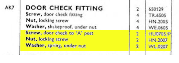

Aloha Arrow,
I concur. The "Standard Triumph TR3 Spare Parts Catalog" on page 88 lists the door check strap assembly. The attachment to the "A" post is a hex head screw (pointed end) 1/4" UNF x 1/2" (part number HU0705/P) and a corresponding hex nut and spring washer.

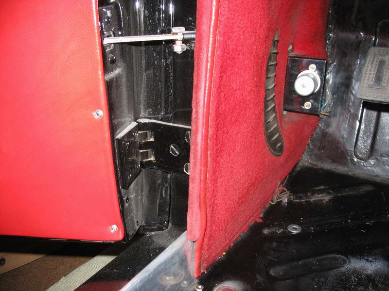

Here's a tighter shot:
