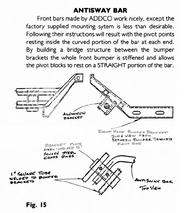

karls59tr
Bronze
Not sure if this will help but there is a picture in the booklet "More BS about TR's" by Bob Shaller that shows a modified way of mounting the sway bar. Perhaps someone on here can post the pic. I used this method years ago and it turned out very well.
TR3driver
Great Pumpkin - R.I.P
This one?
Untitled.jpg~original
FWIW, I ran the "less than desirable" ADDCO mounts with my ADDCO bar for roughly 30 years on my previous TR3A. Worked fine for me. I'll have to build mounts to put it on my current TR3 though, as it doesn't have the same kind of bumper brackets.
