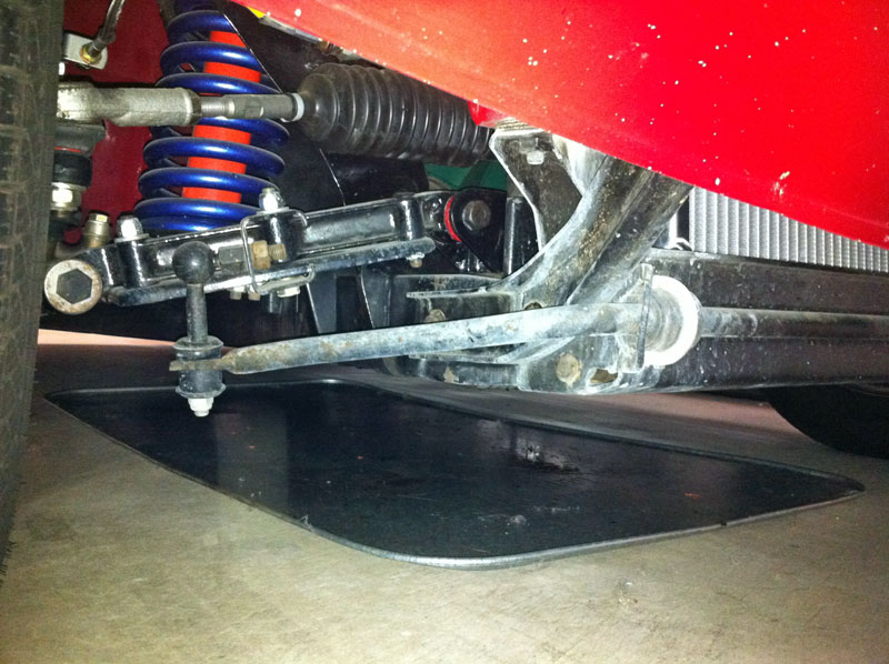

I don't know why it worked for me, perhaps the front piece isn't stock on my car. Here is a quick picture of how it looks.

Darrell,
My Tr4a radiator shield looks similar to your picture. Mine also has two vertical sets of 3/8 holes at either end of the shield. Can you confirm if the bottom front lower corner of the shield is also about 10-1/2 in. from the frame cross member behind it; it is roughly at the same low elevation. Thanks.

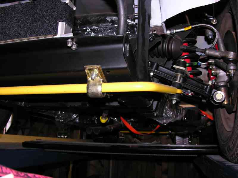

Addco 7/8" TR6 bar installed on my 4A. I had to drill for the mounting inside the TR6 mount on the radiator guard because the original holes (for the original TR6 bar) were off.

I would appreciate your wisdom with swaybars.
I am installing an Addco swaybar, and it occurred to me that ideally the relationship between bar and link assembly should also consider extending life of the rubber bushings....Addco instructions do not say much.
From PeterK's swaybar picture it looks like the bar is not perpendicular to the link ( maybe 110 degrees from the vertical ), if the picture shows car sitting on its wheels!. This 110 degrees probably tends to compress rubber bushings. Does anyone know if this is typical of most swaybar installations, or does one do what one can with the asymetrical nature of each car ?
I ask because my intuition tells me the life of the bushings could be extended if the bar were perpendicular to the link! Is this significant to consider?
A second question: my links clear the lower part of the wishbone by 1/8 in. I assume this is ok as the wishbone movement is only in the vertical direction. Is this clearance too close?
