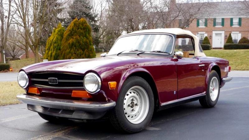

Good info to know-I've heard that just about most reconditioned lever dampers wear out too fast, as do remanufactured leaf springs. According to our trusted British Car Gurus, the shocks on our B are fine and dandy. (FWIW, the bounce test worked great on my Midget, but I think everything was original, Abingdon-installed anyway, so past its sell by date)
-William
