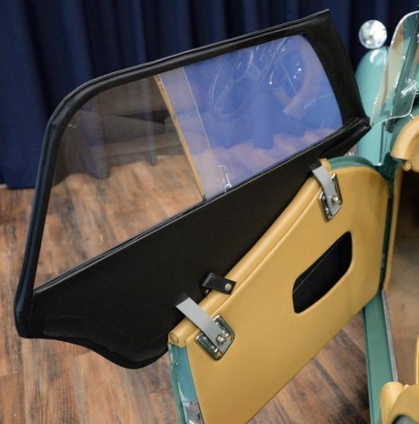

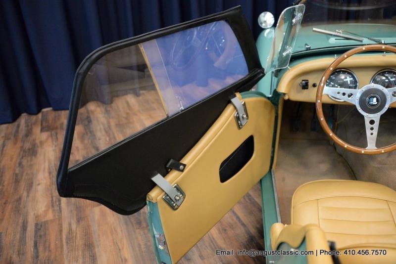

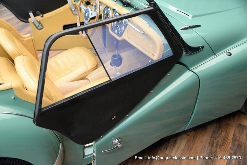

That's a pretty big gap and likely an issue if you are traveling at more than 25 MPH. Here are pictures from another post I found and saved for future reference, hope they help! I have heard it takes a bit of fitting to get them right and best to do the fitting prior to repairing and refurbishing. I wish I had my originals, left them and the rear seat in a rental house storage shed a long time ago when I moved after college. Dang!
