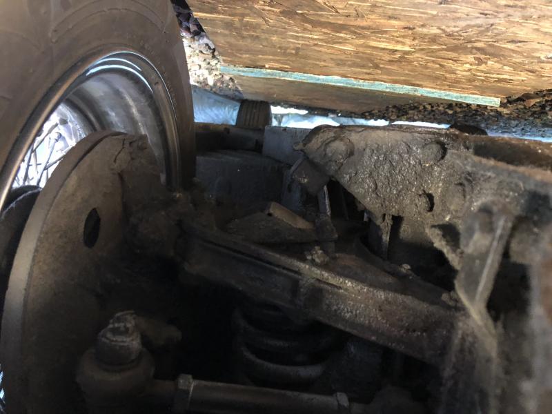

I just installed a hurricane fan and it was unusually close to the steering knuckle. Thinking the suspension is causing this. Thinking it might be time for springs. Any idea how much of a gap I’d want between the buffers? 29D434B3-AB22-4953-B82E-F173ED023291.jpg (Sorry photo is upside down)
Geo Hahn
FTFY - But not sure it tells me anything about the suspension (gap looks okay). You might have to compare ride height measurements (e.g. floor to top of wheel well openings).
HighAltitudeTR3
HighAltitudeTR3
Thanks, that helps.
That also makes me want to clean my undercarriage a bit ��
TR3driver
Great Pumpkin - R.I.P
I'm curious about what the fan is too close to. Do you mean the center link? I'm probably just having a senior moment, but I don't recall anything anywhere close to the fan that would be affected by ride height.
Sagging motor mounts, maybe, but not ride height.
(BTW, I agree with Geo, ride height looks fine)
