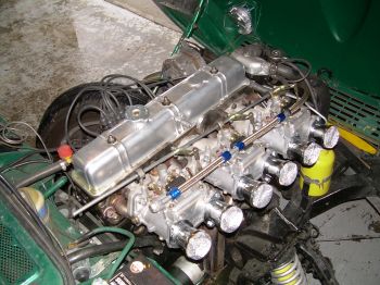

Hey folks.. Does anybody have one of these? how does it drive? Are there any around for purchase? I understand that they are recently out of production from JTR Competition.., and now the closest thing is an Iskenderian regrind Z19..
We just put a nice set of Delorto's on the Mk1, and it cries out for some more go fast goodies..
