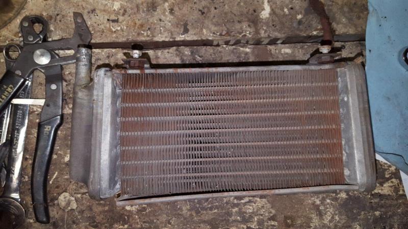

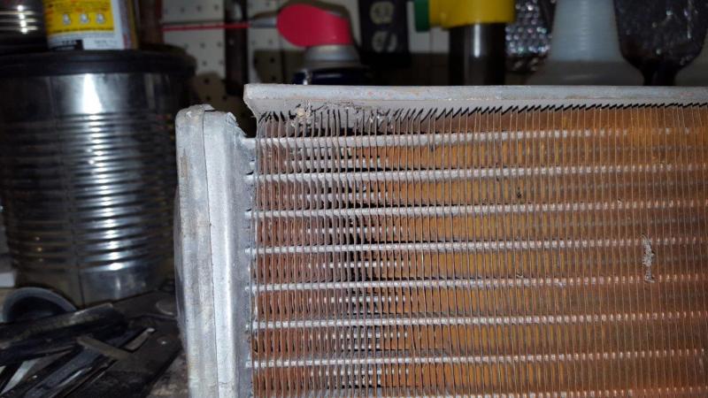

I'm working through the heat/air components. I was inspecting the heater core and noticed that one side had pulled away at the weld. See pics. The tubes, tanks, and fins seem OK. I'm guessing that there was expansion at some point but I don't see any other evidence. Can this unit be repaired or would it be better to get a new one? Are the new units good quality? That's always a fun question.

Dale, I would expect that a local radiator shop could check it out and make needed repairs. I had both my the heater core and radiator checked out here in town and fortunately for me they were good. I do have a leak in my heater, but it's in the flow control valve which I tried to refurbish myself. Looks like I'll be ordering a new one.

My radiator shop told me new cores aren't available. Yours looks pretty good. Boil it out and pressure test and it'll be fine. Or you could buy a pressure tester online and rig up a way to pressure test it yourself.
I have a Stant cooling system tester and it shows 10 psi as the test point for a 7 lb system. Pump up a spare tire with 10 lbs and hook it up with one of those "equalizing" hoses. There's probably info or YouTube videos telling DIY folk how to clean their own radiator with Drano or some such.

Detached top and bottom plates are fairly common with age. They're just brazed on. From the pic the top plate appears to be in good condition and not pulled away from the tanks. This is good news since it's the attachment point to the heater box. The bottom plate is not "structural" so it should not be too much of a concern.
My core was not leaking but the top and bottom plates were beginning to detach, so JB Weld fixed that. Quick tip: A thin film of silicon / dialectric grease helps to ease the radiator hoses through firewall grommets. Home Depot has a good assortment of rubber grommets for heater box and firewall (check electrical isle for the packet). GONZO

Gonzo, my plate is pulled away some and won't be pushed back into place. Did you use and strapping or other reinforcement with the JB weld?

Assuming the heater core is not leaking, a radiator shop is unavailable and /or you're uncomfortable with brazing, then strap the side plates and apply JB Weld to seam(s). Let cure for at least 24 hrs.
The radiator shop that did mine forgot to braze the plates - repair guy had the flu - but no worries JB Weld, or similar, is perfect for this.

Just to wrap this up. I did a pressure test; 10# of air pressure with the core submerged in water. Bubbles came from the seam where the hose neck comes out of the tank. I was also getting a very occasional bubble from a seam on the tank. I compared one tank to the other using a caliper. The tank on the side where the plate attaches and was pulled away by about 3/16" is just about 3/16" larger. I believe that the unit was over heated or frozen at some point. The tank expanded like a balloon but did not deflate all the way. Even though the tubes and fins look fine and the tank might be brazed I still don't trust the unit. It's a potential problem that I don't want to worry about on a trip.
