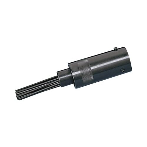

I just tried this out on the undercoating on the '71 TR6, and all I can say is YIPPIE! Or FINALLY! OK, so I can say a couple of things.
If you have never used one of these it will knock you socks off.
Here is where I got mine - best $39 you will ever spend.
Air Needle Scaler

OK, I'll bite. What does that puppy do?
70herald
it vibrates, scrubs bangs and whatever else all the rust, paint and general crud which builds up on on metal surfaces.

It took the undercoating off pretty easily, it takes some pressure but as Tom pointed out too much and it could damage/bend the underlying metal. Having tried a heat gun and solvent on undercoating I find this much better to work with.
Other than speed, the best part is that everything that comes off is dry and can simply be swept or vacuumed up. Try <span style="font-weight: bold">that</span> with a solvent based approach!

I posted a while back that someone had put undercoating on the firewall of my Spitfire (I don't think its supposed to be undercoated, but just painted?). Anyway, would that beast remove my undercoating without damaging (denting) my firewall?
TR6oldtimer
If it is asphalt based, heat and use a scraper. If it is not, then a good chemical stripper will be needed, or sand with 80 grit, or media blast. No easy way.

We called them rattle guns when using them to clean slag from welds. They impact the surface and chip away. They were a great tool. Of course we were using them on 10" H beams and thick plate. I would agree, use with great care or they could make quick damage of a straight panel.

Basil - based on my experience this AM using it I think it would most likely work. You decide the amount of pressure to use since you have to hold the gun against the surface. If you have any concerns over damaging the surface you can just not use my force.
If you really muscle into it I'm sure you could do some damage, but I removed undercoating this AM without damaging the underlying paint (which amazing was nice and shiny still).

Hmm, the one I used moved in and out, like an air chisel with a very short stroke. I guess you could call that "vibrating".
Be sure to wear as much protection as you can muster, as there will be all sorts of stuff flying around.
Few years back, my company sold their boat (ex-Coast Guard hurricane chaser) to a fellow who managed to kill himself, using a needler to remove paint & rust from the inside of the hull. Apparently there were enough paint/varnish/solvent fumes in the air to be flammable. I would not have believed 1/2" steel plate could blow up like that ... afterwards the cabin walls almost touched the outer rail.
