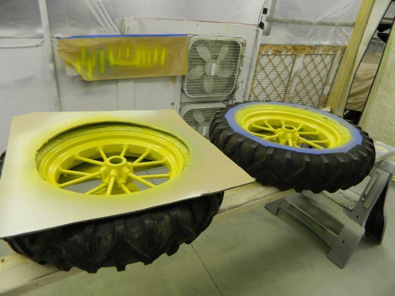

I use my own form of "dustless" blasting. I use a pressure tank blaster and glass media. I hold a water nozzle set to mist in front of the blast nozzle. I spread some cheap tarps on the driveway. I have a fenced concrete apron area in front of my shop. The water seems to drop the spend glass and paint onto the tarp. I wait a few days for the water to evaporate then sweep the tarps. After blasting I blow off the piece with compresses air and apply Eastwood After Blast. I don't know of any method besides blasting to clean some projects. Manure spreader wheel were my last blast project.
