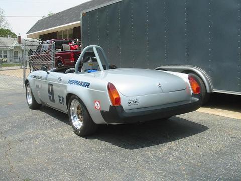

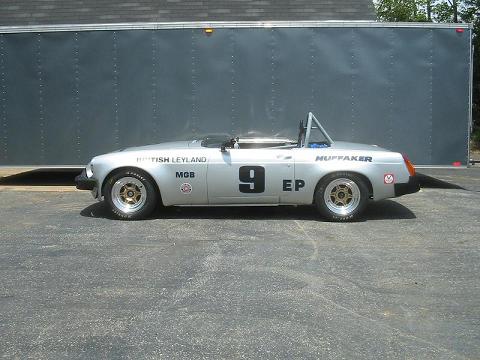

well came out no better than expected at this point. The way I see it, the worst is over. Now Ill ignore it for a week and wet sand/ polish it out. Got some real "funky" looking things going on. I figure at least I can get the car put back together over the winter and if the paint doesn't grow on me by spring than I can redo just the exterior. The interior and eng. look good enough. Here's a few pics. I suppose it really would have looked good if I had stuck with a solid non-metalliac.

actually that was a thought but when I looked closer there seems to be a few really thin spots that have very small pinholes. The metalliac urethane is not rcommended to be wetsanded as it claims this will actually dull the finish. I ordered a clear designed to go atop the single stage. I took the important panels smooth with 320 and scuff the rest of the car. I spent most of the night re-designing my spray booth so I can run heat into it and Im running several oil filled radiators now. I hope to bring the temp up the 78 by tommorow so I cant spray while it cools down. (Ventilation) It seems to be working. One more shot and thats it. I hope. I brought all the fenders hood etc inside the house just to get them out of the way. They dont look to bad even. If it wasn't for a few pinholes I may have left it. Tommorows round two. Wish me luck!
