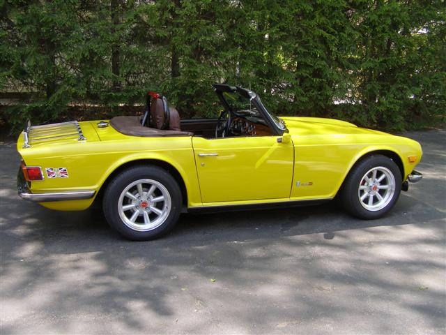

Thinking about changing to some new rims and tires for my 74'-6.
Any suggestions on rim sizes and tires. I would like to go to a 16" rim and a wider-low profile tire combination that will work without modifications. Would a 16x7, 4-114.3 rim work with a 215/65-16 tire? Happy holidays to all!!
Brosky
They would work. I used a 205/60/16" Falken Tire on a Konig Rewind 16/7/4-114.3 wheel.
Great handling and speedo is right on with GPS.
Brosky
Sorry about that. I added the picture, but somehow it came up twice. All gone....
Brosky
I meant no more double clutching the enter button for me.....
