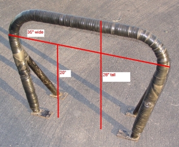

I have a rollbar I removed from my TR250 when I bought it last year. See attached for photo with dimensions.
Sat in my garage and looking for a new home...
Cheers, Jim.

Re: shameless plug ... buy mine
I'm interested I sent you a PM.
