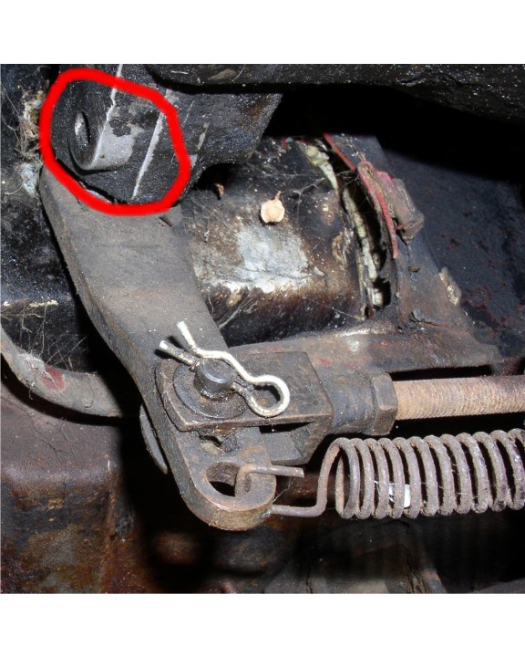

Based on the Bentley book I think I am missing the Clutch Cross Shaft Bearing grease nipple.
This is for a TR4A CT 5xxxxx
I've circled where I think the missing grease nipple is supposed to be.
Do I need to simply replace the nipple and then make sure it is properly greased?

There should be one right in the end of the cross shaft, but I don't think one goes there.

BTW have you gotten an answer to weather or not that hole is supposed to have a fitting? Personally I'm thinking no.
I just looked in both of my factory Triumph manuals. It shows the nipples on both ends of the shaft itsself, but nothing in that hole.
Then I went out to the shop and looked at the TR3 tranny I have half dismantled. The clutch shaft is out and I can look in there.
That hole seems to run all the way through the case intersecting the shaft hole, but the bushing is right there and there are no holes in the bushing that would allow any grease to get to where you'd need it,
so putting that all togeather, I really don't think theres supposed to be one there, just on the shaft ends.

Hi,
Banjo is right.
The hole in your photo is for a retaining bolt, that prevents the clutch cross shaft from backing out of the gearbox. You'll find the same hole on each side of the bellhousing, but *only one* will have a bolt in it to retain the shaft. The other is left empty. Keep in mind that this gearbox casing was used on various car models over the years, besides TRs, so the setup might be different on others, and on LH/RH drive versions for that matter.
Zerks (a nice way to say nipple!) are in the ends of the shaft only, and only on earlier cars (not sure of the change point without looking it up, sometime during 4A production, I think). In your photo it appears you have an adjustable clutch slave cyl. pushrod with the external return spring. If so, I would expect to find the zerks in the ends of the shaft itself, too, unless it was replaced with the greaseless version at some point.
Greasable shafts *can* be fitted to the later cars, along with the longer, bearings in the bellhousing. Personally, I think both mods are a really good idea , a squirt of grease in there once every 12,000 mi., say two pumps on the typical grease gun, will help keep things working smoothly, help shaft and its bushings last a long, long time and the longer bushing provides better support for the shaft.

Thanks folks - let me do some more digging and see what I find. Looks like it is a greaseless version at this point.

BTW -- I notice you have the clutch pushrod mounted to the top hole (of 3). I think the usual set-up for the TRs is the middle hole.

Good catch Geo! You're right!
All TRs use the middle hole in the shaft lever. I would think using that top hole makes the pedal heavier than it needs to be and might risk overextending the TO bearing carrier.
While we're picking on TDSkip /ubbthreads/images/graemlins/wink.gif to me the return spring looks heavier than usual, or is a different spring or perhaps is in backwards, and is not connected in the usual manner. It shouldn't be connected directly to the lever like that. There should be a little tab/washer with a hole for the spring end, that fits under the clevis pin (part #58 at this Moss illustration ).
I mention the spring and it's mounting because, if the clevis pin were relocated to the center hole, it looks to me like the spring might foul or rub against the rest of the mechanism.
One other picky little thing... personally, I'd prefer to see a standard cotter pin used to hold it all together, as was originally done. Those "hair clips" are quick and easy to use when servicing the car, but have a nasty habit of popping off at the worst possible times.
Since you have the greaseless version of the shaft, so long as it has no significant side to side play, I'd suggest living with it until the car needs a clutch replacement. Then, when that's done, if you wish you could upgrade to the greasable shaft ($10 more than the non-grease one) and use the longer, better greasable bearings in the bell housing. A couple pumps of grease in each zerk every 12K miles, the frequency the clevis should be adjusted too, will keep those parts working well and they will probably last as long as you own the car.
One other thing, if you should ever need to replace the clutch and find the original Laycock release plate/cover is in there, it's a very good idea to have it rebuilt rather than buying the new replacments that are available. That will cost more, but I think you will find it far outlasts any clutch fitted with the current replacement Laycock (2nd best choice), B&B (3rd choice, but only if it's the *correct* one, marked with a blue dot, *never* a green dot) or AP (4th choice). Should it ever come up, before replacing a clutch be sure to search here for other important tips on improving the security of the release fork on the shaft, replacing the fork pins, properly installing the throwout bearing and carefully re-aligning the gearbox to the engine. Done right, it will likely be good for 50K-100K miles. Done wrong, too many folks find themselves pulling it apart and rebuilding *again* within just 5K, 10K, 20K miles!
