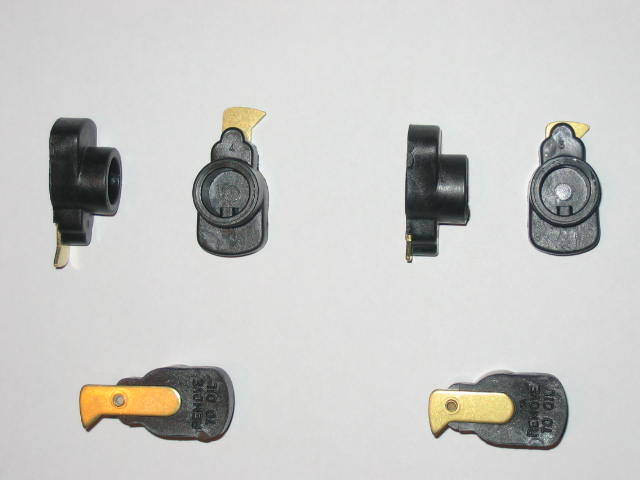

There's a specialist in England who calls himself the Distributor Doctor who wrote all about bad rotors. He even showed a photo. https://www.distributordoctor.com

I'm ever so grateful that I've been a packrat all these years and kept all my old rotors in the rare cases that I ever actually replaced one. Had a buddy with an MGA that I helped "rescue" a couple years ago...by borrowing the (none too current but perfectly serviceable) rotor out of my Herald. Of course, I then needed to put something in the Herald, so I borrowed an ancient rotor out of a long-dormant Standard Pennant I have, cleaned it up a wee bit, and the Herald has run ever since.
I saw the same information Don did (presumably in the TR Register UK "TR Action" magazine). Sounds like there might be a solution, with this "distributor doctor" sourcing or manufacturing some much better rotors. But I suppose it will be some time (and MUCH AGGREVATION) before all the bad ones are taken out of circulation. /bcforum/images/%%GRAEMLIN_URL%%/frown.gif
