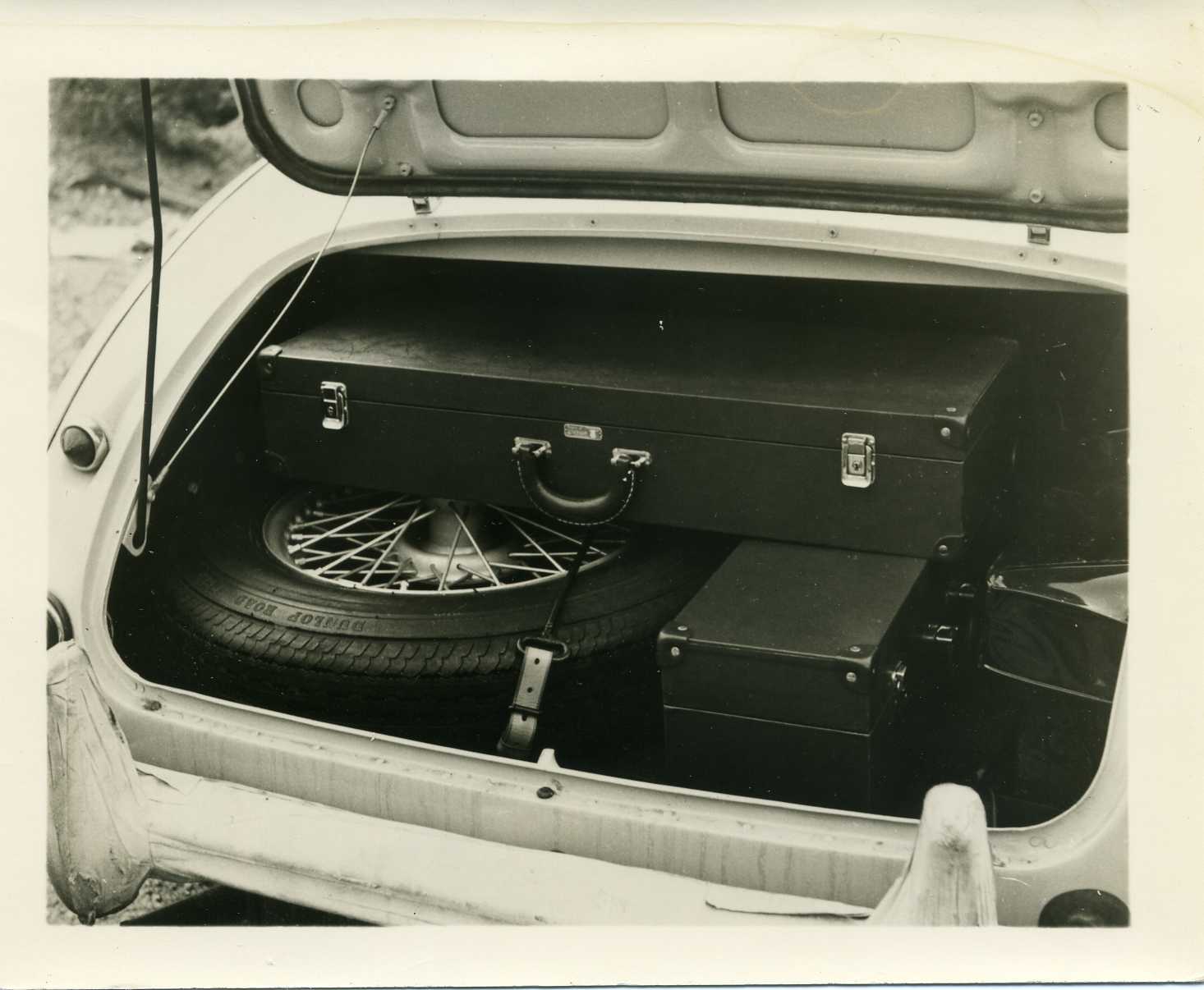

Is that a boy's head in the back seat? If so, that's a BN4 -- now where in the heck does that guy think that suitcase is going?

Steve - Actually in 57 a company, Warren leather Goods Company from Worcester Ma, was making a line of luggage for the Longbridge 100-Six and the MGA
so it is possible
enjoy - jim:driving:
