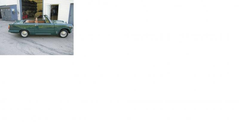

I'll be off today to collect my recently purchased 1969 Triumph Herald 13/60 convertible, 1GH240LCV. Seems ok except for very sticky starter drive. My thought is that this has probably chewed up the ring gear a bit. Question is, does the gear reduction for this car operate on the opposite and hopefully undamaged side of the ring gear, thus perhaps allowing a fix without pulling the transmission?
