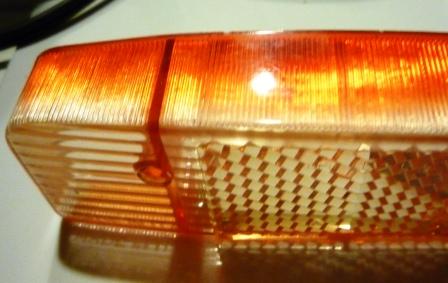

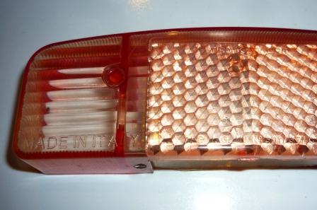

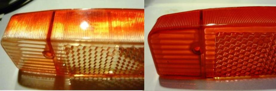

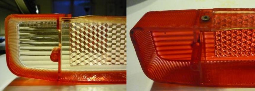

I just finished restoring a 1959 Lambretta scooter. All is good except I'm not happy with the brake light lens. I know this may sound crazy but I'm thinking it was molded clear and then painted with a translucent red color... I could be wrong but just my best guess.
As it stands now, it is mostly clear, which is not good for a brake light. See the photos below.
Is there anything (or product) I can do to make it red again? I've thought of trying RIT which is a dye for fabric, but it says it can be used for coloring plastics. Any other ideas or suggestions?

That is interesting JP... and thanks for your detective work. I also did do a search but came up empty. This afternoon, I special ordered Red Translucent spray paint. After reading the instructions in the link you posted I think my translucent paint may be a better way to go.... Per the instructions on the "cobrafan" pages you paint the outside of the plastic lens then clear coat, then wet sand; seems arduous.
The translucent paint I bought is sprayed onto the inside of the lens. There is no prep other than cleaning before painting and it shouldn't weather since it's on the inside. I should have it on Thursday and will post some "After" shots when I'm done.

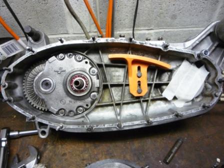

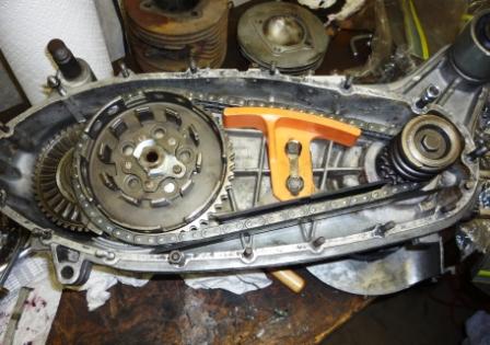

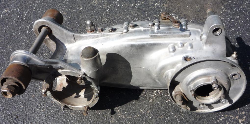

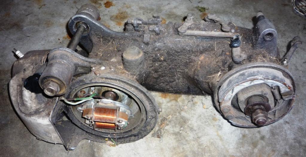

I don't have any digital pics of the scooter during restoration, but I do have some engine pics.
Here you go...

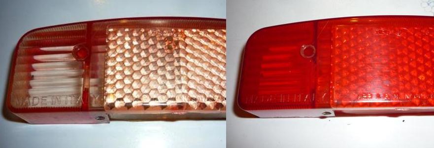

Oh My... take a look at the "Before and After" pics. It's hard to believe that it's the same tail light. I sprayed the INSIDE with translucent red model paint.
The paint is so thin that it took about 5 coats to get to the right shade.
Gliderman8
Gliderman8
That looks great, can you share details about the paint?
Sure, no problem...
Practra RC Car Paint
#RC271 Candy Red
I'm sure there are other model paints that would work just as well; just make sure the paint you use is translucent. Be patient and give it time to dry completely between coats.
