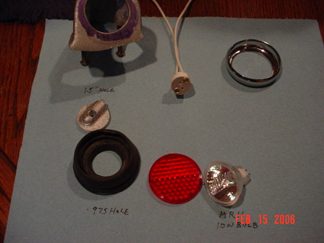

This same modification can be done on the older BN1 - BN2's. Since the reflector pods are a separate part & the aluminum pods are closed on the surface under the reflector, an extra step of cutting a hole in this closed surface with a hole saw is required. Also a hole with grommet through the shroud for the wire.
The later model rubber housing, socket, & trim ring can then be fitted. A little work to cut the rubber to fit & hold the bulb, but it comes out looking the same as original. A high speed grinder (Dremel) works well to shape the rubber.
I used the MR11 10 watt, 30 degree bulbs with matching ceramic pigtail sockets. See attached pic.
