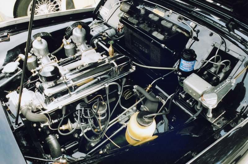

I seem to recall that the original size (huge) was a Group 27. When I first got my TR3A in 1972, it had been in a barn for several years and needed a battery. At that time I was able to get a Group 27 Sears DieHard. So modern with the white case (but still black top) and two rectangular caps instead of six individual round caps for the cells! But in 1972, my '60 was just an old car that I wanted to drive, so original appearance wasn't that great a concern.

As Andy noted, group 27 is what we used to use. It was wiiiide -- really filled the battery box nicely. These days group 24 is the more common I think.
If you're not trying a full-on period look you can at least select one that is all black & peel the labels off of it.
The modern 3-in-one cell caps can be replaced with individual caps (assorted styles on eBay) if you get a bit crafty and trim their threads a little.
If you want a couple of Lucas labels to stick on there, pmail me for the jpegs.

So here's the progress so far. Took an 8x10 piece of cardboard, painted it black, added my own home-made Lucas label, then laminated it. Slid it under the hold-down bracket. Now I have a removable (and re-usable) Lucas "front". Cell caps will be the next step - have to be careful to include proper cell venting.

Over the past 15 years, I'm on my third battery from the Antique Battery Co in Hudson, Ohio. I order mine with the exposed lead links on the tar-top (actually a poly something these days) for an extra $10.00. Phone them because they don't seem to respond to their web site e-mails.
