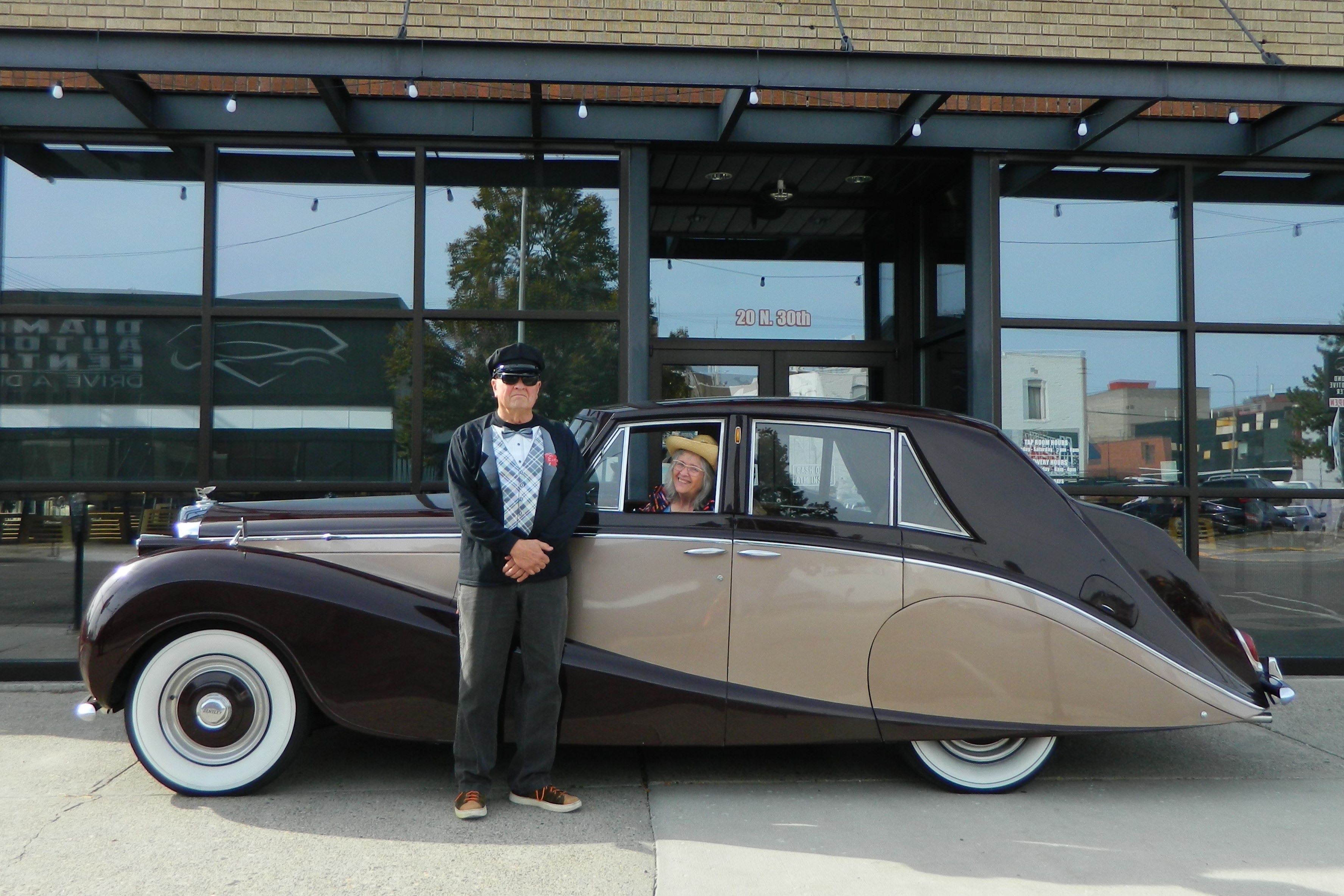

Haven't checked in for awhile, just saw this post. Don't have an S type but this past summer I purchased a 1954 R Type, it has an Empress body by Hooper. The first thing I had to do was get the brake rods set properly so the servo mechanism would activate, not difficult just fiddly. They are different in some ways from a typical 50's car but not impossible. J. Haydon has explained it all very well. I have had a 4 post lift for years which is a great asset. I still drive my TR4 on occasion, but life kinda got in the way of my Lovely and I enjoying the car. Her MS has progressed so getting in and out of the TR was getting increasing difficult and the use of a wheelchair has become necessary when we go anywhere. I bought the Bentley so we could still "arrive" when went out. She can get in and out of it and the electric folding wheelchair fits in the boot. The photo was taken in front of a frequently visited brewery, we usually dress as shown in the picture when using the Bentley. We are having a lot of fun with it. My sons showed up for a visit shortly after I bought it, I think they were checking to see if the old guy was getting soft in the head.

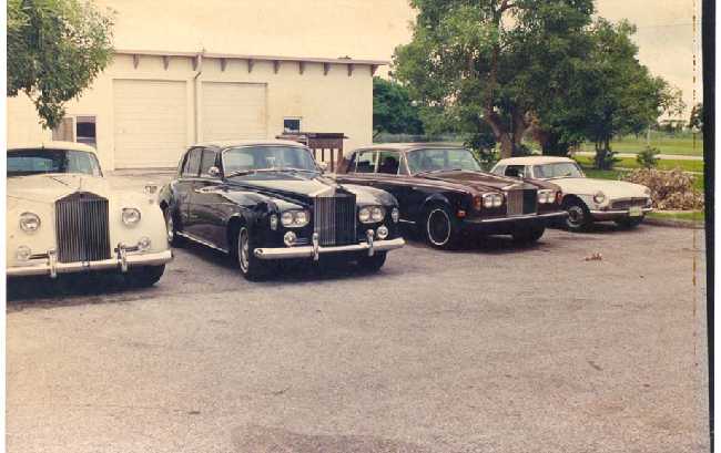

Some of our clients' cars and Herself's MGB, outside our shop.
