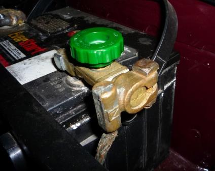

Had a similar incident when I was wireing up my TR6... this is what saved me from a fire. I suggest you get one; makes it easy to disconnect from the batt.
tomgt6
I have the same thing on all my old cars. Makes it easy to do and you don't have to work hard. Found them at Fleet Farm for about $6.

I have never had those battery disconnects in a car. The Ferrari has them as a stock item and I am amazed at how much I have used it. I'll be putting one in on the TR8 this spring for sure.
