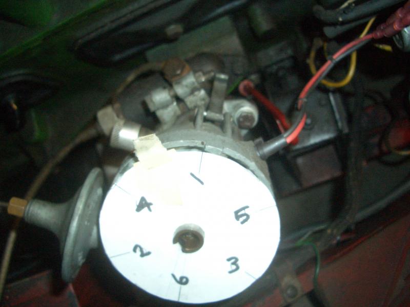

I like to use a paper timing disc divided into 1/6ths. Start with #1 at TDC on the compression stroke (both rockers loose) and plugs out. Set the disc to a mark on the distributor body, such as shown. Then rotate the fan or move the car in gear to go through the cylinders. I used a 30-60 triangle but circle-divided artwork is on Google.

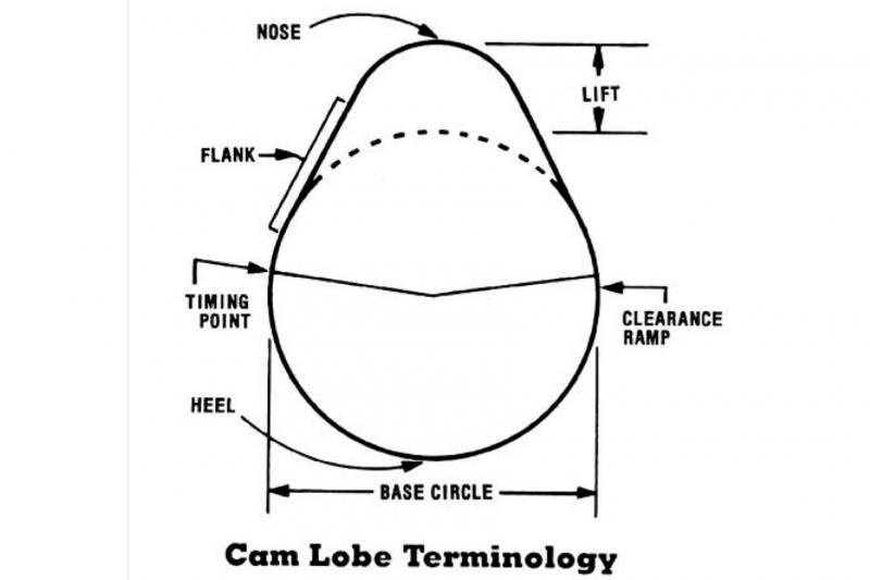

I use a remote starter switch. One thing to keep in mind is that when using the rule of 13, being precise about getting the one valve at it's maximum open position is not that necessary. The goal is to set the valve clearance when the lifter is on the base circle of the lobe. See this drawing:
The lifter is on the base circle for at least half of the lobe rotation.
The only time one needs to have the lifter absolutely on the nose of the lobe is when measuring lift.
