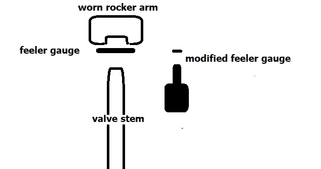

If you have an old rocker shaft and arms, then a feeler gage will not give an accurate gap. It bridges any wear marks on the arm tips, giving a larger actual gap than measured. Use a dial indicator for worn shafts and arms to get true gap.

6TTR3A
I just modified the feeler gauge to compensate for rocker arm wear at the
valve stem contact point.

You can actually buy feeler gauges with narrow tips, for that reason.
Personally, I prefer to have the rockers rebuilt when they get that worn. It's easy to remove the shaft, and there is a service out here that does them. I don't recall the numbers offhand, but the total cost with shipping was very comparable to what I would spend for just the parts to do it. The results came back looking like new, I still don't know if they actually replaced the arms or just gave them a flash coat of copper. But only the pedestals and caps were obviously original.

You would have a hard time getting the flatness (parallel to the shaft) and the roundness (perpendicular) right.
Bob
DavidApp
A file will probable not make any impression on them. The tips are very hard.
A machine shop with a flat grinding wheel would be able to do it.
