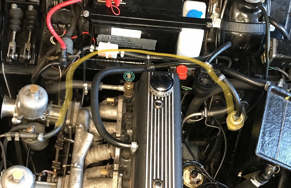

May be consider just running fuel tube round the back of the engine along the square box section in front of the battery.
it’s more direct and cooler.
in my pic it’s via an elec pump on the left but worked just the same with the mechanical pump.(highlighted in yellow) Just need to swap over the carb float bowl lids.
But I realise it’s not a modification for everyone.

Good idea. How is it fastened to the frame there in front of the battery?
