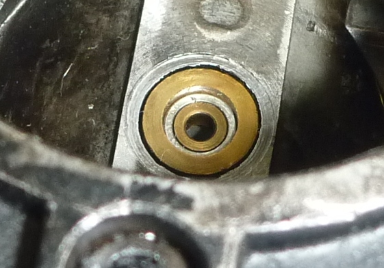

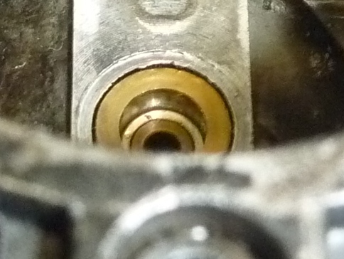

These are from one of my spare HD6s - In the normal position, the jet is down about .08"; in the choke position, about .160".
You should observe this kind of difference when you operate the choke.

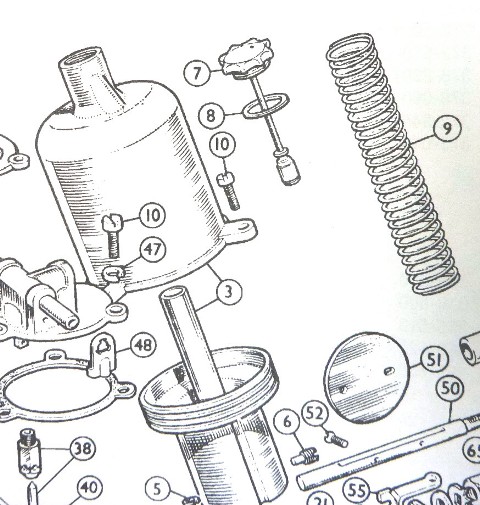

Refer to the Moss Catalog, "Triple HS4 Type Carburetors BN7/BT7" page for item numbers:
Unscrew the screws (10) and remove the suction chambers (3). Remove springs (7). Lift the pistons with their jets* out (3). Be sure to keep each piston with its matched chamber.
Now you'll be able to observe the jets similar to the pictures.

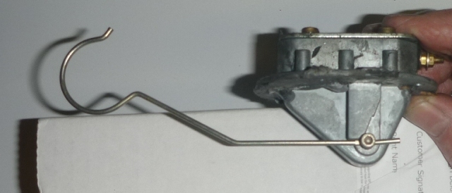

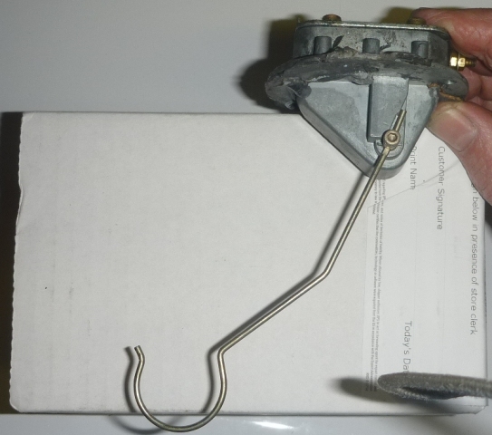

Lift up your boot floor and make sure the tank sender is properly oriented: the gauge wire should be coming off the rear of the sender - not the front.
If coming off the front, that means your sender is incorrectly oriented, which causes the float to hang up and the gauge to stop working at 1/4 tank, allowing you to run out of gas with the gauge still showing 1/4 tank.
With the sender properly oriented, the float drops into the well in the tank bottom. Otherwise it gets hung up higher on the floor of the tank, causing the false 1/4 tank display.
If the above isn't the gauge problem, you'll need to have your sender and gauge calibrated together.

Evidently the BJ8 sender has both the float and electrical connection to the rear; the older models have the float to the front and rear electrical.
The important thing is for the float to drop into the well of the tank you have -- regardless of the orientation of the electrical connection. From these pictures, it can be seen that the well must be slightly to the front of the sender opening. With the float to the rear it would hang on the floor of the tank, showing 1/4 full.
