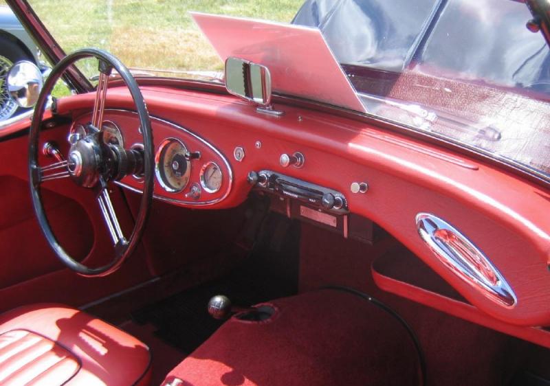

I have a 1960 BT7-- car #2229-- that has the choke located under the dash near the steering column. From looking at the Moss catalog, mine looks like a BN7 setup. The mounting looks factory. However, there is a hole covered with a chrome disk where the choke is located on all of the BT7s that I have seen. I tried to find a cable replacement in the Moss catalog but nothing matched my car number. The choke works just fine but seems to be in the wrong location. I would like to fix the location if current location is not correct. Where can I look for this info. Thanks

According to the "Book" (Original Austin-Healey - Anders Ditler Clausager), the choke controls were under the dash until BT7/2194, Engine 29D/2864 (July 1959) when they installed thermoelectric chokes instead of a manual chokes, until BT7/5310 (November 1959) where the manual choke was re-introduced. The re-introduced manual choke control were then installed on the "Main Facia Panel".

I think you are the most original to leave the choke under that dash, since your chassis number is during the thermoelectric choke phase, and you probably don't want to go down that road. Your choke cable was definitely not installed in the dash as that did not start until much later in the manufacturing sequence. Additionally, not all the engines were necessarily matched with the car bodies in sequence, so the engine/chassis discrepancy may not mean much. The Concours committees have found exceptions to his dates and change points. If you are not a member of one of the national clubs (USA or America) I'd suggest you join, well worth the annual fee in my opinion. (Links below)

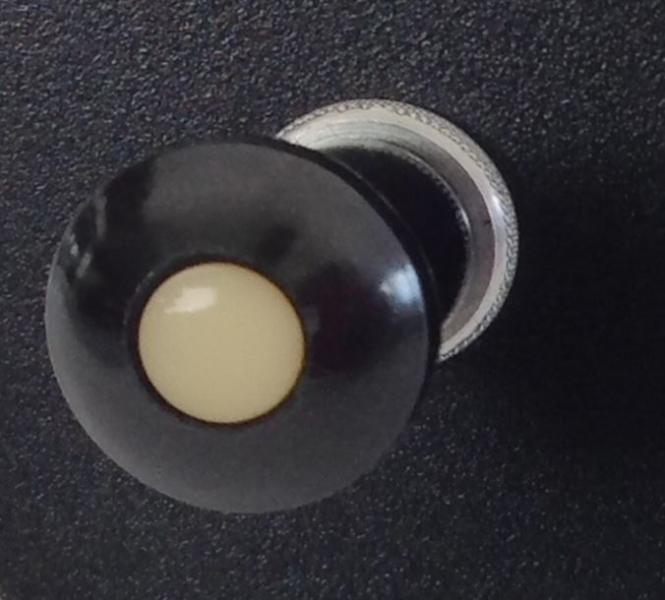

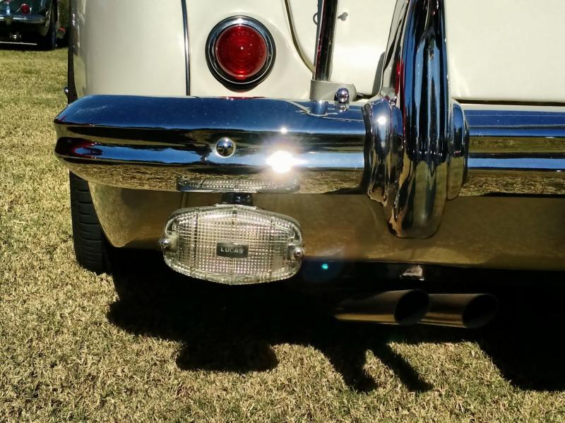

Now on the serious side, how about a factory option Lucas reversing lamp (L494) and Lucas illuminating switch (56SA)? The size of the switch would fit the spot nicely. These were factory options (See list below), and were also installed by dealers.
