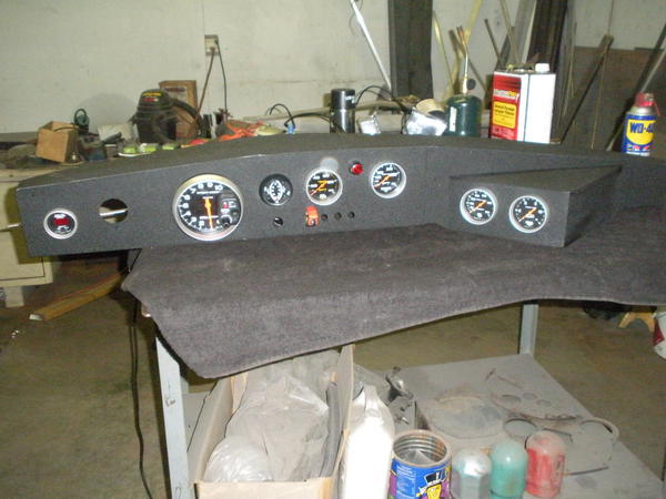

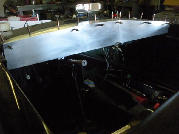

Here's the custom dash I made for the MGB vintage race car, it's all made out of .030" aluminum, that is stress mounted, with the stress mounting and brake work in this, it become quite rigid for such a thin and light material. The hardest part was to make the double compound curve to fit the MGB's cowl, and since I didn't have a shrinker/stretcher, or a English wheel, I used the actual MGB cowl and clecoed the initial piece of it to the MGB cowl, then use my leather hammer to make the compound curving. It all work all pretty well in the end. DSCN2124.JPGdash-1.JPGdash-3.JPG
