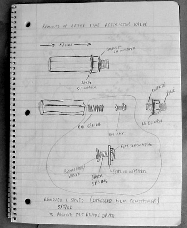

Geo Hahn
What's in there (in case you need to know):
Looks like I gutted it 19 years ago.
