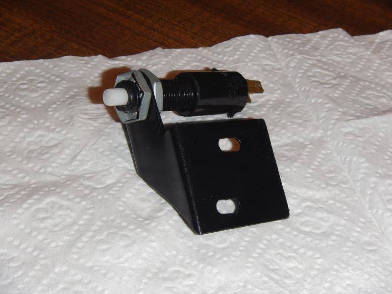

Ordered a switch from Summit Racing Part number PRF-80172 $15.00
Made my bracket and everything is installed.
Hopefully one more problem headed off.
