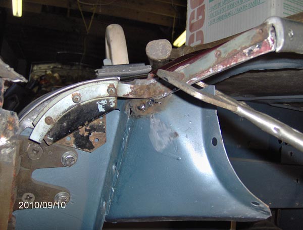

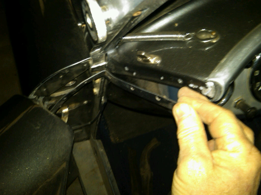

roscoe
I' ve tried to add a photo to my post. Not sure if it has worked. I'll try again if it doesn't. It shows one piece attached to the forward door post/fender, and I'm holding the other piece in place after it has been shaped to fit. The rubber piece gets attached to them both to keep it in place.
