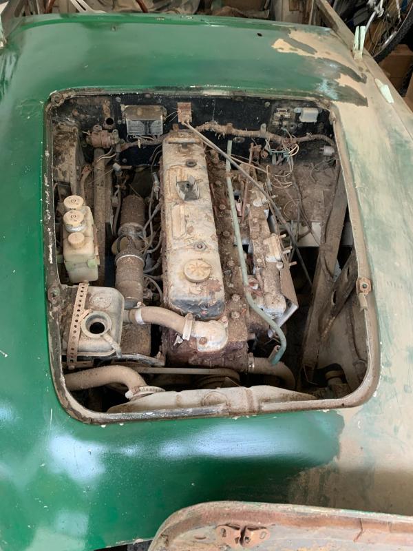

My friend just brought home what looks like an early 100 (BN1/BN2) with the I6, based on the shape of the grill opening. I it has the taller grill of the early 100-4 which is somewhat confusing to me after doing some research. I know there was some prototyping done with the 6 thrown into the early chassis. Sorry about the poor pictures. Will post higher quality stuff sometime tomorrow when I have a chance to take them myself. Any help offered would be much appreciated!

Looks like someone shoehorned a six-cylinder engine into the car.
Thanks! After doing some digging, I figured that was the case. I'm hoping it's one of the higher output six's. I know the I4's are more favorable in this chassis though. Will update this thread with better pics tomorrow.

I was thinking it doesn't look like one of the early six cylinders. Looks much later.
red57
I notice they swapped in the 6 cylinder hanging pedal bulkhead brace on the right side so it may have been a well done swap.

So I see disc brakes in front w/dust shields - discs first seen about March '59, dust shields started about march '60.
Center change gearbox and fiberglass cover started about November '61.
Can't tell for sure but looks like 1 3/4" bore intake. Not a 'thermo-choke' head.
Overall, it makes me think it's a home-brew hot rod rather than a factory test mule but more research is called for. I love these kind of mysteries and will be looking forward to more pictures.
IMO the value is largely dependent on frame & structural integrity although hot rods are usually never as valuable as a correct factory produced car.

Mystified that no one has yet asked what the VIN is. Don't see the VIN plate and there's a "shadow" on the firewall and the two screws holes where it was mounted. (Why would it ever have been removed?) Is there a title? Any record of the VIN? From the green Armacord in the boot I think it's safe to assume that it's a BN1.
Knowing the VIN ("Car No." in BMC parlance) won't solve many mysteries, but it's always a good starting point and we could likely discover if the car was originally RHD or later converted from a left-hooker.
Hi Ried, It depends on the state where it resided when the engine swap was done. I have a BN1 that I bought about 10/12 years ago from Craig Anderson that has a 289 Ford installed in about '68/'69 in the State of Missouri. At that time in Missouri an engine swap meant the equivalent of an 'assembled vehicle' so the State issued a new Missouri vin number on a Missouri ID plate and destroyed the factory vin number plate and any records of the previous factory vin number. So I have a title but it is impossible for me to get a Heritage Cert. to learn anything about the car because I don't know the original BN1 number.
This car may have suffered a similar fate depending on where it was when the swap was done.
