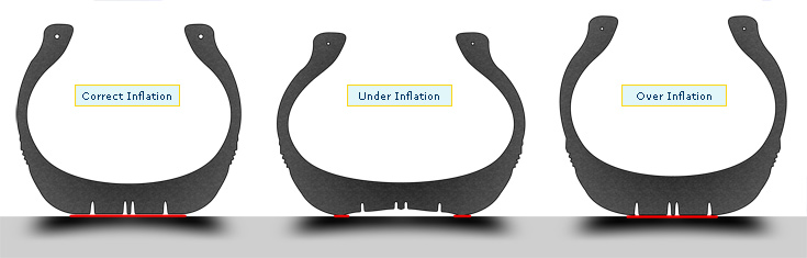

For those who are used to Psi and kilo's ;-)
https://en.wikipedia.org/wiki/Atmosphere_(unit)
or
www.soccerballworld.com that explains it like this;
To convert BAR (KGS) to PSI (Lbs.):
Answer = 14.5037 X The amount of BAR(KGS)
For example: A soccer ball has a recommended pressure of 0.6 BAR labeled on it. To convert BAR in Pounds Per Square Inch (PSI), multiply 0.6 times 14.5037. The answer is 8.7 PSI or Lbs.
To convert PSI (Lbs.) to BAR(KGS):
Answer = .068948 X The amount of PSI(Lbs.)
For example: A soccer ball has a recommended pressure of 7.9 Lbs. (PSI) labeled on it. To convert Pounds Per Square Inch (PSI) into BAR, multiply 7.9 times .068948. The answer is 0.545 BAR.
So 32 Lbs equals about 2.2 Atmosphere
